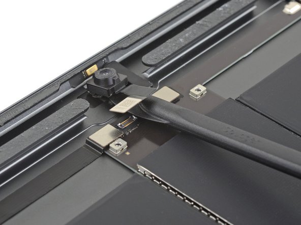

    1. iPad Air 3 Front Camera Replacement, Disconnect the front camera: step 20, image 1 of 2 iPad Air 3 Front Camera Replacement, Disconnect the front camera: step 20, image 2 of 2
      • Use the flat end of a spudger to disconnect the front camera cable by lifting straight up on the press connector.

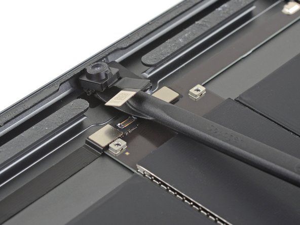

    2. iPad Air 3 Front Camera Replacement, Remove the front camera: step 21, image 1 of 3 iPad Air 3 Front Camera Replacement, Remove the front camera: step 21, image 2 of 3 iPad Air 3 Front Camera Replacement, Remove the front camera: step 21, image 3 of 3
      Tool used on this step:
      Halberd Spudger
      $2.99
      Buy
      • Insert an opening pick or a halberd spudger underneath the front camera to cut the adhesive securing it to the rear case.
      Ask FixBot
