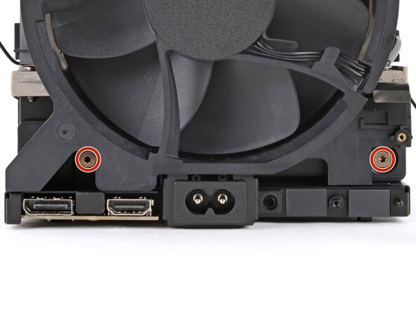

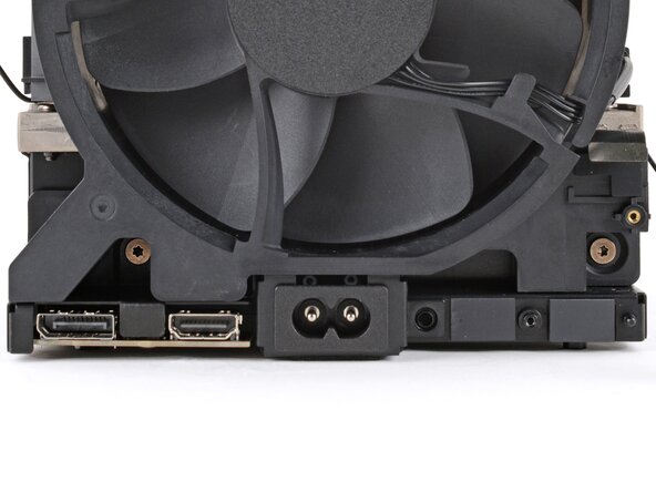

    2. Steam Machine (2026) Heatsink Replacement, Loosen the back panel screws: step 5, image 1 of 2 Steam Machine (2026) Heatsink Replacement, Loosen the back panel screws: step 5, image 2 of 2
      • Use a T8 Torx screwdriver to fully loosen the two captive screws securing the back panel.

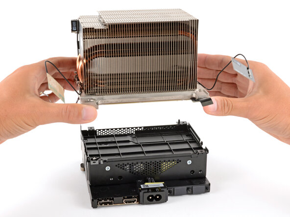

    4. Steam Machine (2026) Heatsink Replacement, Remove the inner assembly screws: step 7, image 1 of 2 Steam Machine (2026) Heatsink Replacement, Remove the inner assembly screws: step 7, image 2 of 2
      • Use a T8 Torx screwdriver to remove the two 7.3 mm‑long screws securing the inner assembly.
      Ask FixBot
    5. Steam Machine (2026) Heatsink Replacement, Remove the inner assembly: step 8, image 1 of 3 Steam Machine (2026) Heatsink Replacement, Remove the inner assembly: step 8, image 2 of 3 Steam Machine (2026) Heatsink Replacement, Remove the inner assembly: step 8, image 3 of 3
      • After removal, don't lay the inner assembly down on the microSD and USB ports. These ports are fragile and shouldn't have the weight of the assembly resting on them.
      • Grip the inner assembly under the fan and lift it straight up and out of the shell.
      • Set the inner assembly down so the SSD is on top.

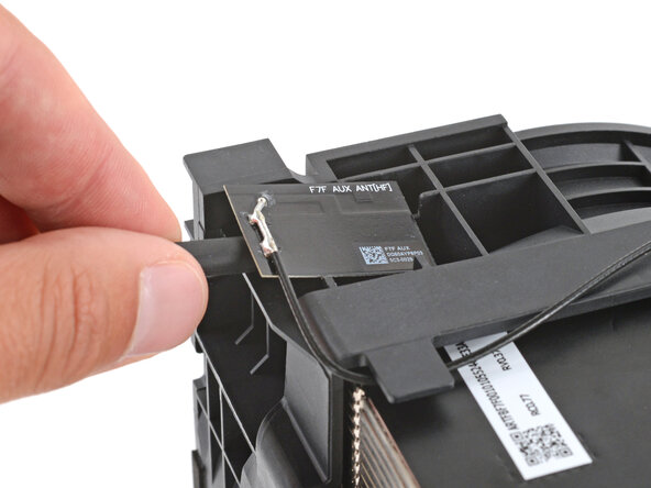

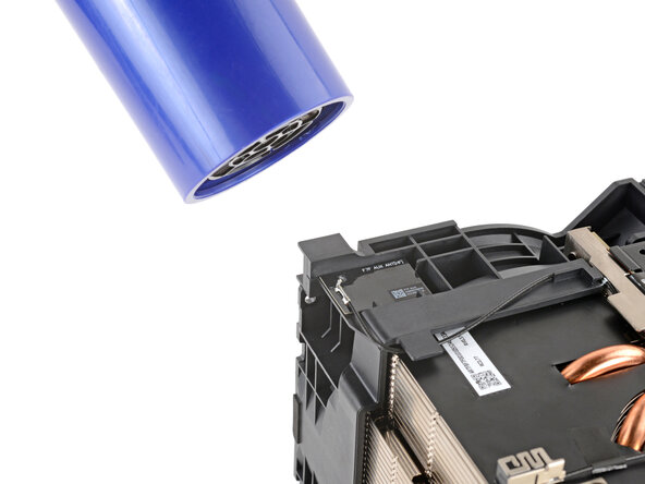

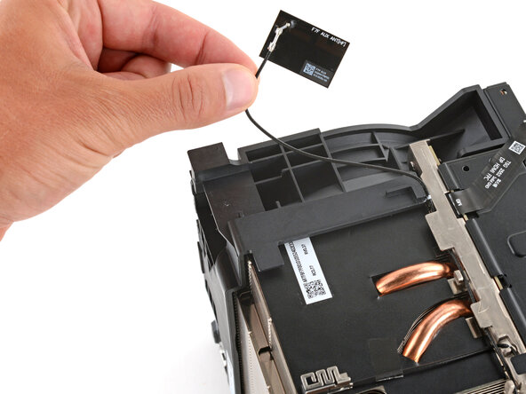

    2. Steam Machine (2026) Heatsink Replacement, Heat the auxiliary antenna: step 16, image 1 of 3 Steam Machine (2026) Heatsink Replacement, Heat the auxiliary antenna: step 16, image 2 of 3 Steam Machine (2026) Heatsink Replacement, Heat the auxiliary antenna: step 16, image 3 of 3
      • Mild adhesive secures the auxiliary antenna to the fan. Heating the antenna softens the adhesive, making it easier to separate. If you don't want to remove the antennas from the fan, you can disconnect and de-route them.
      • Lay a heated iOpener on the auxiliary antenna for two minutes.
      • Check out this guide for instruction on heating an iOpener.
      • Alternatively, you can use a hair dryer to soften the adhesive. For tips on using a hair dryer without accidentally melting plastic, check out this guide.
      Ask FixBot

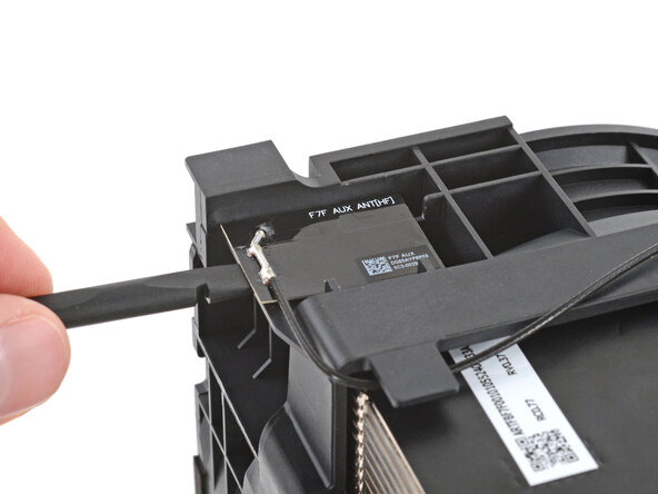

    3. Steam Machine (2026) Heatsink Replacement, Separate the auxiliary antenna: step 17, image 1 of 3 Steam Machine (2026) Heatsink Replacement, Separate the auxiliary antenna: step 17, image 2 of 3 Steam Machine (2026) Heatsink Replacement, Separate the auxiliary antenna: step 17, image 3 of 3
      Tool used on this step:
      Tesa 61395 Tape
      $2.95
      Buy
      • Slide the flat end of a spudger under the antenna and lift to separate the adhesive.
      • During reassembly, the adhesive should be sticky enough to reuse. If it isn't, use thin double-sided tape to secure the antenna.
      Ask FixBot
    4. Steam Machine (2026) Heatsink Replacement, De-route the auxiliary antenna: step 18, image 1 of 3 Steam Machine (2026) Heatsink Replacement, De-route the auxiliary antenna: step 18, image 2 of 3 Steam Machine (2026) Heatsink Replacement, De-route the auxiliary antenna: step 18, image 3 of 3
      • Guide the antenna cable out of its clips on the fan.
      Ask FixBot

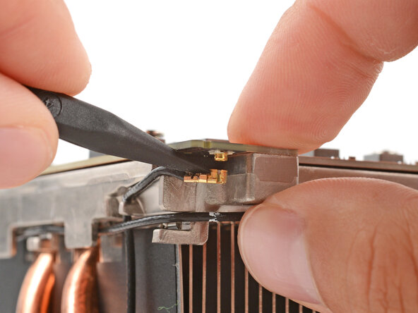

    7. Steam Machine (2026) Heatsink Replacement, Separate the main antenna: step 21, image 1 of 3 Steam Machine (2026) Heatsink Replacement, Separate the main antenna: step 21, image 2 of 3 Steam Machine (2026) Heatsink Replacement, Separate the main antenna: step 21, image 3 of 3
      Tesa 61395 Tape
      $2.95
      Buy
      Ask FixBot

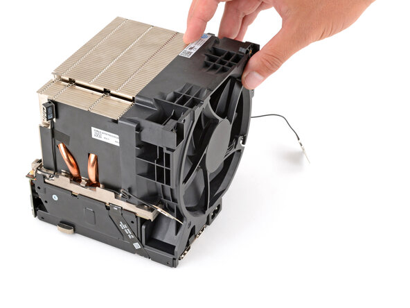

    11. Steam Machine (2026) Heatsink Replacement, Reposition the inner assembly: step 25, image 1 of 1
      • Reposition the inner assembly so the fan is facing you and the power cable socket is on the bottom.
      Ask FixBot
    12. Steam Machine (2026) Heatsink Replacement, Remove the fan screws: step 26, image 1 of 2 Steam Machine (2026) Heatsink Replacement, Remove the fan screws: step 26, image 2 of 2
      • Use a T8 Torx screwdriver to remove the two 7.3 mm‑long screws securing the fan.
      Ask FixBot
    13. Steam Machine (2026) Heatsink Replacement, Remove the fan: step 27, image 1 of 2 Steam Machine (2026) Heatsink Replacement, Remove the fan: step 27, image 2 of 2
      • Slide the fan straight away from the inner assembly to remove it.
      • During reassembly, make sure no cables get stuck behind the fan when sliding it back in place.
      Ask FixBot

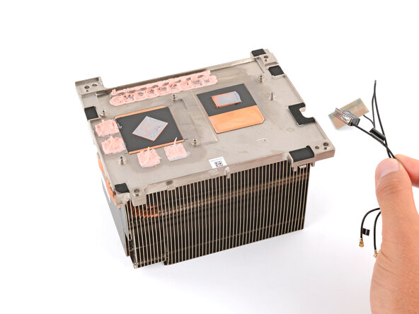

    1. Steam Machine (2026) Heatsink Replacement, Reposition the inner assembly: step 28, image 1 of 1
      • Reposition the inner assembly so the microSD reader and two USB ports are facing up at the top edge farthest from you.
      Ask FixBot
    2. Steam Machine (2026) Heatsink Replacement, Remove the cable cover screws: step 29, image 1 of 2 Steam Machine (2026) Heatsink Replacement, Remove the cable cover screws: step 29, image 2 of 2
      • Use a T8 Torx screwdriver to remove the two 5.1 mm‑long screws securing the front port cable cover.
      Ask FixBot
    3. Steam Machine (2026) Heatsink Replacement, Remove the cable cover: step 30, image 1 of 2 Steam Machine (2026) Heatsink Replacement, Remove the cable cover: step 30, image 2 of 2
      • Remove the cable cover.
      Ask FixBot
    4. Steam Machine (2026) Heatsink Replacement, Disconnect the front port board: step 31, image 1 of 2 Steam Machine (2026) Heatsink Replacement, Disconnect the front port board: step 31, image 2 of 2
      • Use the flat end of a spudger to pry up and disconnect the board's press connector.
      Ask FixBot

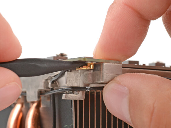

    5. Steam Machine (2026) Heatsink Replacement: step 32, image 1 of 3 Steam Machine (2026) Heatsink Replacement: step 32, image 2 of 3 Steam Machine (2026) Heatsink Replacement: step 32, image 3 of 3
      • Use the point of a spudger to lift and disconnect the three coaxial connectors, making sure to lift as close to the connector head as possible.
      Ask FixBot

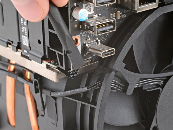

    11. Steam Machine (2026) Heatsink Replacement, Remove the SSD screw: step 38, image 1 of 2 Steam Machine (2026) Heatsink Replacement, Remove the SSD screw: step 38, image 2 of 2
      • Use a T8 Torx screwdriver to remove the 5.1 mm‑long screw securing the SSD.
      • With the screw removed, the SSD will pop up at a shallow angle.
      Ask FixBot
    12. Steam Machine (2026) Heatsink Replacement, Remove the SSD: step 39, image 1 of 2 Steam Machine (2026) Heatsink Replacement, Remove the SSD: step 39, image 2 of 2
      • Don't pull up on the SSD at a sharp angle, or you may damage the SSD and its socket.
      • Pull the SSD out of its socket at the angle it popped up at to remove it.
      Ask FixBot

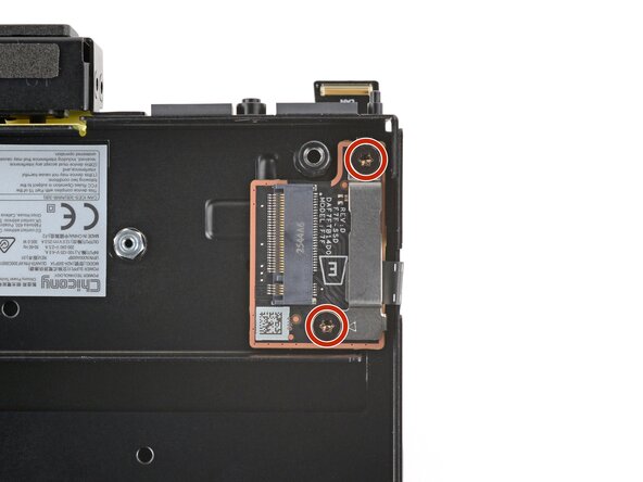

    13. Steam Machine (2026) Heatsink Replacement, Remove the SSD board screws: step 40, image 1 of 2 Steam Machine (2026) Heatsink Replacement, Remove the SSD board screws: step 40, image 2 of 2
      • Use a T8 Torx screwdriver to remove the two 5.1 mm‑long screws securing the SSD board and its cover.
      • With the screws removed, the board is only attached by its ribbon cable.
      Ask FixBot

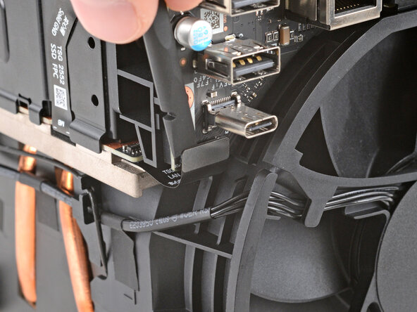

    15. Steam Machine (2026) Heatsink Replacement, Disconnect the SSD board: step 42, image 1 of 2 Steam Machine (2026) Heatsink Replacement, Disconnect the SSD board: step 42, image 2 of 2
      • With one hand, hold the board down by the SSD socket.
      • With your free hand, use the flat end of a spudger to pry up and disconnect the board's press connector.
      Ask FixBot

      • Use your fingers to gently peel the SSD board cable off the metal frame.
      • If you're having trouble, you can use an iOpener or hair dryer to heat the cable.
      Ask FixBot

    19. Steam Machine (2026) Heatsink Replacement, Remove the power supply screws: step 46, image 1 of 2 Steam Machine (2026) Heatsink Replacement, Remove the power supply screws: step 46, image 2 of 2
      • Use a T8 Torx screwdriver to remove the four 12.8 mm‑long screws securing the power supply.
      Ask FixBot

    21. Steam Machine (2026) Heatsink Replacement, Remove the motherboard and heatsink: step 48, image 1 of 3 Steam Machine (2026) Heatsink Replacement, Remove the motherboard and heatsink: step 48, image 2 of 3 Steam Machine (2026) Heatsink Replacement, Remove the motherboard and heatsink: step 48, image 3 of 3
      • Remove the motherboard and heatsink from the power supply and set it down so the motherboard is facing up.
      Ask FixBot

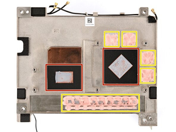

    6. Steam Machine (2026) Heatsink Replacement, Thermal material information: step 54, image 1 of 2 Steam Machine (2026) Heatsink Replacement, Thermal material information: step 54, image 2 of 2
      • Whenever the motherboard is separated from the heatsink, it's best practice to remove and reapply all thermal paste and putty. This ensures even coverage of thermal material. Otherwise, your console may get damaged from overheating or won't perform as expected.
      • Use a spudger to carefully remove as much thermal paste and putty as you can from both the motherboard and heatsink. It will be located on the CPU, GPU, VRAM, and power delivery.
      • Be very careful not to scrape up or damage any of the fragile surface‑mounted components on the motherboard.
      • Use high‑concentration (>90%) isopropyl alcohol and a cotton swab (or coffee filter) to remove all remaining thermal material and its residue from both the motherboard and heatsink.
      • Take your time with this step and make sure all surfaces are thoroughly clean.
      • Apply a small bead of thermal paste to the center of the CPU and GPU dies.
      • Apply thermal putty to the VRAM chips and the line of power stages.

    1. Steam Machine (2026) Heatsink Replacement, Separate the antennas: step 55, image 1 of 3 Steam Machine (2026) Heatsink Replacement, Separate the antennas: step 55, image 2 of 3 Steam Machine (2026) Heatsink Replacement, Separate the antennas: step 55, image 3 of 3
      Tesa 61395 Tape
      $2.95
      Buy
      • Mild adhesive secures the antennas to the side of the heatsink.
      • Slide the flat end of a spudger under the two antennas and pry them away from the heatsink assembly to separate them.
      • If you're having trouble, apply some heat with an iOpener or hair dryer and try again.
      • During reassembly, if the original adhesive is sticky enough, you can reuse it. Otherwise, use thin double-sided tape to secure the antennas.
      Ask FixBot
    2. Steam Machine (2026) Heatsink Replacement, Remove the cables: step 56, image 1 of 3 Steam Machine (2026) Heatsink Replacement, Remove the cables: step 56, image 2 of 3 Steam Machine (2026) Heatsink Replacement, Remove the cables: step 56, image 3 of 3
      • If helpful, take photos of how these cables are routed before removing them.
      • Remove all remaining cables from the heatsink assembly.
      • Some of the cables may be secured with tape.
      Ask FixBot
    3. Steam Machine (2026) Heatsink Replacement, Only the heatsink remains: step 57, image 1 of 1
      • You're left with just the heatsink.
      Ask FixBot
