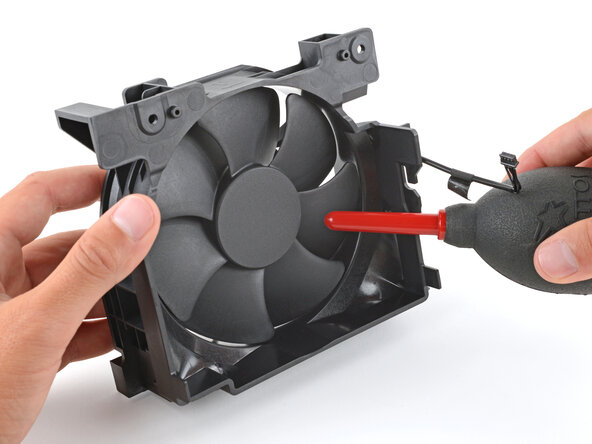

    3. How to Open and Clean a Steam Machine (2026), Clean the fan: step 36, image 1 of 2 How to Open and Clean a Steam Machine (2026), Clean the fan: step 36, image 2 of 2
      • Over time, dust will build up inside the fan and on the fan blades.
      • Use a pair of tweezers or your fingers to grab loose hairs and dust clumps off of the fan.
      • Use a dust blower or light compressed air to blow remaining dust off of the fan.
      • Use a finger to keep the fan blades steady—it makes them easier to clean.
      • If there's a layer of grime on the fan blades, use soapy water on a damp rag or an isopropyl alcohol wipe to clean it off.
