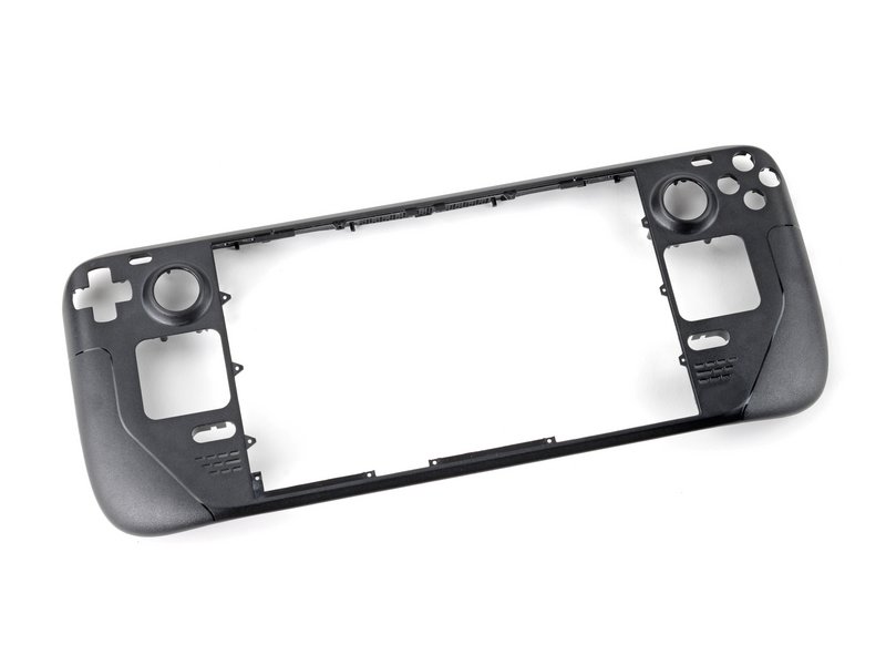

Use this guide to remove or replace the front shell (front cover) on a Steam Deck LCD.
Remember: follow general electrostatic discharge (ESD) safety procedures while repairing your device.
This procedure involves almost a complete disassembly, including removing the display! Know what you're getting yourself into. You'll need replacement adhesives for the display and speakers.

      • Remove the mic cable from the front shell.
      • Only the front shell remains.
