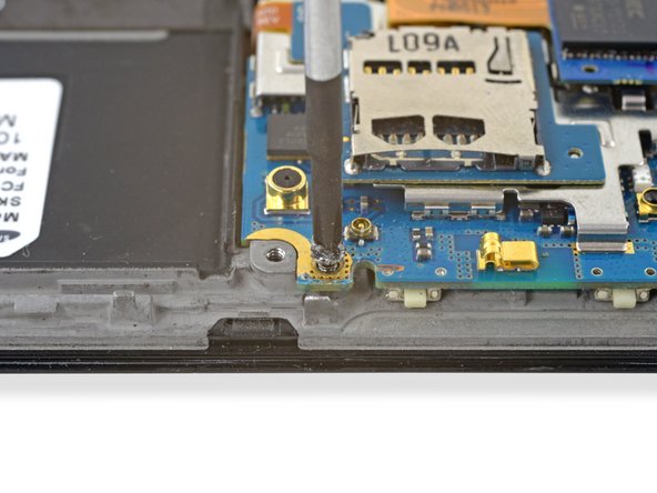

      • Your screw is stripped, and your screwdriver is no longer sufficient. Before busting out the heavy hitters, try the following:
      • Use different screwdrivers. First try slightly smaller or larger head sizes, then a flat head screwdriver, to see if you can get it to catch on some part of the stripped screw.
      • If the bit doesn't catch the screw instantly, do not continue. Otherwise, you run the risk of further stripping the screw.
      • If either of these techniques are fruitful, congrats! Your screw is free.

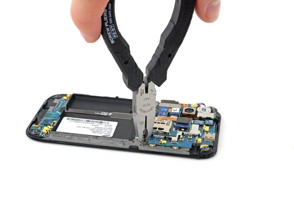

      • If the screw head is accessible, try a pair of screw extracting pliers. If you can get a good grip, turn the pliers and the screw should turn along with it!
      • Once the screw is loosened a bit, you can probably back it out the rest of the way using a screwdriver.
