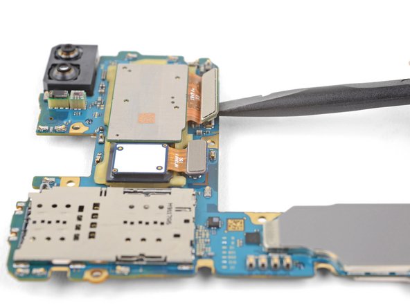

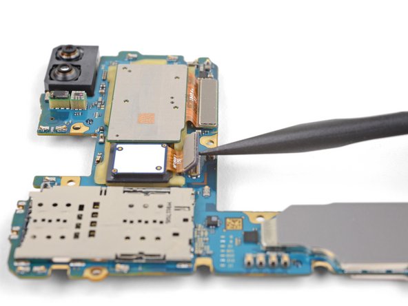

    1. Samsung Galaxy S10+ Rear-Facing Camera Module Replacement, Rear-Facing Camera Module: step 23, image 1 of 3 Samsung Galaxy S10+ Rear-Facing Camera Module Replacement, Rear-Facing Camera Module: step 23, image 2 of 3 Samsung Galaxy S10+ Rear-Facing Camera Module Replacement, Rear-Facing Camera Module: step 23, image 3 of 3
      • Flip the motherboard over.
      • Use the flat end of a spudger to pry up and disconnect the two camera connectors from their sockets on the motherboard.
      Ask FixBot

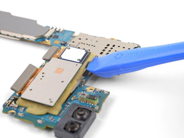

    4. Samsung Galaxy S10+ Rear-Facing Camera Module Replacement: step 26, image 1 of 2 Samsung Galaxy S10+ Rear-Facing Camera Module Replacement: step 26, image 2 of 2
      • Insert the edge of an opening tool under the loosened corner of the camera module.
      • Pry up to release the camera module from the motherboard.
      • Continue prying around the camera module with the opening tool until the module is freed from the motherboard.
      Ask FixBot
