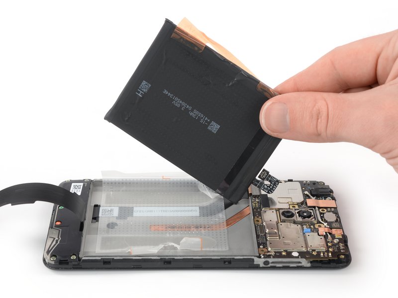

    3. Pocophone F1 Battery Replacement, Pull the battery up: step 16, image 1 of 2 Pocophone F1 Battery Replacement, Pull the battery up: step 16, image 2 of 2
      • Grab both ends of the orange sticker.
      • Pull both ends of the orange sticker straight up to lift the battery out of its recess.
      • If you're having a hard time removing the battery, the adhesive might be a little bit too sticky. You can place a heated iOpener on the screen or use a heat gun to soften the adhesive beneath the battery. Apply the iOpener for at least two minutes.
      Ask FixBot
    4. Pocophone F1 Battery Replacement, Remove the battery: step 17, image 1 of 1
      • Peel the remaining adhesive off the battery.
      • Remove the battery.
      • Do not reuse the battery after it has been removed, as doing so is a potential safety hazard. Replace it with a new battery.
      • You can reuse the old adhesive tape if it's still sticky. However if you want to replace your screen you need to remove it and replace it with new custom cut adhesive tape.
