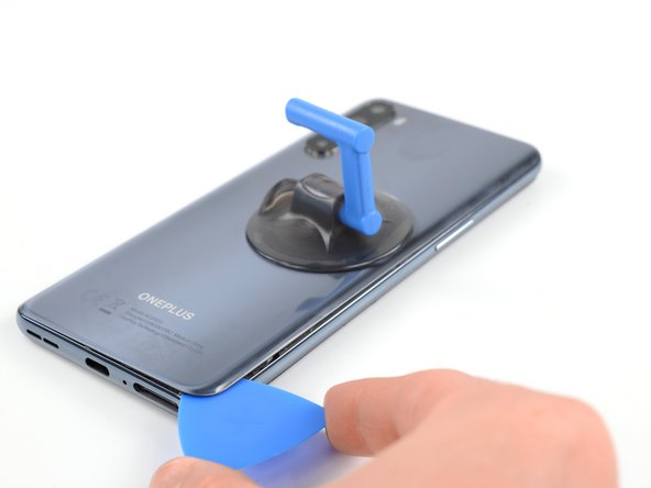

    2. OnePlus Nord Battery Replacement, Create a gap: step 2, image 1 of 2 OnePlus Nord Battery Replacement, Create a gap: step 2, image 2 of 2
      • Apply a suction cup to the back of the phone, as close as possible to the center of the right edge.
      • Pull on the suction cup to create a gap between the rear glass and the frame.
      • Insert an opening pick into the gap.
      Ask FixBot

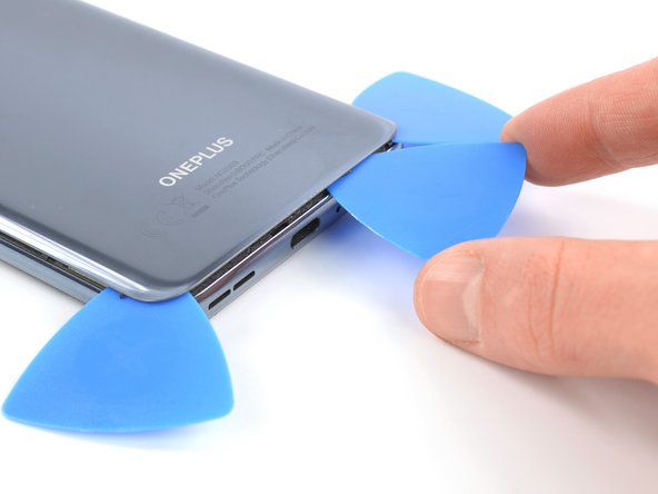

    6. OnePlus Nord Battery Replacement: step 6, image 1 of 3 OnePlus Nord Battery Replacement: step 6, image 2 of 3 OnePlus Nord Battery Replacement: step 6, image 3 of 3
      • Insert a fourth opening pick under the top left corner.
      • Slide the opening pick along the edge to the bottom left corner to cut the adhesive.
      • Leave the opening pick in its place to prevent the adhesive from resealing.
      Ask FixBot

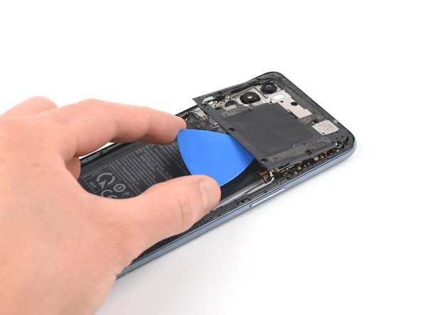

    2. OnePlus Nord Battery Replacement: step 10, image 1 of 3 OnePlus Nord Battery Replacement: step 10, image 2 of 3 OnePlus Nord Battery Replacement: step 10, image 3 of 3
      • Insert the tip of an opening pick under the motherboard cover.
      • Use the opening pick to lift the motherboard cover up and release the plastic clips that holds the cover in its place.
      • Remove the motherboard cover.

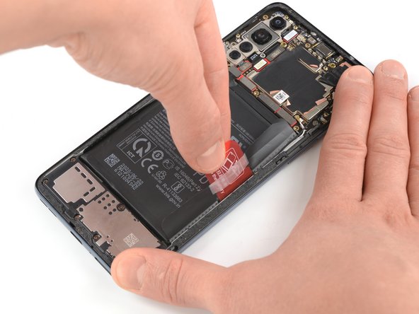

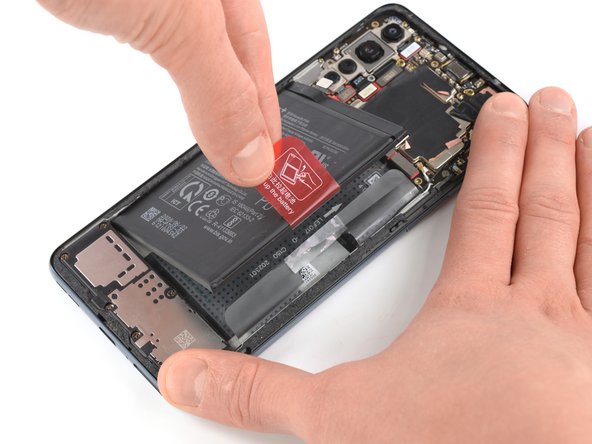

    1. OnePlus Nord Battery Replacement, Remove the battery: step 12, image 1 of 3 OnePlus Nord Battery Replacement, Remove the battery: step 12, image 2 of 3 OnePlus Nord Battery Replacement, Remove the battery: step 12, image 3 of 3
      • Peel back the red pull tab and the black sticker from the edge of the battery.
      • Pull the tab up steadily to break up the adhesive holding the battery in place.
      • If the adhesive is too strong, place a heated iOpener on the screen for two minutes or use a heat gun to soften the adhesive beneath the battery.
