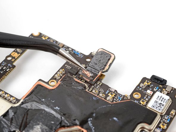

  33. Motorola Edge (2022) Motherboard Replacement, Peel back the camera tape: step 33, image 1 of 2 Motorola Edge (2022) Motherboard Replacement, Peel back the camera tape: step 33, image 2 of 2
    Tool used on this step:
    Buy
    • Use tweezers to peel back the tape connecting the camera to the motherboard.

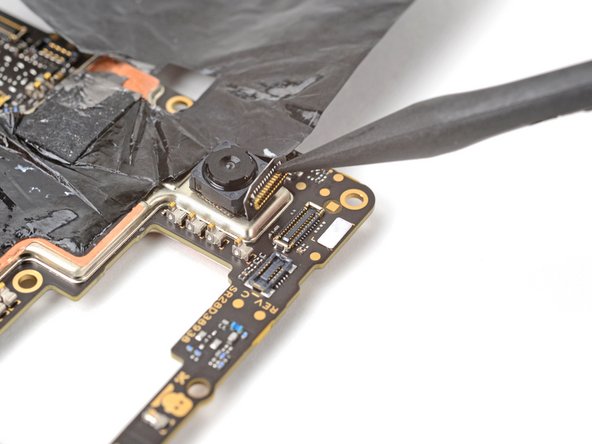

  34. Motorola Edge (2022) Motherboard Replacement, Remove the front camera: step 34, image 1 of 2 Motorola Edge (2022) Motherboard Replacement, Remove the front camera: step 34, image 2 of 2
    • Use the pointed end of a spudger to pry up and disconnect the front camera's press connector.
    • There's no adhesive securing the front camera to the motherboard. Be careful disconnecting the press connector, as it may eject the camera.

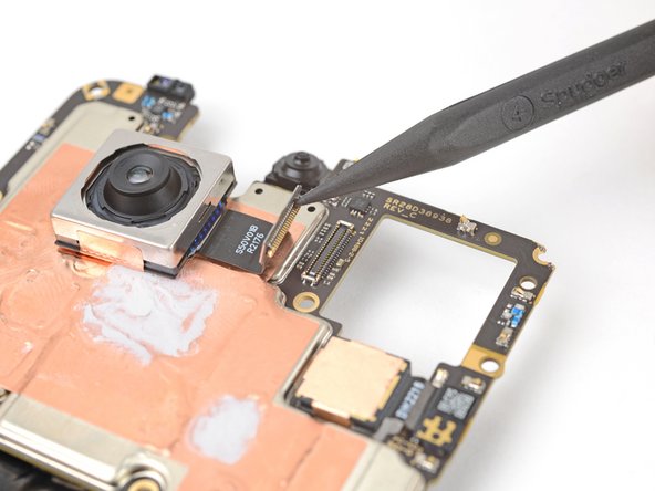

  35. Motorola Edge (2022) Motherboard Replacement, Remove the depth camera: step 35, image 1 of 2 Motorola Edge (2022) Motherboard Replacement, Remove the depth camera: step 35, image 2 of 2
    • Use the pointed end of a spudger to pry up and disconnect the depth camera's press connector.
    • There's no adhesive securing the depth camera to the motherboard. Be careful disconnecting the press connector, as it may eject the camera.
    • Remove the camera.

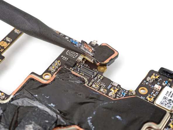

  36. Motorola Edge (2022) Motherboard Replacement, Remove the main camera: step 36, image 1 of 2 Motorola Edge (2022) Motherboard Replacement, Remove the main camera: step 36, image 2 of 2
    • Flip the motherboard over to access the main and ultra wide cameras.
    • Use the pointed end of a spudger to pry up and disconnect the main camera's press connector.
    • There's no adhesive securing the main camera to the motherboard. Be careful disconnecting the press connector, as it may eject the camera.
