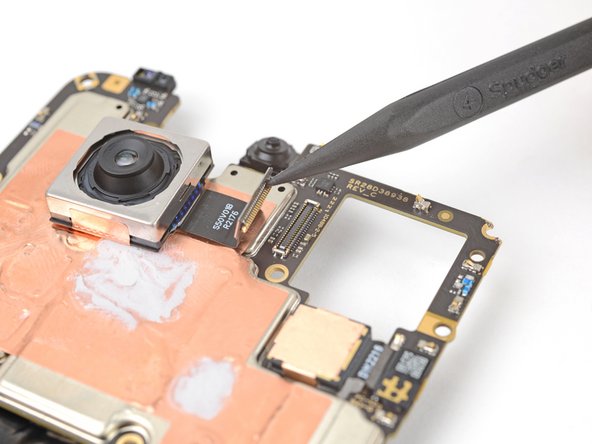

    1. Motorola Edge (2022) Main Camera Replacement, Remove the main camera: step 33, image 1 of 2 Motorola Edge (2022) Main Camera Replacement, Remove the main camera: step 33, image 2 of 2
      • Flip the motherboard over to access the main camera.
      • Use the pointed end of a spudger to pry up and disconnect the main camera's press connector.
      • There's no adhesive securing the main camera to the motherboard. Be careful disconnecting the press connector, as it may eject the camera.
      • Remove the main camera.
      Ask FixBot
