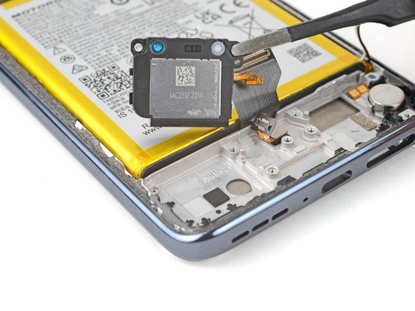

  38. Motorola Edge (2022) Loudspeaker Replacement, Unfasten the loudspeaker: step 38, image 1 of 2 Motorola Edge (2022) Loudspeaker Replacement, Unfasten the loudspeaker: step 38, image 2 of 2
    • Use a Phillips screwdriver to remove the 4.1 mm screw securing the loudspeaker.
  39. Motorola Edge (2022) Loudspeaker Replacement, Apply isopropyl alcohol: step 39, image 1 of 1
    • Apply a few drops of high-concentration (90% or higher) isopropyl alcohol under the loudspeaker's contact pad to loosen the adhesive securing it.
  40. Motorola Edge (2022) Loudspeaker Replacement, Remove the loudspeaker: step 40, image 1 of 2 Motorola Edge (2022) Loudspeaker Replacement, Remove the loudspeaker: step 40, image 2 of 2
    Tool used on this step:
    Buy
    • Use your fingers or tweezers to remove the loudspeaker.
    • The loudspeaker's flex cable is very fragile. Work slowly to prevent tearing the cable.
    • If you have a new adhesive piece for the cable, apply it now.
    • If there's any alcohol remaining, use a lint-free cloth to wipe it up or allow the alcohol to dry off before installing a new loudspeaker.
Compare your new replacement part to the original part—be sure to transfer remaining components and remove adhesive backings from the new part before installing.
