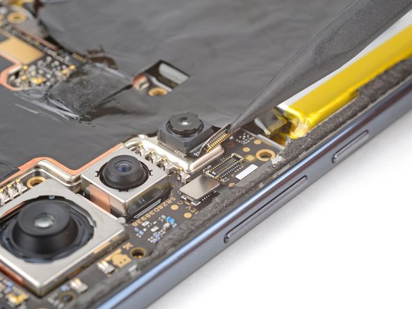

    1. Motorola Edge (2022) Depth Camera Replacement, Remove the depth camera: step 25, image 1 of 3 Motorola Edge (2022) Depth Camera Replacement, Remove the depth camera: step 25, image 2 of 3 Motorola Edge (2022) Depth Camera Replacement, Remove the depth camera: step 25, image 3 of 3
      • Use the pointed end of a spudger to pry up and disconnect the depth camera's press connector.
      • There's no adhesive securing the depth camera to the motherboard. Be careful disconnecting the press connector, as it may eject the camera.
      • Remove the camera.
      Ask FixBot
