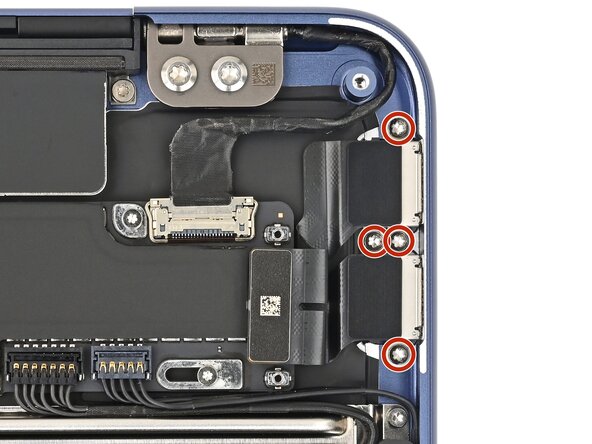

    4. MacBook Neo USB Ports Replacement, Remove the USB ports: step 11, image 1 of 1
      • Use a Torx Plus 5IP driver to remove the four 2.8 mm‑long screws securing the USB ports.

    5. MacBook Neo USB Ports Replacement, Reassembly information: step 12, image 1 of 3 MacBook Neo USB Ports Replacement, Reassembly information: step 12, image 2 of 3 MacBook Neo USB Ports Replacement, Reassembly information: step 12, image 3 of 3
      • During reassembly:
      • Use a Torx Plus 5IP driver to partially install the four 2.8 mm‑long screws securing them.
      • Plug both ends of a USB‑C to USB‑C cable into the ports. If either port feels stiff, shift the port and reconnect the cable until it feels smooth.
      • Fully tighten the screws securing the USB ports, and disconnect the cable from both.
      • Skip the step above this one.
      Ask FixBot
    6. MacBook Neo USB Ports Replacement: step 13, image 1 of 2 MacBook Neo USB Ports Replacement: step 13, image 2 of 2
      • Lift the USB ports by their cable and remove them.
      Ask FixBot
