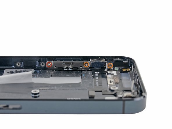

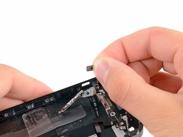

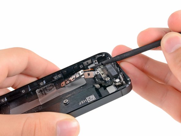

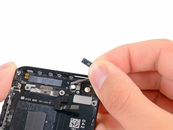

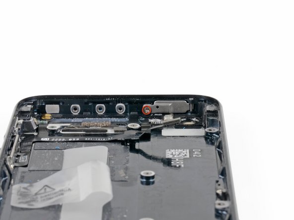

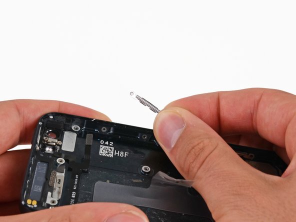

  30. iPhone 5 Rear Case Replacement: step 30, image 1 of 3 iPhone 5 Rear Case Replacement: step 30, image 2 of 3 iPhone 5 Rear Case Replacement: step 30, image 3 of 3
    • Rotate the logic board assembly toward the battery side of the rear case.
    • Do not attempt to completely remove the logic board assembly from the rear case, yet; there is still one cable connected to the underside of the logic board.
    • The flash surround is adhered to the flash unit and the rear case. If it stays on the rear case remove with tweezers and mount it back on the flash unit.
    • Note: when reassembling your device, be sure that the lower interconnect cable is not tucked underneath the logic board.

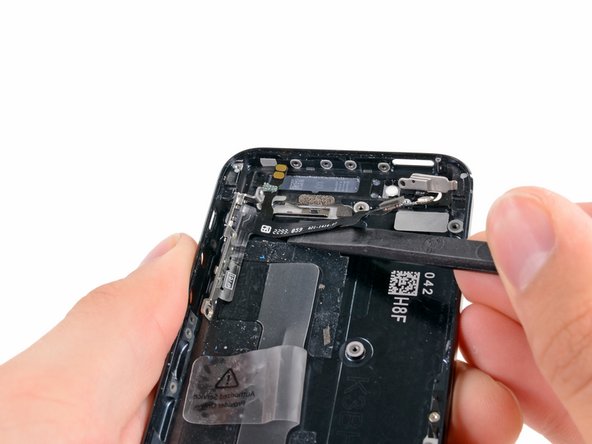

  38. iPhone 5 Rear Case Replacement, Front Panel Clips: step 38, image 1 of 2 iPhone 5 Rear Case Replacement, Front Panel Clips: step 38, image 2 of 2
    • Remove eight 1.3 mm Phillips screws securing the front panel clips to the interior sides of the rear case.
  39. iPhone 5 Rear Case Replacement: step 39, image 1 of 1
    • Remove the four front panel clips from the rear case.

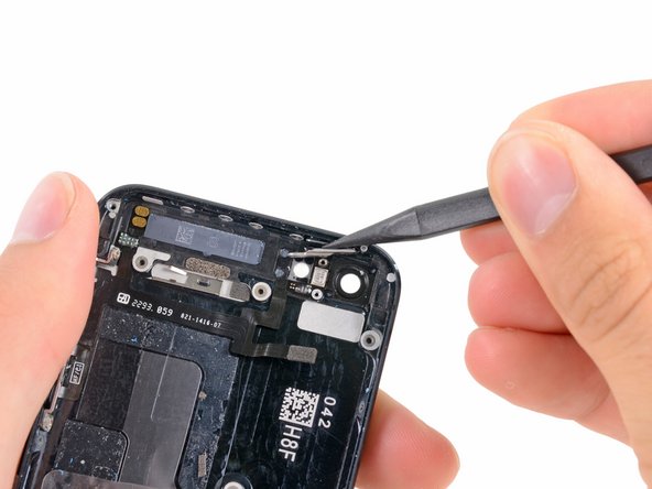

  40. iPhone 5 Rear Case Replacement, Rear Case: step 40, image 1 of 2 iPhone 5 Rear Case Replacement, Rear Case: step 40, image 2 of 2
    • Remove the following screws from the metal power switch bracket between the rear facing flash and camera windows:
    • Single 2.9 mm standoff screw
    • Standoff screws are best removed using an [linked product missing or disabled: IF145-343] and driver handle.
    • In a pinch, a small flathead screwdriver will do the job—but use extra caution to ensure it doesn't slip and damage surrounding components.
    • Single 1.6 mm Phillips screw
    • Remove the metal power switch bracket.

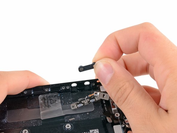

  41. iPhone 5 Rear Case Replacement: step 41, image 1 of 2 iPhone 5 Rear Case Replacement: step 41, image 2 of 2
    • Remove the single 1.9 mm Phillips screw securing the power button bracket to the inside top of the rear case.
    • Use the tip of a spudger to rotate the power button cover down on its hinge.
  42. iPhone 5 Rear Case Replacement: step 42, image 1 of 1
    • Remove the power button from behind its cover in the rear case.
  43. iPhone 5 Rear Case Replacement: step 43, image 1 of 1
    • Use the tip of a spudger to press the power button cover in and lift it off of its hinge in the rear case.
  44. iPhone 5 Rear Case Replacement: step 44, image 1 of 1
    • Remove the following screws securing the volume and silence buttons to the side of the rear case:
    • One 1.3 mm Phillips screw
    • Two 1.8 mm Phillips screws

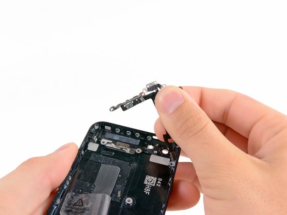

  45. iPhone 5 Rear Case Replacement: step 45, image 1 of 3 iPhone 5 Rear Case Replacement: step 45, image 2 of 3 iPhone 5 Rear Case Replacement: step 45, image 3 of 3
    • Pry the button cable away from the side of the rear case to expose the silence and volume buttons.
    • Remove the silence and volume buttons from the rear case.
  46. iPhone 5 Rear Case Replacement: step 46, image 1 of 2 iPhone 5 Rear Case Replacement: step 46, image 2 of 2
    • Use the flat end of a spudger to pry the button cable up from the rear case.
    • Remove the button cable from the rear case.

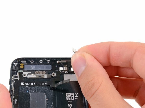

  47. iPhone 5 Rear Case Replacement: step 47, image 1 of 2 iPhone 5 Rear Case Replacement: step 47, image 2 of 2
    • Remove the single 2.0 mm Phillips screw securing the SIM card eject lever to the rear case.
    • Remove the SIM card eject lever.

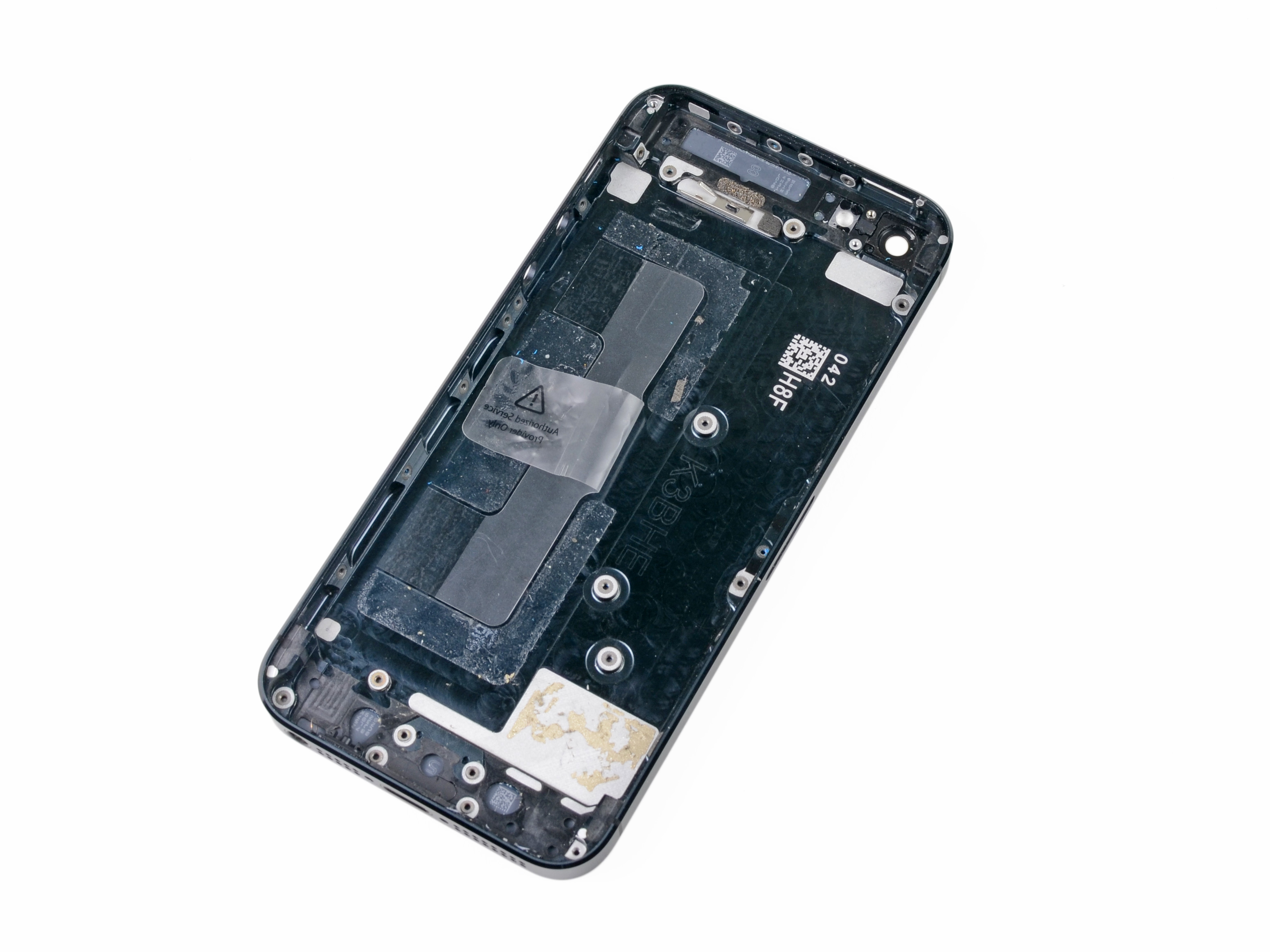

  48. iPhone 5 Rear Case Replacement: step 48, image 1 of 1
    • The bare rear case remains.
