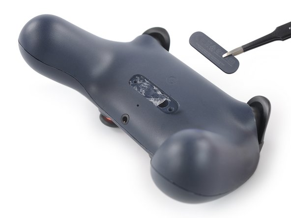

    1. Google Stadia Controller Battery Replacement, Loosen the screw cover adhesive: step 1, image 1 of 1
      • Apply a heated iOpener to the rear side of the Stadia controller where the screw cover is located to loosen the adhesive underneath. Apply the iOpener for at least two minutes.
      Ask FixBot

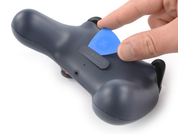

    2. Google Stadia Controller Battery Replacement, Insert an opening pick: step 2, image 1 of 2 Google Stadia Controller Battery Replacement, Insert an opening pick: step 2, image 2 of 2
      • Insert the tip of an opening pick into the gap between the plastic screw cover and the rear case of the controller.
      Ask FixBot
    3. Google Stadia Controller Battery Replacement, Remove the screw cover: step 3, image 1 of 3 Google Stadia Controller Battery Replacement, Remove the screw cover: step 3, image 2 of 3 Google Stadia Controller Battery Replacement, Remove the screw cover: step 3, image 3 of 3
      Tool used on this step:
      Buy
      • Slide the opening pick along the screw cover to slice the adhesive.
      • Use a pair of tweezers or your fingers to remove the screw cover.
      • You might want to replace the screw cover adhesive during reassembly. Apply a bit of high-concentration isopropyl alcohol (>90%) to a Q-tip or use a cleaning pad to gently remove the leftover adhesive on the rear cover of the controller before installing new adhesive.
      Ask FixBot

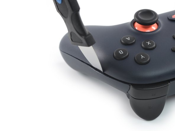

    6. Google Stadia Controller Battery Replacement, Pry open the stadia controller: step 6, image 1 of 3 Google Stadia Controller Battery Replacement, Pry open the stadia controller: step 6, image 2 of 3 Google Stadia Controller Battery Replacement, Pry open the stadia controller: step 6, image 3 of 3
      • Insert a Jimmy into the gap between the front and back cover assembly at the inside of the left controller handle.
      • To make sure you insert the Jimmy at the correct position where the clamps are located, you can use this photo.
      • Tilt the Jimmy upwards and push it into the gap between the covers at the same time to pry open the plastic clamp. You should hear a clack noise once the clamp pops open.
      • Once the clamp is completely open, the gap between the two controller covers should be about 2-3 mm wide.
      Ask FixBot

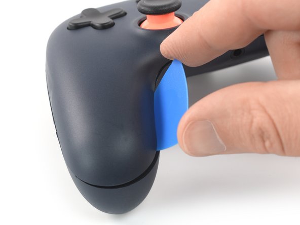

    7. Google Stadia Controller Battery Replacement, Insert an opening pick: step 7, image 1 of 2 Google Stadia Controller Battery Replacement, Insert an opening pick: step 7, image 2 of 2
      • Insert an opening pick in a steep angle into the gap you created to prevent the first clamp from popping back into its closed position.
      Ask FixBot

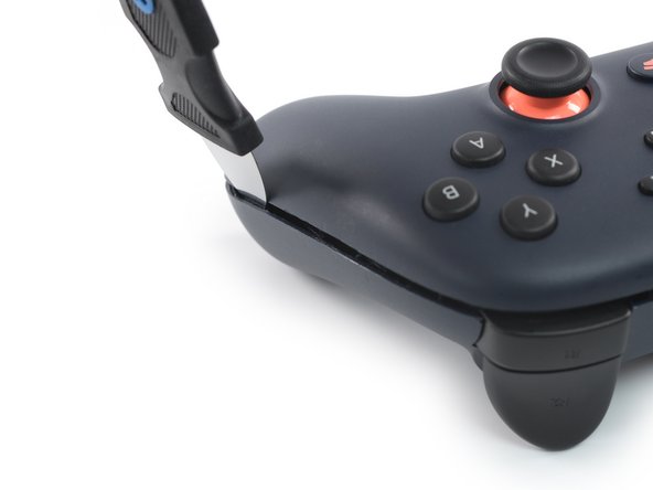

    8. Google Stadia Controller Battery Replacement, Pry open the Stadia controller: step 8, image 1 of 3 Google Stadia Controller Battery Replacement, Pry open the Stadia controller: step 8, image 2 of 3 Google Stadia Controller Battery Replacement, Pry open the Stadia controller: step 8, image 3 of 3
      • Insert a Jimmy into the gap between the front and back cover assembly at the outside of the left bottom end of the controller handle.
      • Repeat the previous opening procedure to open the three plastic clamps at the outside of the left controller handle.
      Ask FixBot

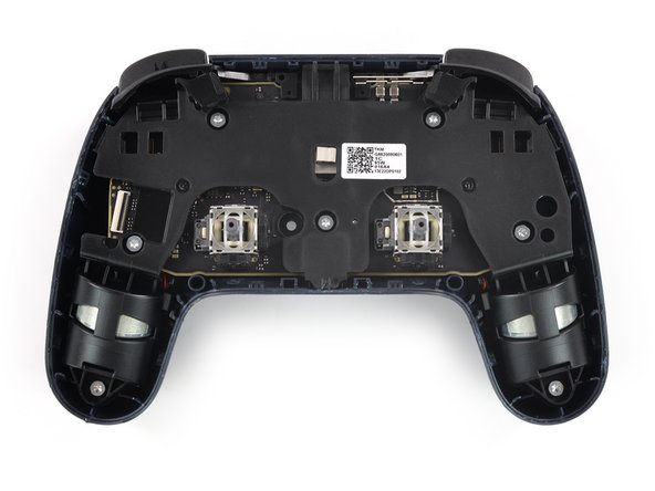

    1. Google Stadia Controller Battery Replacement, Unfasten the screws: step 17, image 1 of 1
      • Use a Torx T8 screwdriver to remove the seven 9.6 mm-long screws securing the motherboard assembly.
      Ask FixBot
    2. Google Stadia Controller Battery Replacement, Pry up the motherboard assembly: step 18, image 1 of 2 Google Stadia Controller Battery Replacement, Pry up the motherboard assembly: step 18, image 2 of 2
      • The motherboard assembly is held in place at four points in the controller's rear cover.
      • Make sure to use the long and not the curved edge of the Jimmy during the following prying procedure.
      • Insert a Jimmy next to the right shoulder button and black plastic clamp of the motherboard assembly.
      • Align the long edge of the Jimmy with the corner of the black plastic clamp.
      • Pry up the motherboard assembly by tilting the Jimmy downwards to open the plastic clamp.

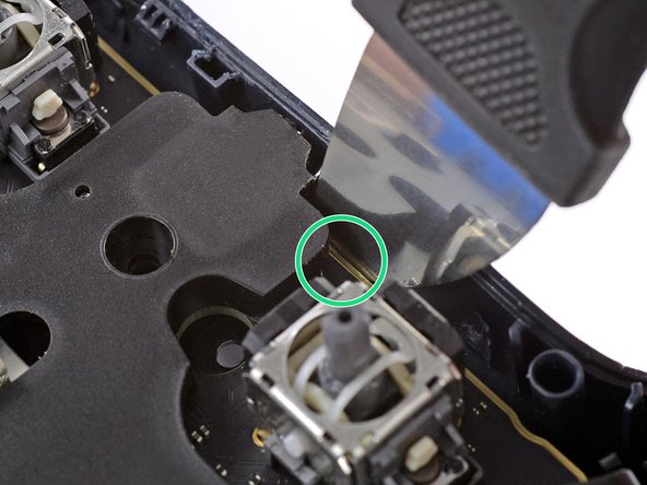

    4. Google Stadia Controller Battery Replacement: step 20, image 1 of 3 Google Stadia Controller Battery Replacement: step 20, image 2 of 3 Google Stadia Controller Battery Replacement: step 20, image 3 of 3
      • Insert a Jimmy at the top edge of the Google Stadia controller just above the charging port.
      • Pry up the top edge of the motherboard assembly by tilting the Jimmy downwards.
      • The charging port is clamped into an opening in the rear cover of the stadia controller. Make sure the charging port is not stuck in its recess during the prying procedure.
      • During reassembly make sure the charging port snaps back into its recess.
      Ask FixBot

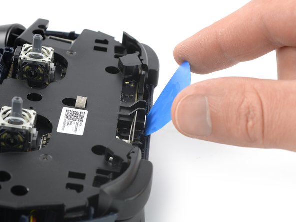

    5. Google Stadia Controller Battery Replacement, Insert an opening pick: step 21, image 1 of 2 Google Stadia Controller Battery Replacement, Insert an opening pick: step 21, image 2 of 2
      • Insert an opening pick at the top edge of the Stadia controller to prevent the charging port from snapping back into place.
      Ask FixBot

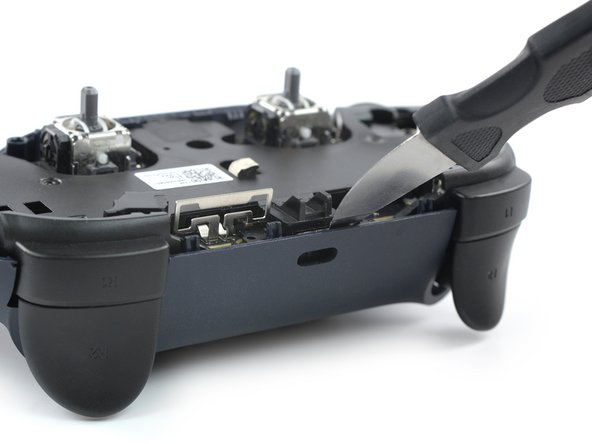

    6. Google Stadia Controller Battery Replacement, Warning: step 22, image 1 of 2 Google Stadia Controller Battery Replacement, Warning: step 22, image 2 of 2
      • In the following step you'll free the headphone jack from its recess in the controller housing:
      • Avoid prying onto the black plastic cover during the following procedure.
      • Pry at the edge of the motherboard instead.
      Ask FixBot

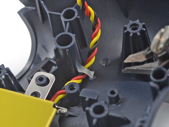

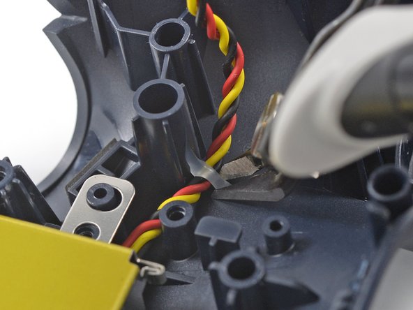

    2. Google Stadia Controller Battery Replacement, Cut the battery cable adhesive: step 28, image 1 of 3 Google Stadia Controller Battery Replacement, Cut the battery cable adhesive: step 28, image 2 of 3 Google Stadia Controller Battery Replacement, Cut the battery cable adhesive: step 28, image 3 of 3
      • Use a flush cutter to carefully cut the adhesive holding the battery cable in place.
      Ask FixBot

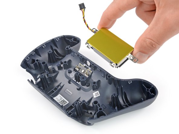

    3. Google Stadia Controller Battery Replacement, Remove the battery: step 29, image 1 of 2 Google Stadia Controller Battery Replacement, Remove the battery: step 29, image 2 of 2
      • Remove the battery.
      • Make sure to align the battery and the back cover of the controller correctly during reassembly.
      Ask FixBot
