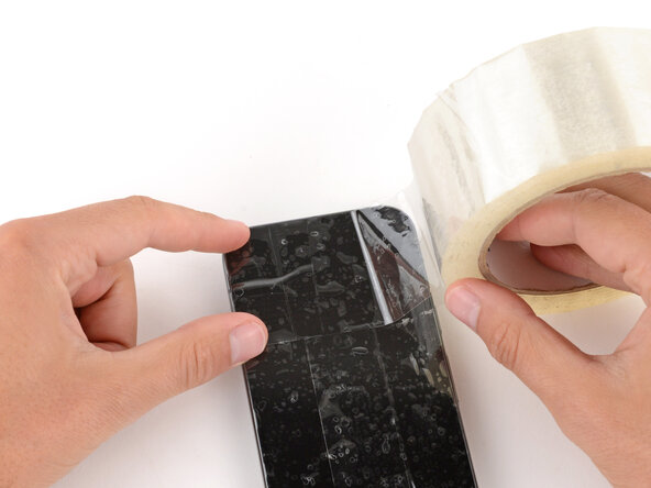

    1. Google Pixel 10 Screen Replacement, Cracked glass preparation: step 2, image 1 of 3 Google Pixel 10 Screen Replacement, Cracked glass preparation: step 2, image 2 of 3 Google Pixel 10 Screen Replacement, Cracked glass preparation: step 2, image 3 of 3
      • Glass shards can complicate disassembly—or worse, cause injury. If your phone has a cracked screen, follow this step.
      • Apply strips of packing tape to the cracked glass until the whole screen is covered—this will help keep the glass contained and allow the suction cup to stick to the screen.
      • Make sure there's a single strip (not overlapping) of tape across the top edge, big enough for a suction cup to fit on.
      • Only cover the glass itself—don't stick any tape to the frame.
      • Consider wearing safety glasses to protect your eyes from any glass shaken free during the repair.
