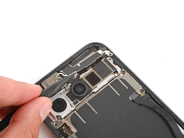

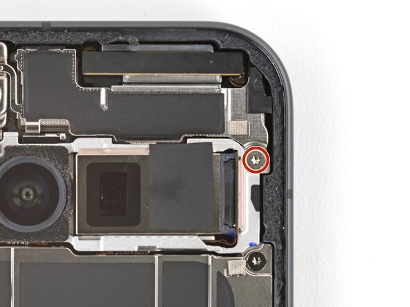

    1. Google Pixel 10 Front Camera Replacement, Remove the bracket screw: step 16, image 1 of 2 Google Pixel 10 Front Camera Replacement, Remove the bracket screw: step 16, image 2 of 2
      • Use a Torx Plus 3IP screwdriver to remove the 5.0 mm‑long screw securing the front camera bracket.
      Ask FixBot

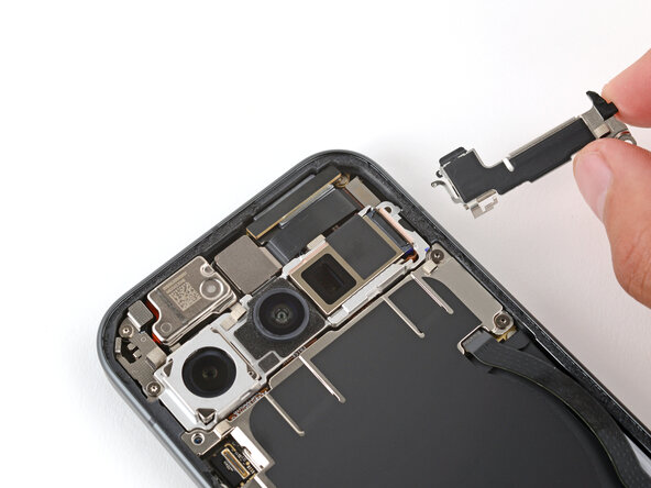

    2. Google Pixel 10 Front Camera Replacement, Remove the bracket: step 17, image 1 of 3 Google Pixel 10 Front Camera Replacement, Remove the bracket: step 17, image 2 of 3 Google Pixel 10 Front Camera Replacement, Remove the bracket: step 17, image 3 of 3
      • Use the point of a spudger to push the front camera bracket's clip in and up to release it.
      • Remove the bracket.
      Ask FixBot

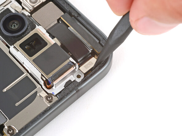

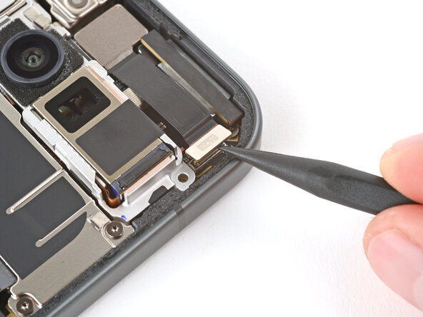

    3. Google Pixel 10 Front Camera Replacement, Disconnect the front camera: step 18, image 1 of 2 Google Pixel 10 Front Camera Replacement, Disconnect the front camera: step 18, image 2 of 2
      • Use the point of a spudger to pry up and disconnect the front camera press connector.
      Ask FixBot

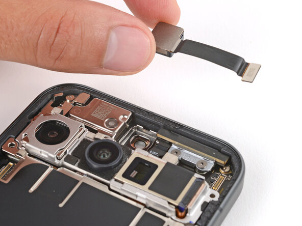

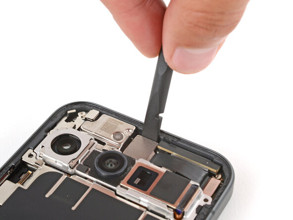

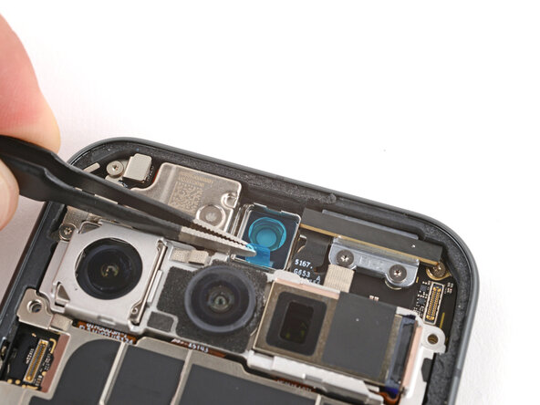

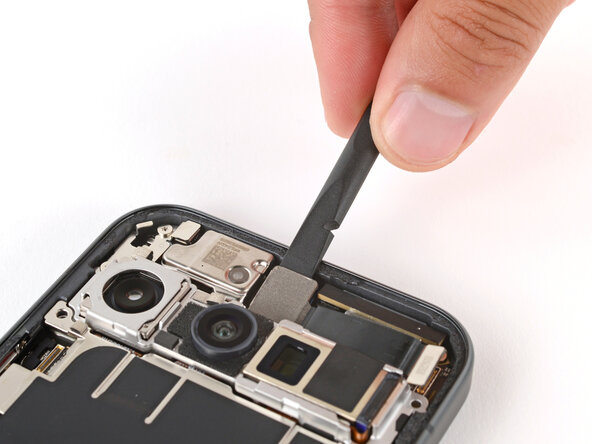

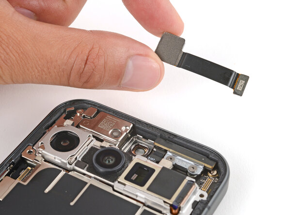

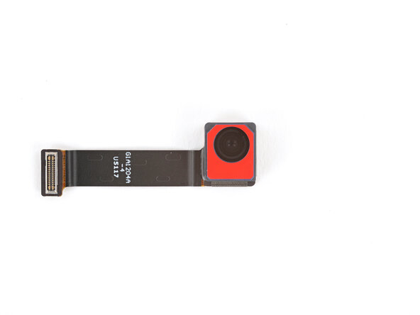

    4. Google Pixel 10 Front Camera Replacement, Remove the front camera: step 19, image 1 of 3 Google Pixel 10 Front Camera Replacement, Remove the front camera: step 19, image 2 of 3 Google Pixel 10 Front Camera Replacement, Remove the front camera: step 19, image 3 of 3
      • Adhesive secures the front camera in its recess.
      • Use a spudger to gently pry the front camera up from the top edge and remove it.
      Ask FixBot

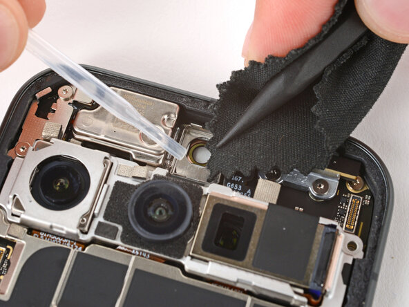

    1. Google Pixel 10 Front Camera Replacement, Remove the old adhesive: step 21, image 1 of 3 Google Pixel 10 Front Camera Replacement, Remove the old adhesive: step 21, image 2 of 3 Google Pixel 10 Front Camera Replacement, Remove the old adhesive: step 21, image 3 of 3
      • Use the point of a spudger and tweezers to gently scrape up and remove all the old front camera adhesive.
      • Use a spudger wrapped in a microfiber cloth and one drop of high‑concentration (>90%) isopropyl alcohol to clean up any adhesive residue from the front camera recess.
      • Allow the alcohol to dry completely before continuing.

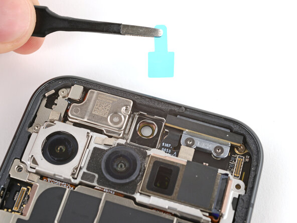

    2. Google Pixel 10 Front Camera Replacement, Install new adhesive: step 22, image 1 of 3 Google Pixel 10 Front Camera Replacement, Install new adhesive: step 22, image 2 of 3 Google Pixel 10 Front Camera Replacement, Install new adhesive: step 22, image 3 of 3
      • Remove the large clear liner from the front camera adhesive and gently place it into the recess.
      • Use a spudger to press down firmly on the adhesive to secure it.
      • Slowly peel up and remove the remaining liner.
      • If the adhesive starts to peel up with the liner, lay it down and press it into place firmly before trying again.
      Ask FixBot
    3. Google Pixel 10 Front Camera Replacement, Remove any protective caps: step 23, image 1 of 1
      • If your replacement front camera has a protective cap, carefully remove it.
      Ask FixBot

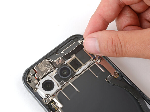

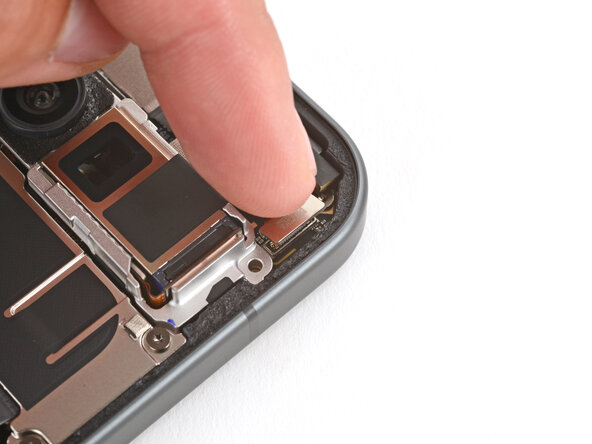

    4. Google Pixel 10 Front Camera Replacement, Install the front camera: step 24, image 1 of 3 Google Pixel 10 Front Camera Replacement, Install the front camera: step 24, image 2 of 3 Google Pixel 10 Front Camera Replacement, Install the front camera: step 24, image 3 of 3
      • With the cable facing the right side, lay the front camera into its recess and press it into place.
      Ask FixBot

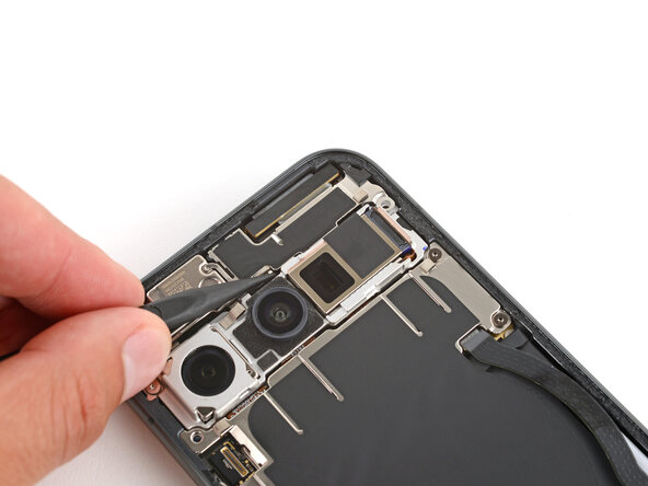

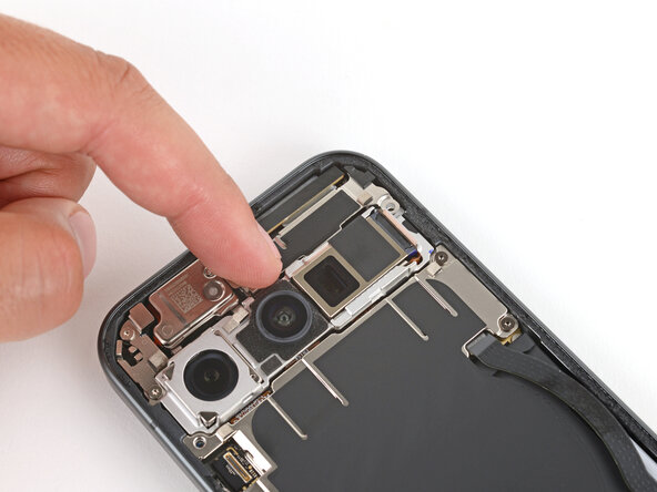

    5. Google Pixel 10 Front Camera Replacement, Connect the front camera: step 25, image 1 of 2 Google Pixel 10 Front Camera Replacement, Connect the front camera: step 25, image 2 of 2
      • Use your finger to press down and reconnect the front camera press connector.
      Ask FixBot

    14. Google Pixel 10 Front Camera Replacement, Connect the back glass cable: step 41, image 1 of 2 Google Pixel 10 Front Camera Replacement, Connect the back glass cable: step 41, image 2 of 2
      • Use the flat end of a spudger to connect the back glass press connector to its socket.
      • This can be tricky, as there's very little play in the cable. Move the back glass as necessary to help, and don't try to force the connector into place—reposition it and try again.

    15. Google Pixel 10 Front Camera Replacement, Install the bracket: step 42, image 1 of 3 Google Pixel 10 Front Camera Replacement, Install the bracket: step 42, image 2 of 3 Google Pixel 10 Front Camera Replacement, Install the bracket: step 42, image 3 of 3
      • Put the cable's bracket back in place, making sure the tab on the right edge goes under its groove.
      Ask FixBot
    16. Google Pixel 10 Front Camera Replacement: step 43, image 1 of 2 Google Pixel 10 Front Camera Replacement: step 43, image 2 of 2
      • Use a Torx Plus 3IP screwdriver to install the two 5.0 mm‑long screws securing the bracket.
