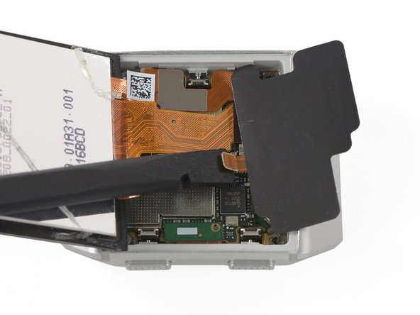

    1. Fitbit Ionic Display Assembly Replacement, Display Assembly: step 9, image 1 of 2 Fitbit Ionic Display Assembly Replacement, Display Assembly: step 9, image 2 of 2
      • Use the flat end of a spudger to loosen and pry up the mildly glued NFC antenna.
      • Carefully fold the NFC antenna in the direction of the upper edge of the watch.
      Ask FixBot
