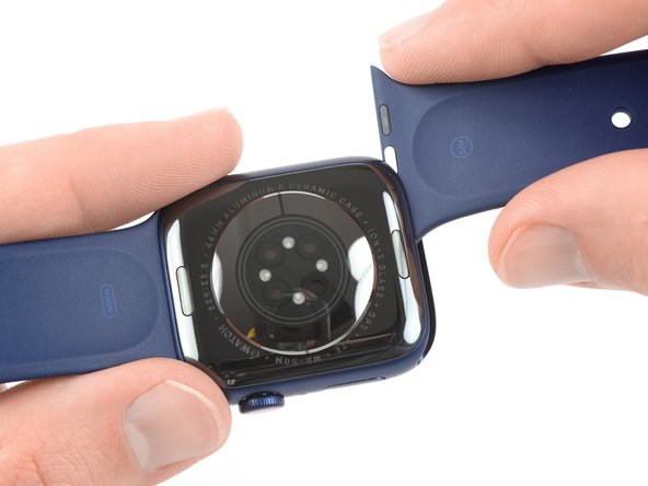

    1. Apple Watch Series 6 Screen Replacement, Power down the watch: step 1, image 1 of 2 Apple Watch Series 6 Screen Replacement, Power down the watch: step 1, image 2 of 2
      Ask FixBot
    2. Apple Watch Series 6 Screen Replacement, Safety Requirements: step 2, image 1 of 3 Apple Watch Series 6 Screen Replacement, Safety Requirements: step 2, image 2 of 3 Apple Watch Series 6 Screen Replacement, Safety Requirements: step 2, image 3 of 3
      • Because the gap between the screen and watch body is so thin, an iFlex is needed to separate the two.
      • Protect your fingers by keeping them completely clear of the iFlex edge. If in doubt, protect your free hand with a heavy glove, such as a leather shop glove or gardening glove.
      • Be careful not to apply too much pressure, as this might cause the iFlex to slip and cut you, or damage the watch.
      • Wear eye protection. If the opening procedure is performed incorrectly or with too much pressure, the glass could crack, sending small glass shards flying.
      • Attach or remove the watch band as needed to provide more control as you make repairs.
