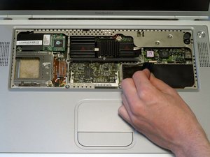

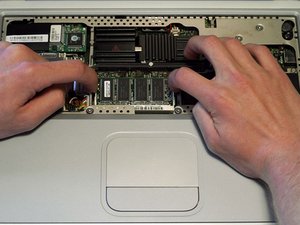

  • Memory: The Titanium Mercury shipped with PC100 RAM chips. You can also use PC133 RAM chips, which are backwards compatible with PC100 chips. On the Titanium Mercury, you don't have to remove any screws to upgrade your RAM. We offer different sizes, from 128 MB to 512 MB. For maximum performance, you can use a 512 MB chip in each slot, giving your machine a total of 1 GB RAM. Browse our RAM category or check out our easy PowerBook G4 Titanium Mercury RAM installation instructions.
