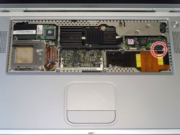

    • Remove the battery.
    • Turn the keyboard locking screw so that it is parallel to the space bar.
    • Pull the keyboard release tabs toward you and lift up on the keyboard until it pops free.

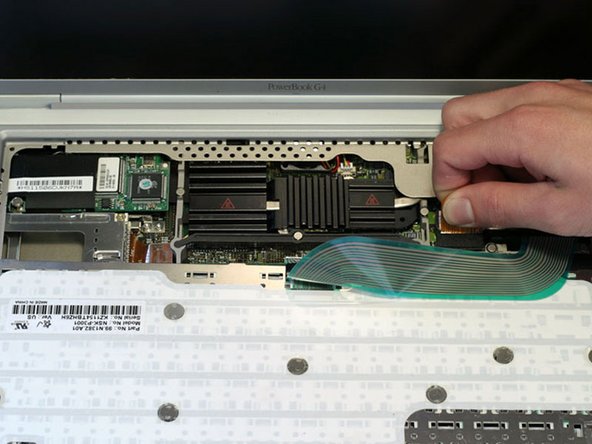

  2. PowerBook G4 Titanium Mercury PMU Replacement: step 2, image 1 of 1
    • Rest the keyboard face down on the trackpad area.
    • Disconnect the keyboard connector from the logic board.
  3. PowerBook G4 Titanium Mercury PMU Replacement: step 3, image 1 of 1
    • Your laptop should look approximately like this.

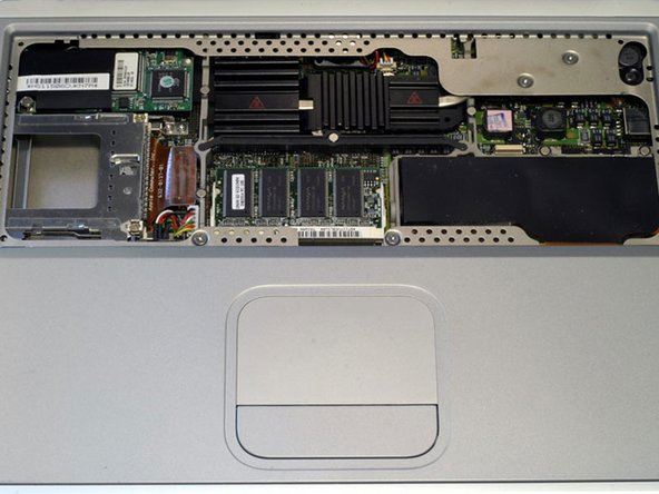

  4. PowerBook G4 Titanium Mercury PMU Replacement, RAM: step 4, image 1 of 1
    • Release the tabs on each side of the RAM chip at the same time. These tabs lock the chip in place and releasing them will cause the chip to "pop" up.
    • Pull the RAM chip out.
    • Repeat this process if a second RAM chip is installed.

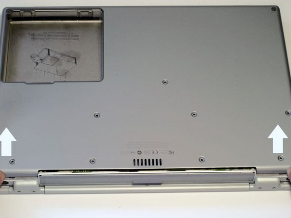

    • Turn the G4 over.
    • Remove the eight Phillips screws from the lower case.
  5. PowerBook G4 Titanium Mercury PMU Replacement: step 6, image 1 of 1
    • Using your thumbs, slide the lower case away from you.
    • The lower case may stick in the front on a tab just above the center of the DVD drive. Be careful as you work the case off, or you may break the thin strip of plastic just above the drive.
    • Lift the lower case off.

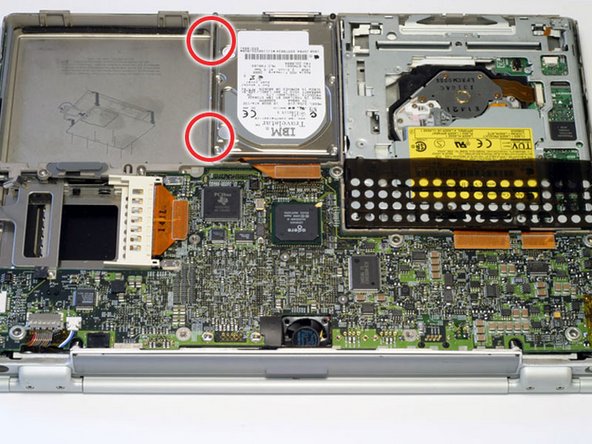

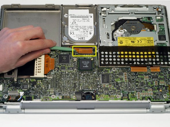

  7. PowerBook G4 Titanium Mercury PMU Replacement, Hard Drive: step 8, image 1 of 1
    • Disconnect the hard drive ribbon from the logic board using a spudger or the tip of your finger.
  8. PowerBook G4 Titanium Mercury PMU Replacement: step 9, image 1 of 1
    • To free the hard drive, remove the two T8 Torx screws from the right wall of the battery housing.
  9. PowerBook G4 Titanium Mercury PMU Replacement: step 10, image 1 of 1
    • Remove the hard drive by gently grasping the orange ribbon cable and lifting the left edge up and out of the computer.
    • There are four rubber bumpers that fit over the hard drive screws. Ensure that these bumpers come out when you remove the hard drive.

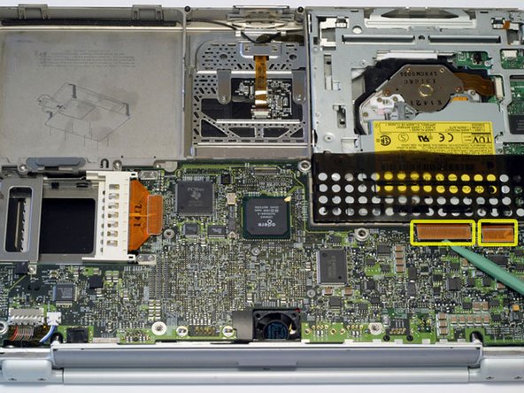

  13. PowerBook G4 Titanium Mercury PMU Replacement: step 14, image 1 of 1
    • Turn the G4 over.
    • Disconnect both orange ribbon cables from the logic board using a spudger or the tip of your finger.
  14. PowerBook G4 Titanium Mercury PMU Replacement: step 15, image 1 of 1
    • Remove the DVD drive by lifting the right edge up and out of the computer.
    • If you have a CD or any other object jammed in your optical drive, we have an optical drive repair guide.

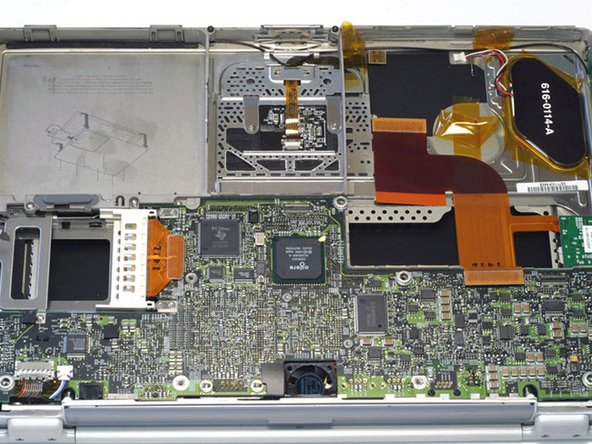

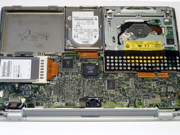

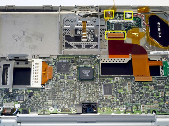

  15. PowerBook G4 Titanium Mercury PMU Replacement, PMU: step 16, image 1 of 1
    • Turn the G4 over.
    • Peel the orange tape away from the three connectors on the PMU board. Leave this tape in place so you can reuse it when reassembling the G4.
    • Disconnect the two orange cables and one multicolored cable from the PMU.

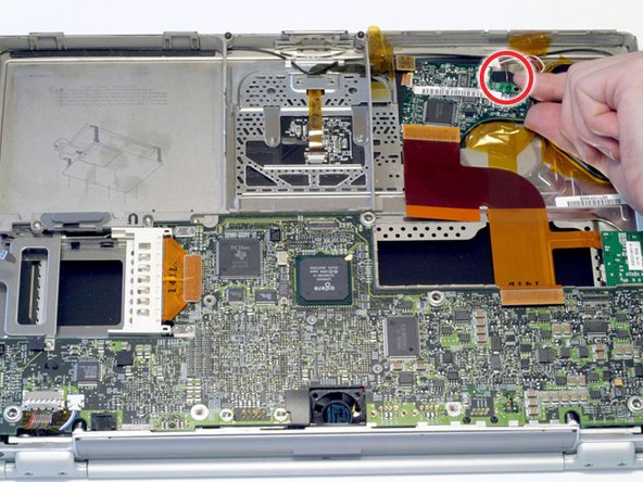

  16. PowerBook G4 Titanium Mercury PMU Replacement: step 17, image 1 of 1
    • Lift up on the silver metal clip to free the PMU from the casing.
    • Remove the PMU rotating it clockwise and pulling up.
  17. PowerBook G4 Titanium Mercury PMU Replacement: step 18, image 1 of 1
