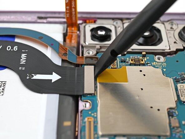

FPC/FFC: Press-Fit
Press-fit connectors are among the most popular connectors in mobile devices, and with good reason: they are low-profile, high-density, and easy to operate. To remove a press-connector simply get underneatgh the flat top with a spudger or fingernail, and pry it upwards gently. To reinstall, align the pins and press down slightly until there is a tactile click.
Many sizes exist of these, with small ones being used for peripheral connections such as fingerprint sensors, batteries and speakers. Larger ones are often used for display connections, cameras, and mother-daughterboard interconnects.
Shown: Samsung Galaxy S23 Plus Motherboard Replacement
