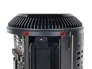

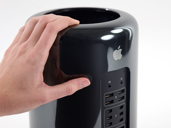

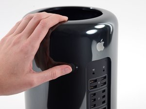

    1. Mac Pro Late 2013 Graphics Card Replacement, Outer Case: step 1, image 1 of 2 Mac Pro Late 2013 Graphics Card Replacement, Outer Case: step 1, image 2 of 2

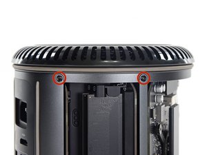

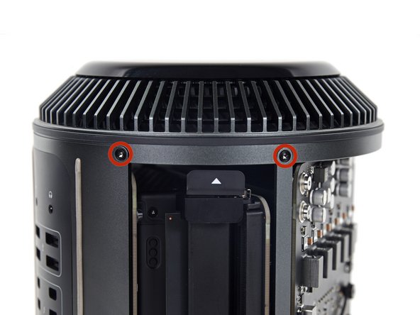

      • Slide the lock switch to the right, to the unlocked position.

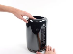

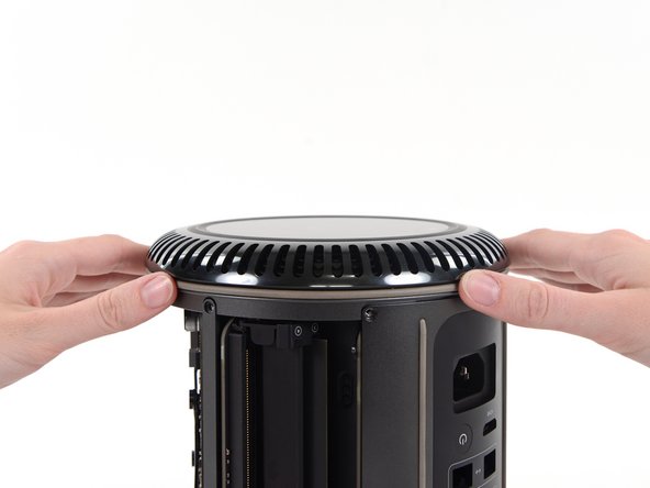

    2. Mac Pro Late 2013 Graphics Card Replacement: step 2, image 1 of 3 Mac Pro Late 2013 Graphics Card Replacement: step 2, image 2 of 3 Mac Pro Late 2013 Graphics Card Replacement: step 2, image 3 of 3

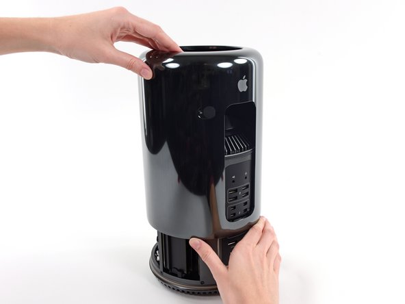

      • Lift the outer case straight up off the Mac Pro.
      • It may help to push down on the center of the fan while lifting the case up.

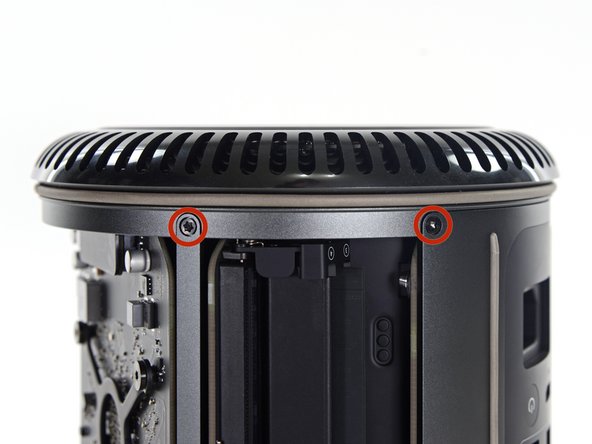

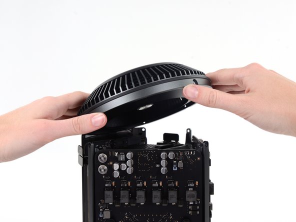

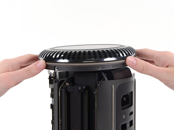

    1. Mac Pro Late 2013 Graphics Card Replacement, Fan Assembly: step 3, image 1 of 3 Mac Pro Late 2013 Graphics Card Replacement, Fan Assembly: step 3, image 2 of 3 Mac Pro Late 2013 Graphics Card Replacement, Fan Assembly: step 3, image 3 of 3
      • Remove five 5.1 mm T10 Torx screws from around the outer perimeter of the fan assembly.

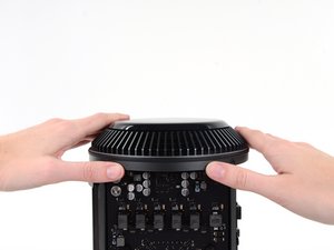

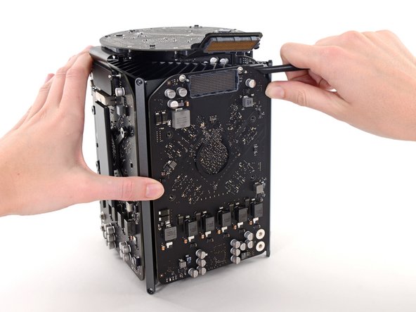

    2. Mac Pro Late 2013 Graphics Card Replacement: step 4, image 1 of 2 Mac Pro Late 2013 Graphics Card Replacement: step 4, image 2 of 2

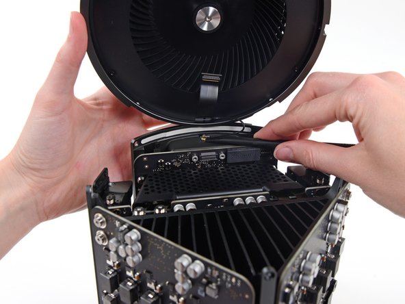

      • The fan assembly is attached to the rest of the computer by two cables on the IO board side.
      • Tilt the assembly up away from the IO board.
      • Do not try to remove the fan assembly yet, as it is still attached by two cables.
      Ask FixBot

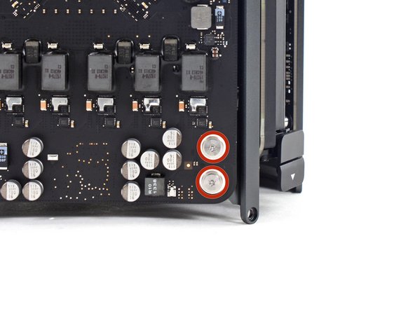

      • While supporting the fan assembly with one hand, loosen the two T8 captive screws in the fan cable bracket.
      • These screws are captive in the Mac Pro. Do not try to remove these screws from your Mac Pro.

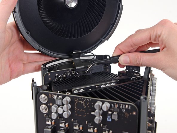

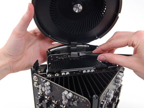

      • Use a pair of tweezers to pull the fan cable bracket away from the fan assembly.
      Ask FixBot

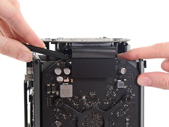

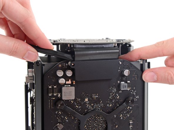

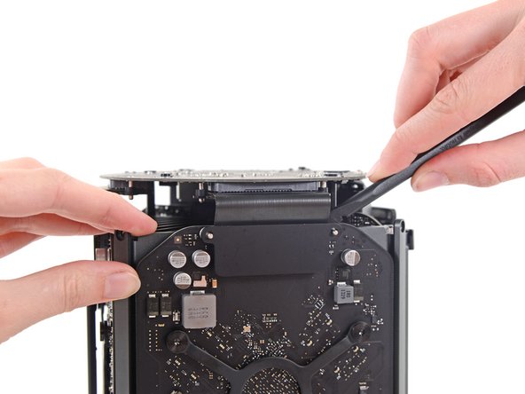

    5. Mac Pro Late 2013 Graphics Card Replacement: step 7, image 1 of 2 Mac Pro Late 2013 Graphics Card Replacement: step 7, image 2 of 2

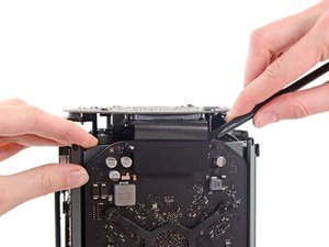

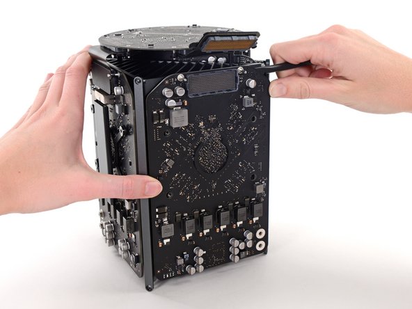

      • Use the flat end of a spudger to disconnect the fan assembly ribbon cable from the IO board.

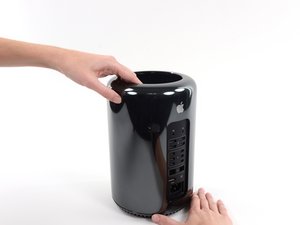

    1. Mac Pro Late 2013 Graphics Card Replacement, Lower Case: step 9, image 1 of 3 Mac Pro Late 2013 Graphics Card Replacement, Lower Case: step 9, image 2 of 3 Mac Pro Late 2013 Graphics Card Replacement, Lower Case: step 9, image 3 of 3
      • Flip the Mac Pro upside down, 180 degrees.
      • Remove five 5.1 mm T10 Torx screws from the outer perimeter of the lower case.

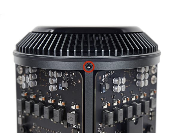

      • Remove the two 6.6 mm T8 Torx Security screws securing the GPU to the Mac Pro.
      • These screws fit into power cables behind the GPU. Be careful not to over-tighten and twist the cables.

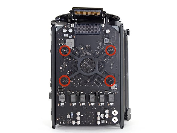

    4. Mac Pro Late 2013 Graphics Card Replacement: step 14, image 1 of 1

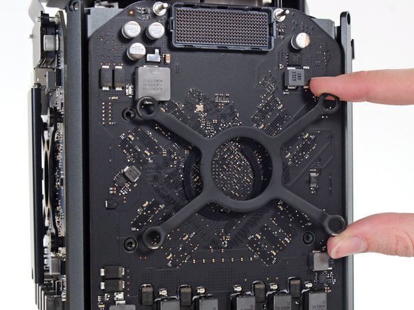

      • Remove the four 8.4 mm T10 screws from the GPU heat sink bracket.
      Ask FixBot
    5. Mac Pro Late 2013 Graphics Card Replacement: step 15, image 1 of 1
      • Remove the GPU heat sink bracket.

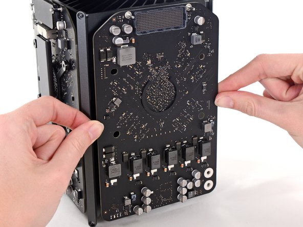

      • The graphics card is now held onto the central heat sink by thermal compound.
      • You may need to pry very gently with a spudger to separate the card from the heat sink.
      • Remove the graphics card from the heat sink.
