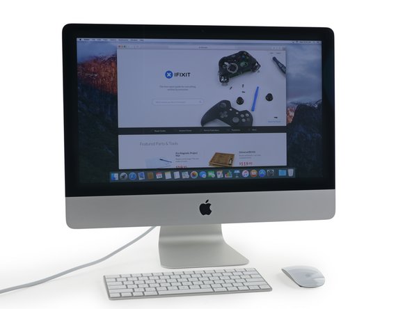

Edit Step 1 iMac Intel 21.5" EMC 2889 Teardown  ¶
Image 1/2: 1.6 GHz dual‑core or 2.8GHz quad‑core Intel Core i5
  • The 2015 edition of the 21.5" iMac has some newfangled specs:
    • 1.6 GHz dual‑core or 2.8GHz quad‑core Intel Core i5
    • 8 GB (4x2 GB) of 1867 MHz LPDDR3 RAM (Configurable to 16GB)
    • Intel HD Graphics 6000 or Intel Iris Pro Graphics 6200
    • 1 TB (5400-rpm) hard drive, configurable up to 1 TB Fusion Drive or 256 GB of flash storage.
    • 802.11ac Wi-Fi + Bluetooth 4.0
  • More on those accessories later...

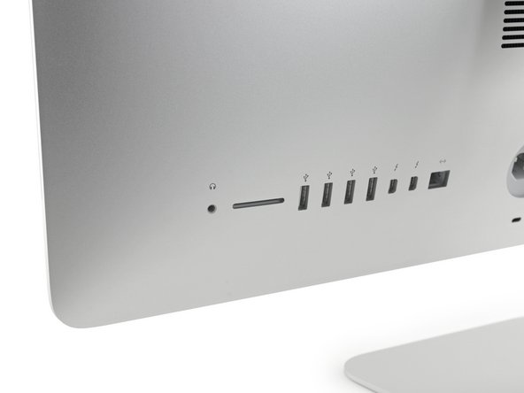

  • As tempted as we are to play with the new Magic things, we briefly turn our attention to the port side rear of this refreshed iMac.
    • The ports on the rear: headphone jack, SD card slot, four USB 3.0, two Thunderbolt 2, and gigabit ethernet.
  • This iteration iMac keeps the standard 21.5" model number, A1418 but adopts a new EMC number: 2889.

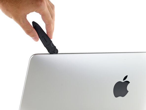

Image 1/3: Nope, there's no [https://www.youtube.com/watch?v=UPXUG8q4jKU|pizza|new_window=true] here folks. We're just using our handy iMac opening tool to cut the display adhesive. We're on a roll!
Edit Step 3  ¶

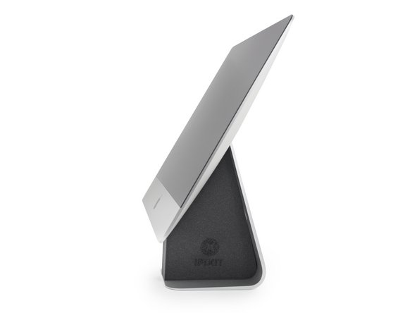

  • Thanks to our specially designed iMac service wedge, opening is a breeze. The wedge keeps the hinge solid while you work—no flop, no slop.
  • Nope, there's no pizza here folks. We're just using our handy iMac opening tool to cut the display adhesive. We're on a roll!
  • Just as with the previous generation, the display cables on the new iMac keep the opening procedure from being totally painless.

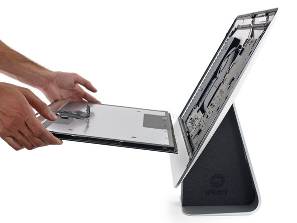

Image 1/2: [http://www.nasa.gov/multimedia/nasatv/index.html|We have separation|new_window=true]—and the display's away!
Edit Step 4  ¶

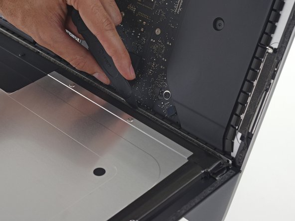

  • The multi-talented iMac opening tool helps us slice away the last of the adhesive.
  • We have separation—and the display's away!
  • Time to see what this machine is really packing...

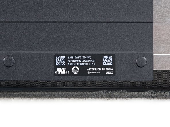

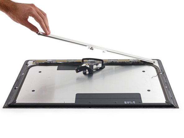

Edit Step 5  ¶
Image 1/2: A few turns of the old screwdriver shows us the first glimpse of the  good stuff.
Edit Step 5  ¶
  • Once again, this high resolution display is brought to you by LG.
  • A few turns of the old screwdriver shows us the first glimpse of the good stuff.

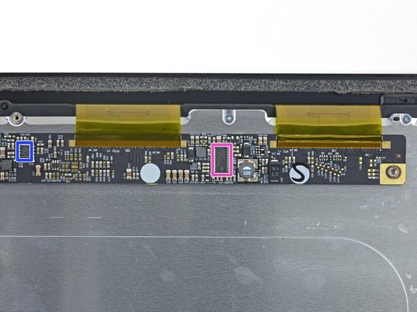

Edit Step 6  ¶
Image 1/3: Texas Instruments [http://www.ti.com/lit/ds/symlink/buf16821.pdf|BUF16821|new_window=true] Programmable Gamma-Voltage Generator
Edit Step 6  ¶

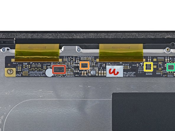

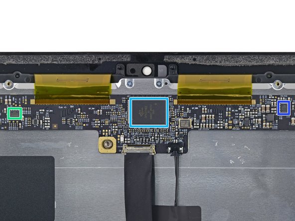

  • Like previous iterations, this iMac display gets its own full set of control hardware:
    • Texas Instruments BUF16821 Programmable Gamma-Voltage Generator
    • Richtek RT8250 Synchronous Step-Down Converter
    • ST Microelectronics 404RP K516
    • Winbond W25X20CL 2 Mb Serial NOR Flash Memory
    • Parade DP627HDE DisplayPort LCD timing controller
    • Texas Instruments TPS54231 Step-Down Converter
    • Texas Instruments TPS65161 Bias Power Supply for TFT LCD Panels

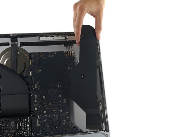

Edit Step 7  ¶
Image 1/3: Answer: Time travel has not been invented ''yet''.
Edit Step 7  ¶

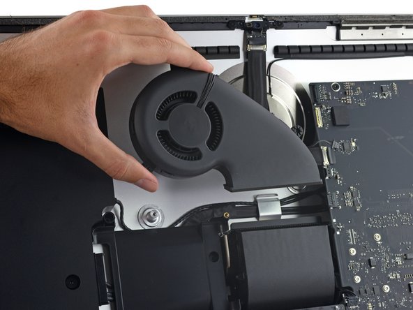

  • Are we lost in time or are does this look exactly the same as last year's 21.5" iMac?
    • Answer: Time travel has not been invented yet.
  • Despite the similar appearance, the Fusion Drive in this model has a significantly smaller flash partition than the previous generation.
  • We've yet to see something new or interesting here—if you're really itching to see how the speakers, hard drive, and fan come out, check our previous gen guides for details!

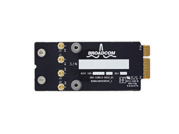

Edit Step 8  ¶

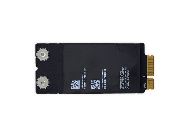

Image 1/2: The antenna cables are now fastened to the AirPort card with new screw-secured cable clamps.
Edit Step 8  ¶

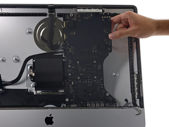

  • Our breakneck advance on the logic board is stymied by a bit of novelty!
  • The antenna cables are now fastened to the AirPort card with new screw-secured cable clamps.
  • AirPort card released, the logic board is free to be wriggled out of the rear case.

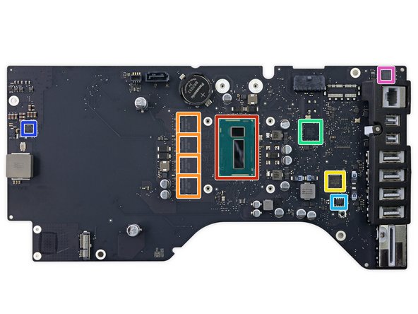

  • Next up—the logic board:
    • Intel SR26C Core i5-5250U 1.6 GHz Processor (3M Cache, TurboBoost up to 2.70 GHz) with Intel HD Graphics 6000
    • Samsung K4E6E304EE-EGCF 16 Gb LPDDR3 1867 MHz SDRAM (4 chips for a total of 8 GB)
    • Broadcom BCM5776 Gigabit Ethernet Controller
    • Texas Instruments LM4FS1EH SMC Controller
    • Adesto AT45DB021E 2 Mb SPI Serial Flash Memory
    • National Semiconductor 545AR6SU
    • Delta 8904C-F Filter

Edit Step 11  ¶
Image 1/2: See the [https://www.ifixit.com/Teardown/iMac+Intel+21.5-Inch+EMC+2638+Teardown/17829#s52533|2013 teardown] for details on this bad boy if you really gotta know.
Edit Step 11  ¶
  • We also take the time to remove the AirPort card, but it's more of the same ol', same ol'.
  • See the 2013 teardown for details on this bad boy if you really gotta know.

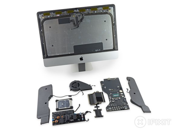

Edit Step 12  ¶
Image 1/2: Cutting the tape to open the iMac isn't too difficult with the right tools, but it must then be replaced to complete any repair.
Edit Step 12  ¶
  • iMac 21.5" EMC 2889 Repairability Score: 1 out of 10 (10 is easiest to repair)
    • Cutting the tape to open the iMac isn't too difficult with the right tools, but it must then be replaced to complete any repair.
    • The RAM is still soldered to the logic board—you're stuck with what you bought.
    • The Fusion Drive connector is again missing from the logic board, killing all hope of storage hacking.
    • The CPU is soldered to the logic board, and cannot be replaced or upgraded.
    • The glass and LCD are fused together, increasing the cost of replacement.
