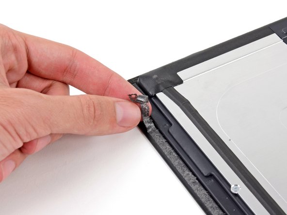

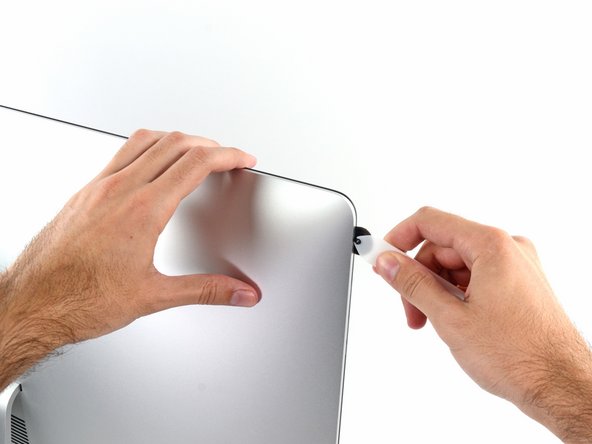

  • Apple again used the fun foamy adhesive to hold the display in place. Fortunately, we have a solution to that sticky situation, just in case you need it.
    • With a couple of cuts here and there, we managed to get in.
  • We're sad to see that Apple hasn't upgraded iMac's display cable, which is delicate and can be prone to disaster. So if you attempt this at home, take care when opening it!

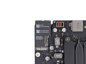

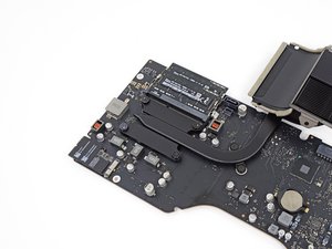

  • We had to do some digging and actually remove the logic board from the iMac. We don't like work. Work is hard. But the reward was certainly worth the effort.
  • Our base-model 21.5" iMac now features an empty PCIe SSD slot, ready and waiting for eager money-saving DIY upgraders everywhere.

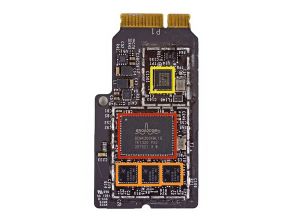

  • Marked as BCM94360CD, this Broadcom AirPort card boasts support for the new 802.11ac Wi-Fi standard.
    • Not the first Mac to get updated with the new ac standard, we expected to see some similar hardware as in the refreshed MacBook Airs from earlier this year.
  • What's under the hood?
    • Broadcom BCM4360KML1G 5G WiFi 3-stream 802.11ac gigabit transceiver—as expected, this is the same chip driving the ac Wi-Fi in the 11" and 13" MacBook Air
    • Three Skyworks SE5516: dual-band 802.11a/b/g/n/ac WLAN front-end modules
    • Broadcom BCM20702 single-chip Bluetooth 4.0 HCI solution with Bluetooth Low Energy (BLE) support

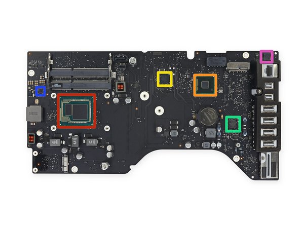

  • The front-side ICs are looking mighty familiar, despite a CPU/GPU shuffle:
    • 2.7GHz quad-core Intel Core i5 with Intel Iris Pro graphics processor.
    • Intel E213B384 platform controller hub
    • Texas Instruments Stellaris LM4FS1AH microcontroller
    • Broadcom BCM57765A1KMLG gigabit ethernet controller with integrated SDXC card reader
    • National Semiconductor VM22AC

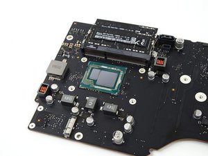

  • Apple's iterative streamlining is again in effect, with a slimmed down and beautified CPU heat sink.
  • We compared this new heat sink to last November's bigger, beefier, and more securely-fastened spidery mess, and started to wonder what changed to allow such a slender 'sink.
    • The truth was alarming—the CPU is soldered in place on the logic board, and cannot be removed, replaced, or upgraded.
    • As far as we can tell, this is the first aluminum iMac to have a soldered CPU; it's a silent, but clear, shift to even poorer iMac upgradeability.

The reason that the CPU is soldered is because Intel doesn't offer any socketed CPUs with the Iris Pro GPU. So Apple is forced to use the soldered processor instead
Honam1021, · Reply
I agree with the previous comment. Had anyone read anything about Haswell and Iris Pro, they would already know that this is the only way Intel will let OEM's integrate this particular CPU/GPU package. I'd bet good money the iMac 21.5" with Nvidia graphics has a socketed processor.
Michael Heath, · Reply
Well, the 27" iMac has a socketed processor because it doesn't need it, so chances are good...
Worf,
So if you choose the new 21.5 imac with the nvidia GT750M option, the processor would be socketed? If this is true, this is the best buy option for 21.5...
