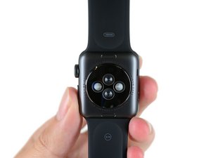

The back of the Series 2 is adorned by a familiar quartet of optical polymer lenses protecting a set of LEDs and photodiodes.

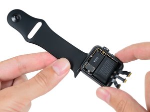

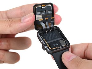

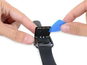

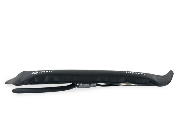

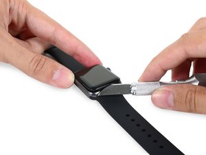

Armed with knowledge gleaned from the original Apple Watch and our expertise wielding an iOpener, we're ready to bust through the adhesive and pop off the screen.
A knife, a pick, and a spoon full of gumption later and we're in!

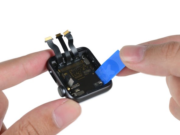

Externally, the Series 2 bears a strong resemblance to its older sibling—but once inside, we find a set of ZIF connectors in place of the awkward press connectors of yesteryear.

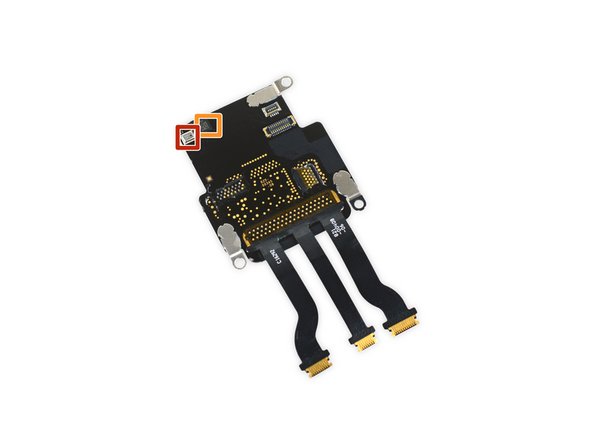

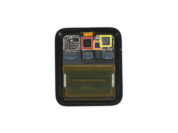

And tucked away on the back of the display we find a whole host of control hardware:
Apple 343S00092
20211CP TD1628A
NXP 67V04 NFC Controller (also found in the iPhone 7 Plus)

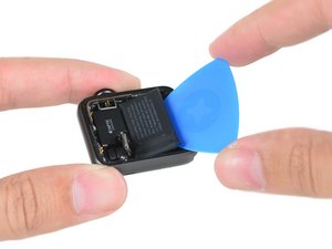

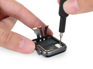

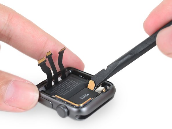

We slide the remaining band away from the body of the watch and start digging for the battery.
Just like the battery bracket in its cellular-capable counterpart, this piece is held in by a less-than-friendly tri-point screw. Thankfully, our 64 Bit Driver Kit is up to the task!
With a deft flick of our spudger this watch is rendered powerless.
So indeed according to the image the wifi antenna has moved to the right near the Digital Crown rather than the more familiar one we saw on the first generation on the top row just above the Taptic Engine and the speaker module
Welp—as they say—if it seems too good to be true, it probably is.

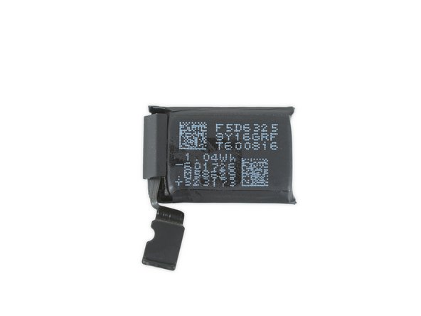

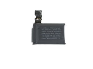

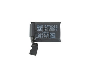

Compared to last year's Apple Watch, the underside of the Series 2 battery reveals enough
chewing gumadhesive to hold an iPad screen in place. -

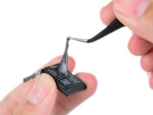

We've never backed down from a sticky situation before, and this is no exception. We pick and prod, peel and pull the adhesive off the little power pack—with enough coaxing, it will come clean and reveal its secrets.
With the glue stripped from the back of the battery, we get a closer look at its impressive specs. This cell is rated at 3.77 V and 273 mAh to yield a whopping 1.03 Whr of power.
I am glad the battery is bigger than the original Apple Watch. As a Pebble watch owner, I have been leery of the low battery life of the original Apple Watch. I would like to see a teardown of the new Apple Watch Series 1. I would like to see if the new battery in the Apple Watch Series 1 really is the same size as the new Apple Watch Series 2. (I know that the “published” battery life shows them with similar battery life's, but I take that published data with a grain of salt…) The GPS and water proofing of the Apple Watch Series 2 are not features that are particularly important to me, but battery life is. If the new Apple Watch Series 2 has a bigger battery than the new Apple Watch Series 1, that might make me look into the Apple Watch Series 2 (I’d keep GPS off), but if they both have the same battery, then I would lean toward the new Apple Watch series 1.
Can you measure the dimensions of the battery and post them?

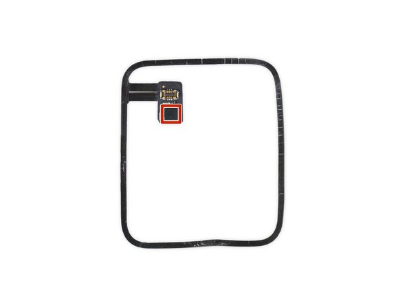

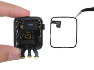

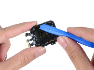

Taking a plastic opening tool to the rim of the watch reveals a Force Touch sensor and gasket similar to the one found in the original model.
Unlike last year's model, there's a lone IC hiding away on the Force Touch gasket:
Analog Devices AD7149 Capacitance Sensor Controller

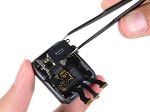

Next on our disassembly line is the noticeably larger Taptic Engine.

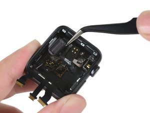

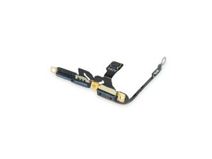

With the Taptic Engine extracted, we inspect the antenna module found tucked away at the top of the watch.
Enough gawking—it's time to get our tweezers on what's left of this wearable.
Any suggestion of whether the new antenna will give better wifi connectivity than the original had?

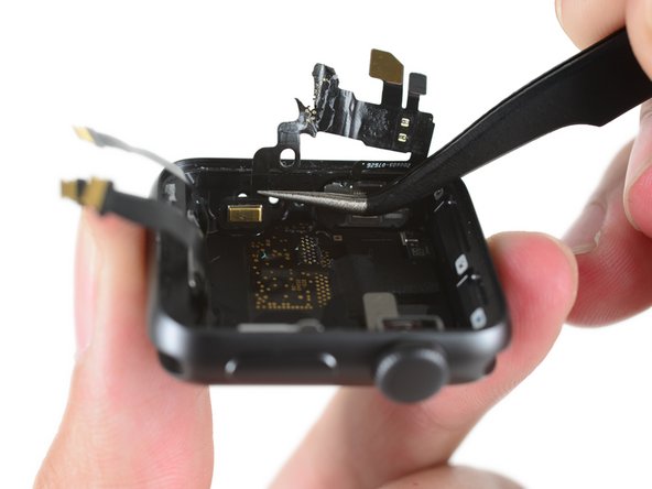

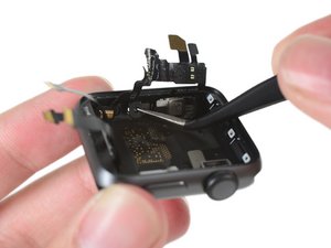

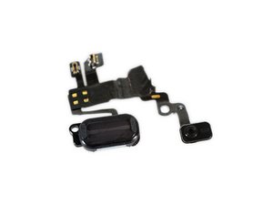

Hiding out on the outer rim, we find a complex cable assembly—home to the microphone and speaker.

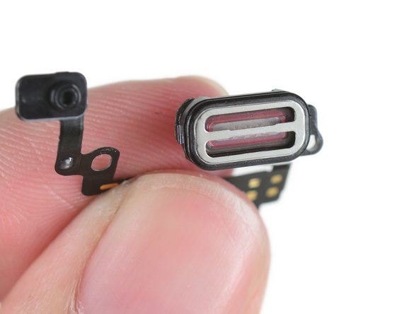

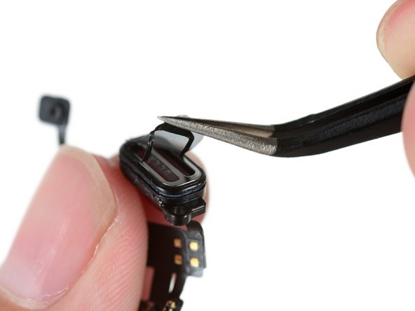

Did someone say ingress protection? This highly-touted speaker is equipped to deal with incoming water rather than fight it.
Unlike the original Apple Watch's speaker—which would simply flood when underwater—this module is designed to fill with water, then vibrate to pump excess water from the body of the speaker.
There's one last piece barring us from reaching the belly of the beast: this ribbon cable assembly, where the Home Button and Digital Crown encoder reside.

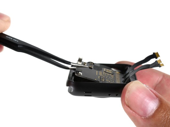

Luckily, no teardown can be thwarted so easily. We quickly move past the gangly assembly to get at the core computer in this little wearable wonder.

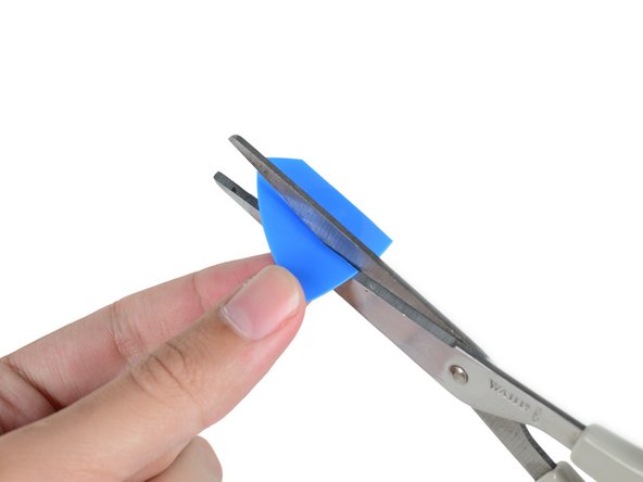

And, in keeping with the tradition of last-minute tool modifications, we make use of our all new Apple Watch Opening Pick to lift the System in Package out of the rear enclosure.

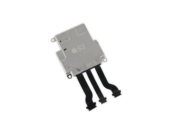

And we finally reach the much awaited Apple S2 SiP—complete with the dreaded resin enclosure.

Any reason why you guys did not open that shiny module? Would be interesting to see what kind of memory is in there as well as the application processor to memory interface.
From the first Apple Watch Teardown: "Unfortunately, our first look is obstructed—that S1-emblazoned silver cap isn't a cap at all. It's a solid block of plasticky resin, hiding treasures deep within."
This is what they were referring to as the "dreaded resin enclosure"

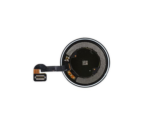

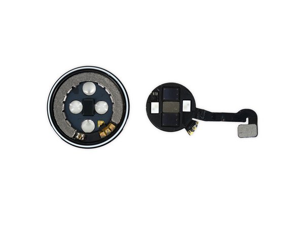

All that's left between us and complete teardown glory is the sensor array, housed in the watch's back cover.
The four-sensor array includes infrared sensors, visible-light LEDS, and photosensors to track your heart rate throughout the day.
With the sensor assembly removed, we spy what we assume is the inductive charging coil left behind in the cover.
No adhesive this time? Is this snap-in like some manufacturers do with their traditional watches?
How to get that sensor any idea guys!!

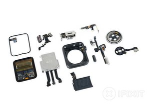

And that's a wrap! With our Apple Watch torn asunder on the teardown table we step back to pick up the pieces—and hope it's still waterproof when we put it all back together.
Final Thoughts
- While not an industry standard, the watch band is easily removed and swapped out for a replacement.
- Removing the screen is difficult, but not impossible—it's the first component out, and is connected with easy to use ZIF connectors.
- Once you're inside, the battery is fairly easy to remove—if you have the proper tri-point Y000 driver.
- While not proprietary, incredibly tiny tri-point screws are a repair hinderance.
- Replacing any of the component cables requires microsoldering—but does not require removing the SiP as in the previous generation Apple Watch.
- The fully encased S2 system makes board-level repairs impossible.

Jesus! The capacitor in step 4 picture 3 on the right is nearly falling off! Quality control is minimal here!

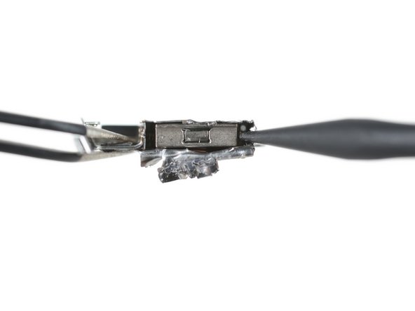

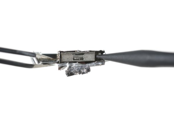

the question is how was the metal shielding removed. If you see earlier photos, those areas were protected. Those protection needs to be removed before 3rd photo could be taken. If excessive heat was applied, of course the solders holding those components would melt, causing them to look like that.
Yes, we had to desolder the metal shield. That damaged some components underneath. If you've got a better technique for removing these shields, we're all ears!

In regards of how to remove the shielding without suffering component damage, you could physically cut it off. I did that with an iPhone 5 logic board, although it damaged some coils. There must be a more precise way to machine it off.
