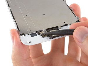

      • Remove the two 1.8 mm Phillips screws securing the home button bracket to the front panel.
      Ask FixBot

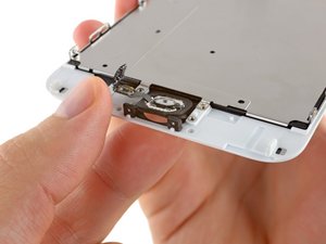

    2. iPhone 6 Plus Screen Replacement: step 21, image 1 of 1
      • Remove the home button bracket from the front panel assembly.
      Ask FixBot

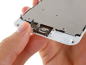

    3. iPhone 6 Plus Screen Replacement: step 22, image 1 of 2 iPhone 6 Plus Screen Replacement: step 22, image 2 of 2
      • Use the tip of a spudger to disconnect the home button connector from its socket on the home button cable.
      Ask FixBot

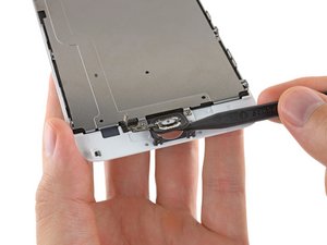

    4. iPhone 6 Plus Screen Replacement: step 23, image 1 of 1
      Tool used on this step:
      iOpener
      $14.95
      Buy
      • Carefully wedge the tip of a spudger underneath the home button connector cable.
      • Gently move the spudger across to separate the home button connector cable from the adhesive securing it to the front panel assembly.
      • If the cable doesn't separate easily, apply heat using an iOpener or hair dryer to soften the adhesive, and try again. Be careful not to damage the cable.

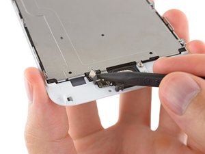

    5. iPhone 6 Plus Screen Replacement: step 24, image 1 of 2 iPhone 6 Plus Screen Replacement: step 24, image 2 of 2
      iOpener
      $24.95
      Buy
      • The rubber gasket surrounding the home button is very thin and tears easily.
      • Apply mild heat (with an iOpener, heat gun, or hair dryer) to soften the adhesive securing the home button gasket.
      • Using your fingertip, gently press up on the home button from the front side of the display assembly. Use firm, constant pressure to slowly separate the home button's rubber gasket from the front panel.
      Ask FixBot

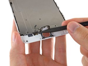

    6. iPhone 6 Plus Screen Replacement: step 25, image 1 of 2 iPhone 6 Plus Screen Replacement: step 25, image 2 of 2
      • Carefully use the tip of a spudger to finish separating the home button from the front panel.
      Ask FixBot
    7. iPhone 6 Plus Screen Replacement: step 26, image 1 of 1
      • Lift and remove the home button assembly off the front panel assembly.
      Ask FixBot
