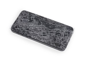

    2. iPhone 5s Rear Facing Camera Replacement, Taping the display glass: step 2, image 1 of 3 iPhone 5s Rear Facing Camera Replacement, Taping the display glass: step 2, image 2 of 3 iPhone 5s Rear Facing Camera Replacement, Taping the display glass: step 2, image 3 of 3
      • If your display glass is cracked, keep further breakage contained and prevent bodily harm during your repair by taping the glass.
      • Lay overlapping strips of clear packing tape over the iPhone's display until the whole face is covered.
      • This will keep glass shards contained and provide structural integrity when prying and lifting the display.
      • Wear safety glasses to protect your eyes from any glass shaken free during the repair.

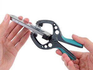

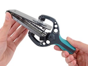

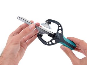

    4. iPhone 5s Rear Facing Camera Replacement, Anti-Clamp instructions: step 4, image 1 of 3 iPhone 5s Rear Facing Camera Replacement, Anti-Clamp instructions: step 4, image 2 of 3 iPhone 5s Rear Facing Camera Replacement, Anti-Clamp instructions: step 4, image 3 of 3
      Tool used on this step:
      Clampy - Anti-Clamp
      $24.95
      Buy

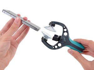

      • The next two steps demonstrate the Anti-Clamp, a tool we designed to make the opening procedure easier. If you aren't using the Anti-Clamp, skip down two steps for an alternate method.
      • For complete instructions on how to use the Anti-Clamp, check out this guide.
      • Pull the blue handle backwards to unlock the Anti-Clamp's arms.
      • Slide the arms over either the left or right edge of your iPhone.
      • Position the suction cups near the bottom edge of the iPhone just above the home button—one on the front, and one on the back.
      • Squeeze the cups together to apply suction to the desired area.
      • If the surface of your iPhone is too slippery for the Anti-Clamp to hold onto, you can use the included tape pad to create a grippier surface.
      Ask FixBot

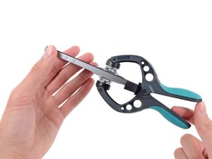

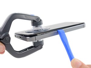

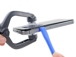

    5. iPhone 5s Rear Facing Camera Replacement: step 5, image 1 of 3 iPhone 5s Rear Facing Camera Replacement: step 5, image 2 of 3 iPhone 5s Rear Facing Camera Replacement: step 5, image 3 of 3
      • Pull the blue handle forwards to lock the arms.
      • Turn the handle clockwise 360 degrees or until the cups start to stretch.
      • Make sure the suction cups remain aligned with each other. If they begin to slip out of alignment, loosen the suction cups slightly and realign the arms.
      • Insert an opening pick under the screen when the Anti-Clamp creates a large enough gap.
      • If the Anti-Clamp doesn't create a sufficient gap, rotate the handle a quarter turn.
      • Don't crank more than a quarter turn at a time and wait a few seconds between turns. Let the Anti-Clamp and time do the work for you.
      • Skip the next two steps.

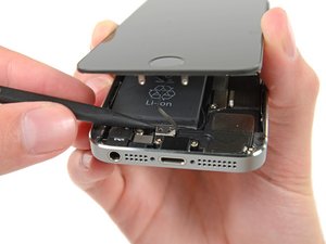

      • Open the phone just enough to reveal the metal bracket covering the home button cable.
      • Do not open the phone too far or you risk damaging the home button cable, or the socket it plugs into. Keep the cable loose—if it is stretched out, that's too far.
      • Only the phone's original home button assembly will be capable of using the Touch ID functionality. If you rip the cable, installing a new home button will only restore ordinary home button functions, not the Touch ID features.
      • Use the tip of a spudger to push the bracket free and remove it with tweezers.

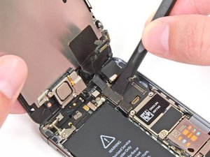

    12. iPhone 5s Rear Facing Camera Replacement, Disconnecting the home button cable connector: step 12, image 1 of 2 iPhone 5s Rear Facing Camera Replacement, Disconnecting the home button cable connector: step 12, image 2 of 2
      • Use the tip of a spudger to pry the home button cable connector up out of its socket.
      • Be sure you're separating the cable connector from its socket, and not prying the entire socket up. The socket is on its own glued-down cable that can be pried up if you aren't careful.

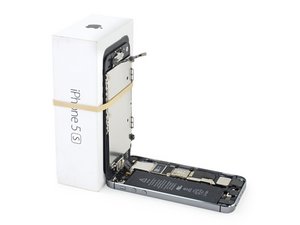

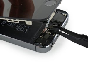

    13. iPhone 5s Rear Facing Camera Replacement, Opening up the phone: step 13, image 1 of 3 iPhone 5s Rear Facing Camera Replacement, Opening up the phone: step 13, image 2 of 3 iPhone 5s Rear Facing Camera Replacement, Opening up the phone: step 13, image 3 of 3
      • Once the connector has been released, pull the home button end of the assembly away from the rear case, using the top of the phone as a hinge.
      • Open the display to about a 90º angle, and lean it against something to keep it propped up while you're working on the phone.
      • Add a rubber band to keep the display securely in place while you work. This prevents undue strain on the display cables.
      • In a pinch, you can use an unopened canned beverage to hold the display.

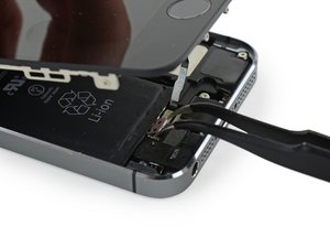

    15. iPhone 5s Rear Facing Camera Replacement: step 15, image 1 of 1
      • Remove the metal battery connector bracket from the iPhone.
      Ask FixBot

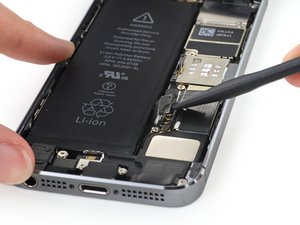

    16. iPhone 5s Rear Facing Camera Replacement: step 16, image 1 of 2 iPhone 5s Rear Facing Camera Replacement: step 16, image 2 of 2
      • Use the flat end of a spudger to gently pry the battery connector up from its socket on the logic board.
      • Be very careful to only pry up on the battery connector itself and not the socket on the logic board. If you pry up on the logic board socket or the board itself, you may destroy the socket or damage nearby components on the board.
      Ask FixBot

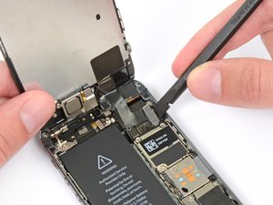

      • Remove the following screws securing the front panel assembly cable bracket to the logic board:
      • One 1.7 mm Phillips #000 screw
      • One 1.2 mm Phillips #000 screw
      • One 1.3 mm Phillips #000 screw
      • One more 1.7 mm Phillips #000 screw
      • This 1.7 mm screw tends to not be attracted to a magnetized screwdriver. Take care not to lose it when removing.
      • It is especially important to keep track of your screws in this step for reassembly. Accidentally using the 1.3 mm screw or one of the 1.7 mm screws in the bottom right hole will result in significant damage to the logic board causing the phone to no longer boot properly.
      • Be careful not to over-tighten the screws, and don't force them. If they don't fit easily when you are securing them, they may be the wrong size.
      Ask FixBot
    18. iPhone 5s Rear Facing Camera Replacement: step 18, image 1 of 1
      • Remove the front panel assembly cable bracket from the logic board.
      Ask FixBot

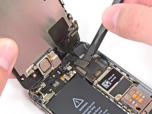

    19. iPhone 5s Rear Facing Camera Replacement: step 19, image 1 of 2 iPhone 5s Rear Facing Camera Replacement: step 19, image 2 of 2
      • Use a spudger or a fingernail to disconnect the front-facing camera and sensor cable.
      Ask FixBot

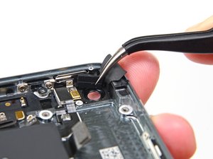

    1. iPhone 5s Rear Facing Camera Replacement, Rear Facing Camera: step 23, image 1 of 2 iPhone 5s Rear Facing Camera Replacement, Rear Facing Camera: step 23, image 2 of 2
      Buy

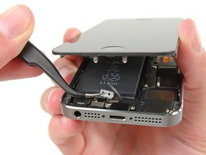

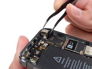

      • Using a pair of tweezers, flip the rubber camera cover out of its clip, and toward the outside of the rear case.
      • Do not attempt to fully remove this cover, it is attached to the rear case, and only needs to be flipped open, not removed.
      Ask FixBot

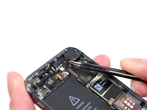

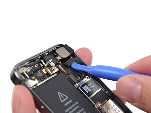

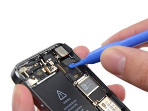

    2. iPhone 5s Rear Facing Camera Replacement: step 24, image 1 of 2 iPhone 5s Rear Facing Camera Replacement: step 24, image 2 of 2
      • Using a plastic opening tool, disconnect the rear-facing camera cable connector from the logic board.
      • Be careful to only pry up on the connector, not the socket itself.
      Ask FixBot

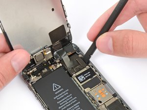

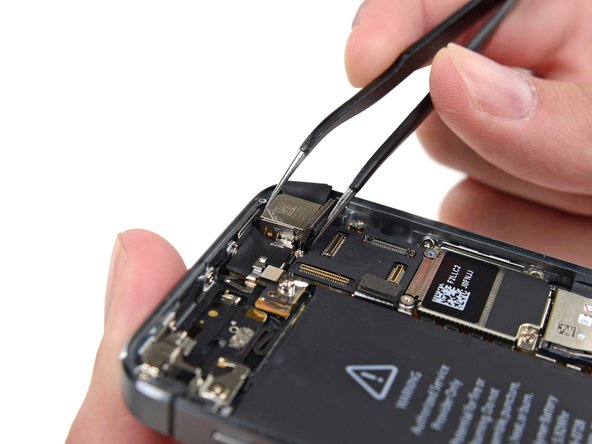

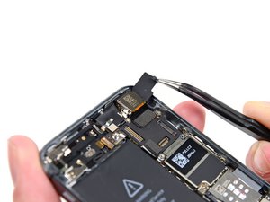

    3. iPhone 5s Rear Facing Camera Replacement: step 25, image 1 of 3 iPhone 5s Rear Facing Camera Replacement: step 25, image 2 of 3 iPhone 5s Rear Facing Camera Replacement: step 25, image 3 of 3
      • Remove the rear-facing camera from the rear case.
      • During reassembly, ensure that the camera cable bends in a 'U' shape to slot in behind the logic board.
      • If the rubber camera bumper has shifted, be sure to replace it before reassembling your iPhone.
      Ask FixBot
