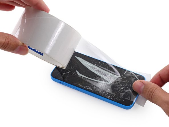

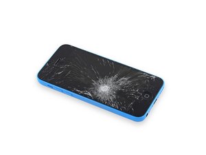

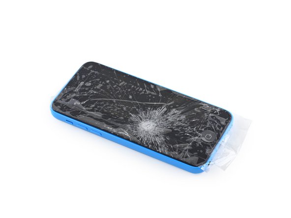

    1. iPhone 5c LCD and Digitizer Replacement, Taping the display glass: step 1, image 1 of 3 iPhone 5c LCD and Digitizer Replacement, Taping the display glass: step 1, image 2 of 3 iPhone 5c LCD and Digitizer Replacement, Taping the display glass: step 1, image 3 of 3
      • If your display glass is cracked, keep further breakage contained and prevent bodily harm during your repair by taping the glass.
      • Lay overlapping strips of clear packing tape over the iPhone's display until the whole face is covered.
      • This will keep glass shards contained and provide structural integrity when prying and lifting the display.
      • Wear safety glasses to protect your eyes from any glass shaken free during the repair.
      Ask FixBot

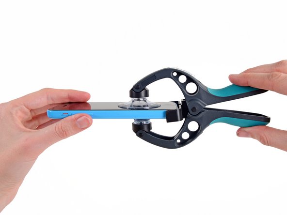

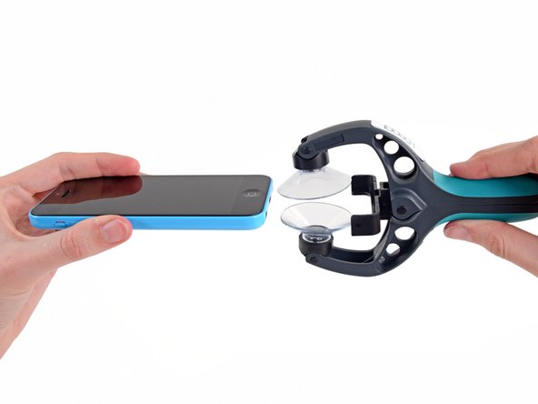

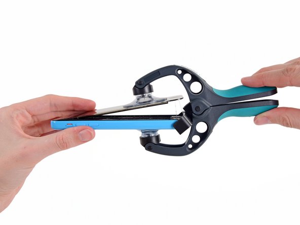

    3. iPhone 5c LCD and Digitizer Replacement, Starting the iSclack Opening Procedure: step 3, image 1 of 3 iPhone 5c LCD and Digitizer Replacement, Starting the iSclack Opening Procedure: step 3, image 2 of 3 iPhone 5c LCD and Digitizer Replacement, Starting the iSclack Opening Procedure: step 3, image 3 of 3
      • The next two steps demonstrate using the iSclack, a great tool for safely opening the iPhone 5c that we recommend for anyone doing more than one repair on an iPhone 5, 5s, or 5c. If you aren't using the iSclack, skip to Step 5.
      • Close the handle on the iSclack, opening the suction-cup jaws.
      • Place the bottom of your iPhone in between the suction cups, against the plastic depth gauge.
      • The top suction cup should rest just above the home button.
      • Open the handles to close the jaws of the iSclack. Center the suction cups and press them firmly onto the top and bottom of the iPhone.

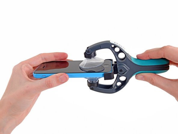

    4. iPhone 5c LCD and Digitizer Replacement, Finishing the iSclack Opening Procedure: step 4, image 1 of 2 iPhone 5c LCD and Digitizer Replacement, Finishing the iSclack Opening Procedure: step 4, image 2 of 2
      • Hold onto your iPhone securely and close the handle of the iSclack to separate the suction cups, pulling the front panel up from the rear case.
      • The iSclack is designed to safely open your iPhone just enough to separate the pieces, but not enough to damage any cables.
      • Peel the two suction cups off your iPhone.
      • Skip the next three steps and continue on to Step 8.

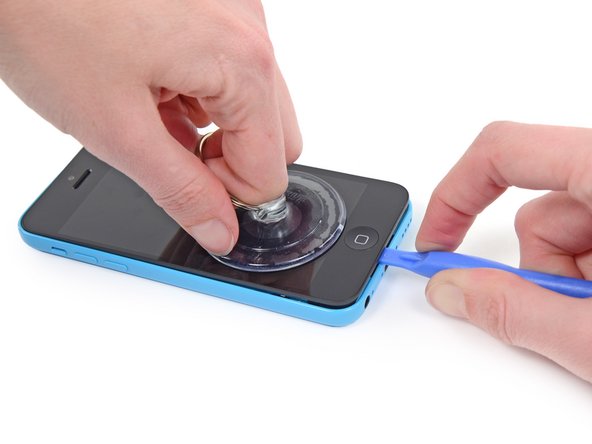

    5. iPhone 5c LCD and Digitizer Replacement, Manual Opening Procedure: step 5, image 1 of 1
      • Press a suction cup onto the screen, just above the home button.
      • Be sure the cup is completely on the screen to get a tight seal.
      Ask FixBot

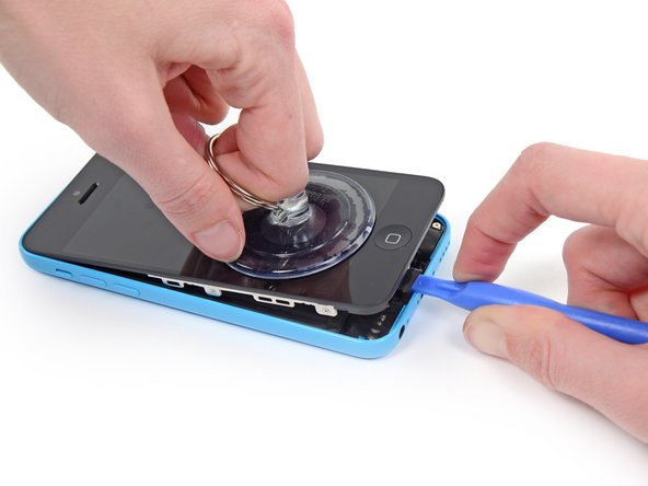

    6. iPhone 5c LCD and Digitizer Replacement, Start lifting the front panel assembly: step 6, image 1 of 2 iPhone 5c LCD and Digitizer Replacement, Start lifting the front panel assembly: step 6, image 2 of 2
      • Make sure the suction cup is firmly attached to the front panel assembly.
      • While holding the iPhone down with one hand, pull up on the suction cup to slightly separate the front panel assembly from the rear case.
      • Take your time and apply firm, constant force. The display assembly is a much tighter fit than most devices.
      • With a plastic opening tool, begin to gently pry the rear case down, away from the display assembly, while you pull up with the suction cup.
      • There are several clips attaching the front panel assembly to the rear case, so you may need to use a combination of the suction cup and plastic opening tool to free the front panel assembly.
      Ask FixBot

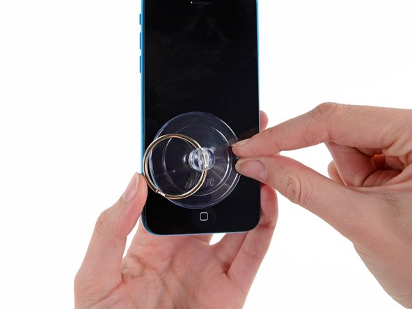

    7. iPhone 5c LCD and Digitizer Replacement: step 7, image 1 of 1
      • Pull the plastic nub to release the vacuum seal on the suction cup.
      • Remove the suction cup from the display assembly.
      Ask FixBot

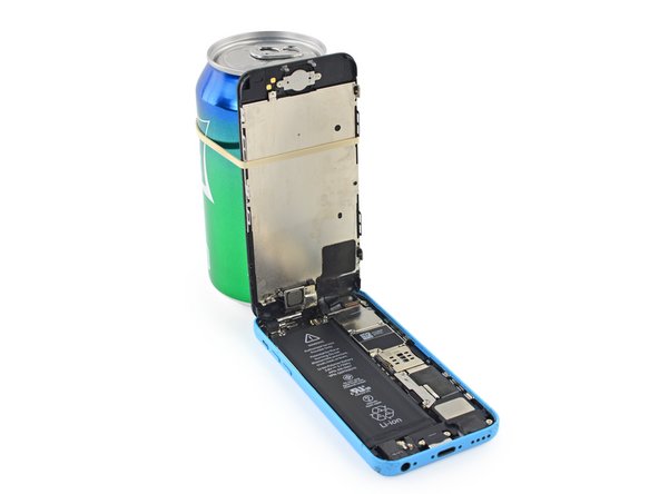

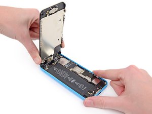

    8. iPhone 5c LCD and Digitizer Replacement, Opening up the phone: step 8, image 1 of 2 iPhone 5c LCD and Digitizer Replacement, Opening up the phone: step 8, image 2 of 2
      • Lift the home button end of the front panel up to gain access to the connectors near the top of the phone.
      • Open the display to about a 90º angle, and lean it against something to keep it propped up while you're working on the phone.
      • In a pinch, you can use an unopened canned beverage to hold the display.
      • Add a rubber band to keep the display securely in place while you work. This prevents undue strain on the display cables.
      Ask FixBot

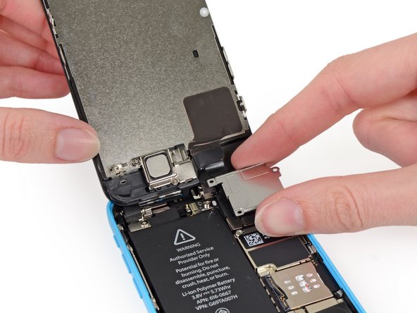

    13. iPhone 5c LCD and Digitizer Replacement: step 13, image 1 of 1
      • Remove the front panel assembly cable bracket from the logic board.
      Ask FixBot

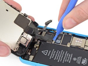

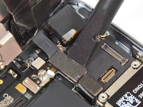

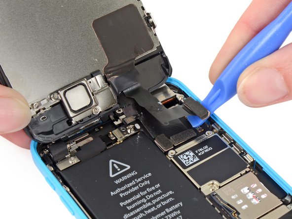

    14. iPhone 5c LCD and Digitizer Replacement, Disconnecting the front panel assembly cables: step 14, image 1 of 2 iPhone 5c LCD and Digitizer Replacement, Disconnecting the front panel assembly cables: step 14, image 2 of 2
      • Use a plastic opening tool or a fingernail to disconnect the front-facing camera and sensor cable connector.
      • Be sure to only pry up on the connector, and not on the socket on the logic board.
      Ask FixBot

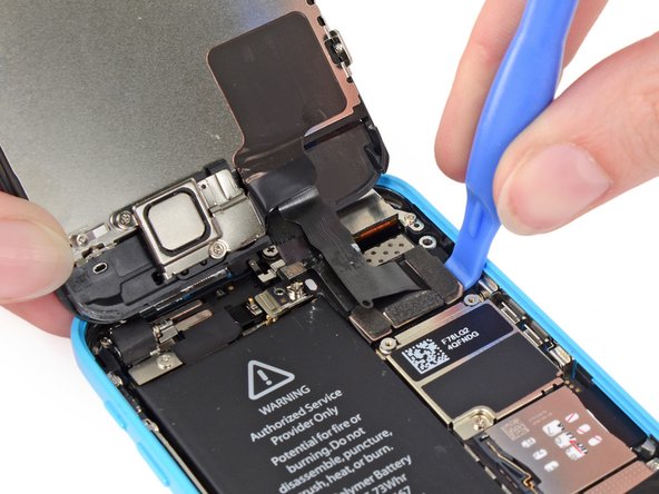

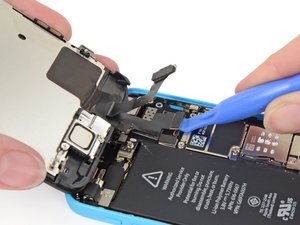

    15. iPhone 5c LCD and Digitizer Replacement: step 15, image 1 of 3 iPhone 5c LCD and Digitizer Replacement: step 15, image 2 of 3 iPhone 5c LCD and Digitizer Replacement: step 15, image 3 of 3
      • Make sure the battery is disconnected before you disconnect or reconnect the cables in this step.
      • Use a plastic opening tool or a fingernail to disconnect the LCD cable connector.
      • The LCD and Digitizer connectors are on the same cable assembly, so prying the LCD connector up should disconnect both connectors. Double check that the two cables are fully disconnected before removing the display.
      • When reassembling your phone, the LCD cable may pop off its connector. A blank screen, or white lines on the display could be caused by a loose connection. Should this happen, reconnect the cable and power cycle your phone. The best way to power cycle your phone is to disconnect and reconnect the battery.

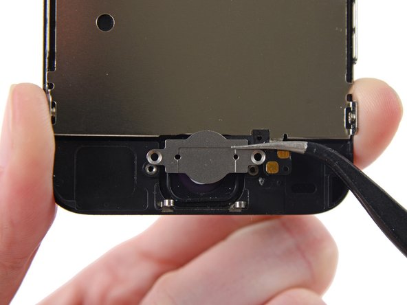

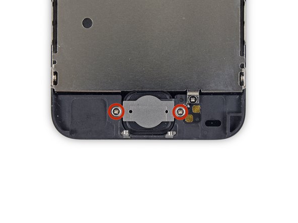

    1. iPhone 5c LCD and Digitizer Replacement, Home Button Ribbon Cable: step 17, image 1 of 1
      • Remove the two 1.3 mm Phillips #000 screws securing the home button bracket to the display assembly.
      Ask FixBot

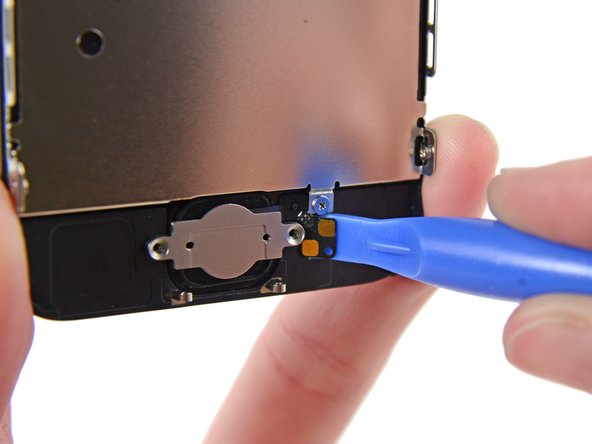

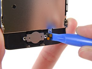

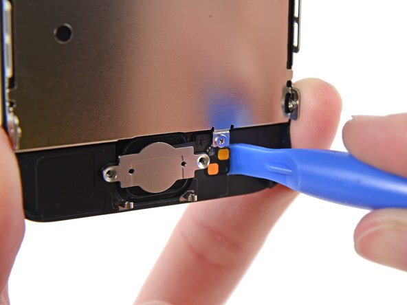

    2. iPhone 5c LCD and Digitizer Replacement: step 18, image 1 of 2 iPhone 5c LCD and Digitizer Replacement: step 18, image 2 of 2
      • Use a plastic opening tool to pry the edge of the home button ribbon cable up from the display assembly.
      • Start under the contact points on the right and work to the left.
      • Starting from the left and going right may rip your ribbon cable. The contacts are well adhered to the front panel and should be peeled up first.
      • If you have trouble sliding the plastic opening tool under the contact points, flip the tool over and gently push against the right side of the contact cable to loosen the adhesive, then try again.
      Ask FixBot

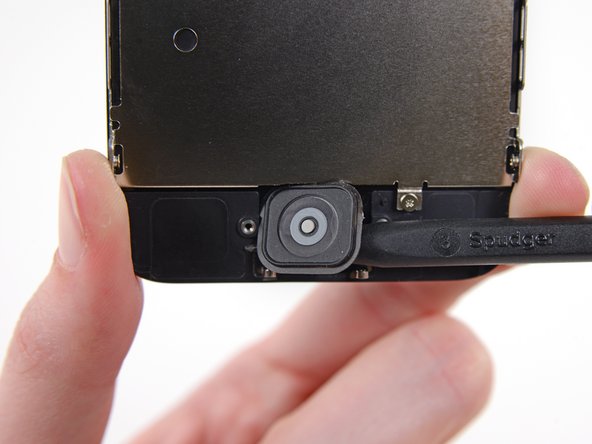

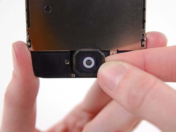

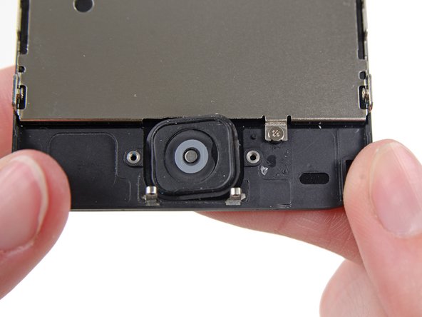

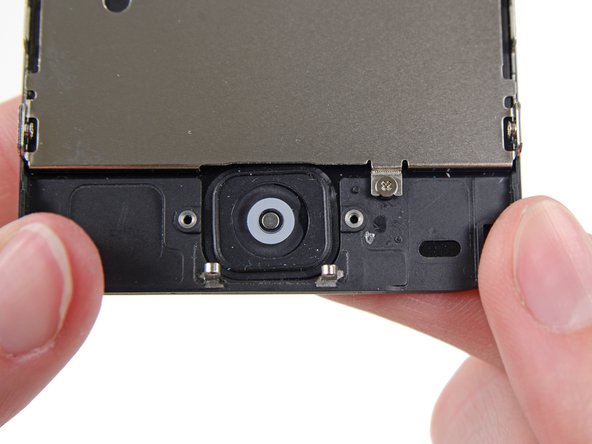

    1. iPhone 5c LCD and Digitizer Replacement, Home Button: step 20, image 1 of 2 iPhone 5c LCD and Digitizer Replacement, Home Button: step 20, image 2 of 2
      • Gently push the top right corner of the home button up away from the front panel.
      • Do not push the home button all the way through; you only need to get a corner free so that you can pry it out with a spudger.
      • This membrane is very thin. If you feel like you are going to tear the button, apply heat and try again.

    2. iPhone 5c LCD and Digitizer Replacement: step 21, image 1 of 1
      • Peel the home button the rest of the way off of the display by prying gently with a spudger.
      Ask FixBot

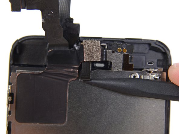

    2. iPhone 5c LCD and Digitizer Replacement: step 24, image 1 of 2 iPhone 5c LCD and Digitizer Replacement: step 24, image 2 of 2
      • Use the flat edge of a spudger to push the earpiece speaker bracket off the display assembly.
      Ask FixBot
    3. iPhone 5c LCD and Digitizer Replacement: step 25, image 1 of 1
      • Remove the earpiece speaker from the iPhone.
      Ask FixBot

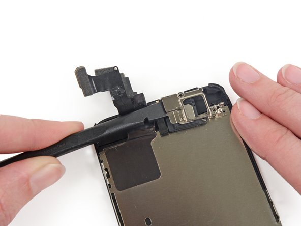

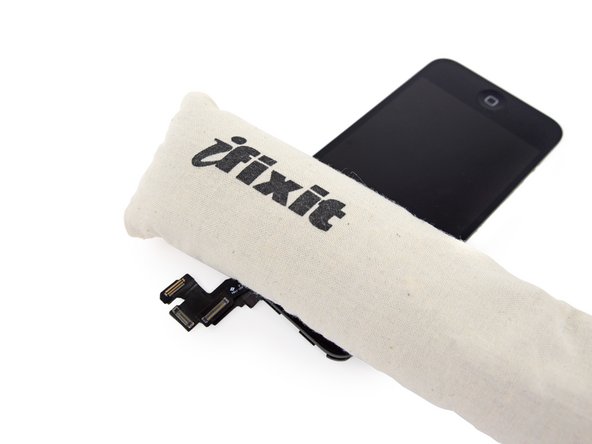

    1. iPhone 5c LCD and Digitizer Replacement, Front-Facing Camera and Sensor Cable: step 26, image 1 of 1
      Tool used on this step:
      iOpener
      $24.95
      Buy
      • The front-facing camera and sensor cable is adhered to the display assembly with mild adhesive.
      • Using an iOpener to soften the adhesive will help safely remove it. Follow our iOpener instructions to use it.
      • While this step is not required, it will decrease the chances of damaging the delicate cable assembly.
      Ask FixBot

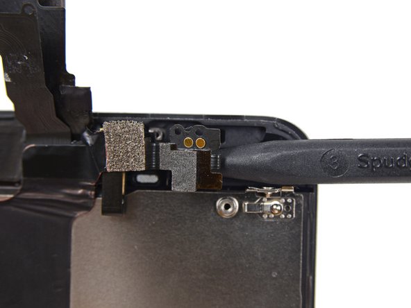

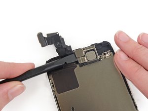

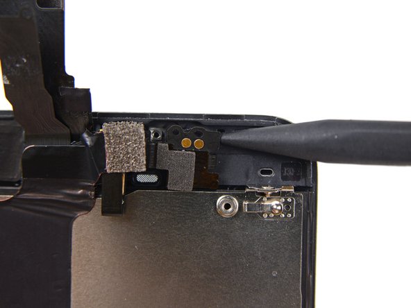

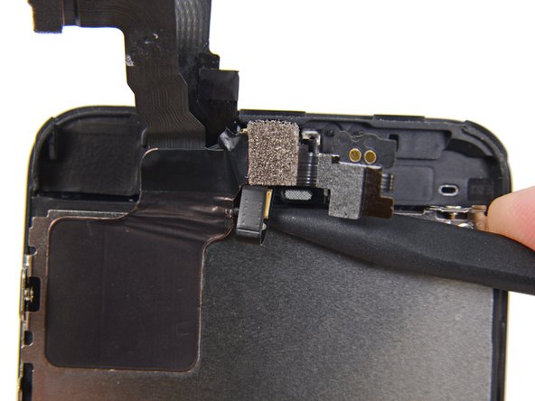

    2. iPhone 5c LCD and Digitizer Replacement: step 27, image 1 of 2 iPhone 5c LCD and Digitizer Replacement: step 27, image 2 of 2
      • Using the pointed end of a spudger, gently pry the earpiece speaker contact cable up, to separate this portion of the camera and sensor cable from the adhesive below.
      • There is a small, square, plastic and metal holder for the proximity sensor. This holder is essential for the proximity sensor to function correctly.
      • If replacing the proximity sensor make sure that the holder remains adhered to the back of the display. If it comes off with the old proximity sensor, remove it from the old sensor and use a tiny bit of adhesive to re-attach it to the back of the display.
      Ask FixBot

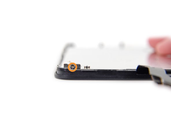

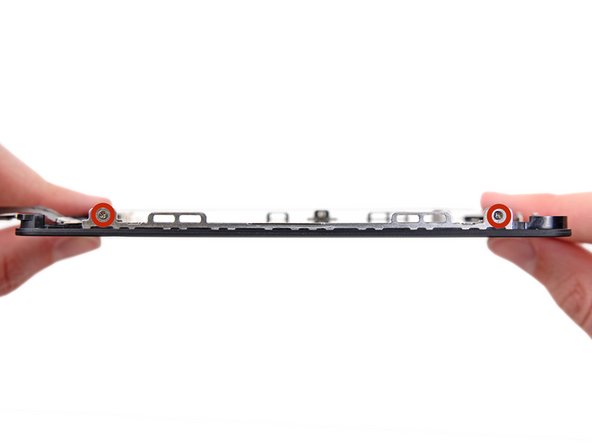

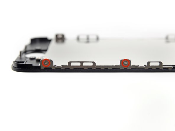

    1. iPhone 5c LCD and Digitizer Replacement, LCD and Digitizer: step 29, image 1 of 2 iPhone 5c LCD and Digitizer Replacement, LCD and Digitizer: step 29, image 2 of 2
      • Remove two 1.2 mm Phillips #000 screws from each side of the LCD frame (four total).
      Ask FixBot

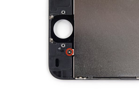

    2. iPhone 5c LCD and Digitizer Replacement: step 30, image 1 of 2 iPhone 5c LCD and Digitizer Replacement: step 30, image 2 of 2
      • Remove the 1.6 mm Phillips #000 screws from the LCD shield plate.
      • One at bottom of the display assembly near the home button opening
      • One at the top of the display near the cables

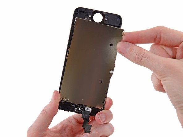

    3. iPhone 5c LCD and Digitizer Replacement: step 31, image 1 of 1
      • Remove the LCD shield plate from the display assembly.
      Ask FixBot
