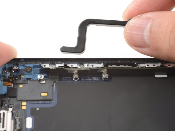

    6. iPhone 17 Pro Max USB-C Port Assembly Replacement, Screen information: step 9, image 1 of 3 iPhone 17 Pro Max USB-C Port Assembly Replacement, Screen information: step 9, image 2 of 3 iPhone 17 Pro Max USB-C Port Assembly Replacement, Screen information: step 9, image 3 of 3
      • Don't insert your pick more than 3 mm under the screen to avoid damaging the following components:
      • The screen and ambient light sensor cables are located near the volume and Action buttons.
      • There are delicate spring contacts around the perimeter of the phone.
      • The underside of the screen has thin, metal clips that go into corresponding slots on the frame.
      Ask FixBot

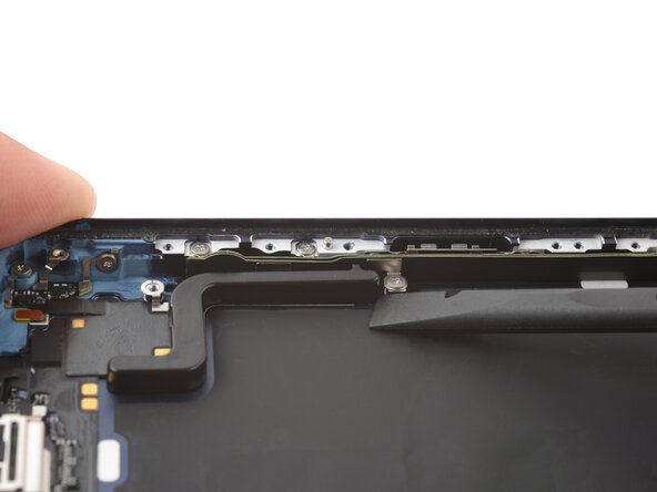

    15. iPhone 17 Pro Max USB-C Port Assembly Replacement, Prop up the screen: step 18, image 1 of 3 iPhone 17 Pro Max USB-C Port Assembly Replacement, Prop up the screen: step 18, image 2 of 3 iPhone 17 Pro Max USB-C Port Assembly Replacement, Prop up the screen: step 18, image 3 of 3
      • At this point, the screen should be completely detached from the frame. If it feels stuck, go back around the perimeter and separate any remaining adhesive or clips.
      • Lift the screen straight up and swing it over the left edge, propping it up against a sturdy box or stack of books so the cables aren't strained.
      • Alternatively, you can lay the screen down flat over the left side.
      Ask FixBot

    1. iPhone 17 Pro Max USB-C Port Assembly Replacement, Install the battery: step 86, image 1 of 2 iPhone 17 Pro Max USB-C Port Assembly Replacement, Install the battery: step 86, image 2 of 2
      • Lay the battery tray in place.
      • Make sure not to trap any cables underneath the tray.
      Ask FixBot
