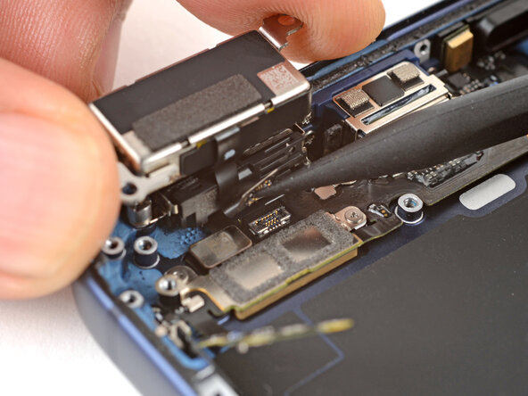

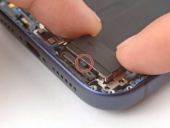

    6. iPhone 17 Pro Max Taptic Engine Replacement: step 34, image 1 of 3 iPhone 17 Pro Max Taptic Engine Replacement: step 34, image 2 of 3 iPhone 17 Pro Max Taptic Engine Replacement: step 34, image 3 of 3
      • Use your fingers to flip the Taptic Engine out of its recess and onto the edge of the iPhone.
      • Hold onto the Taptic Engine during the next step to prevent straining its cable.
      Ask FixBot

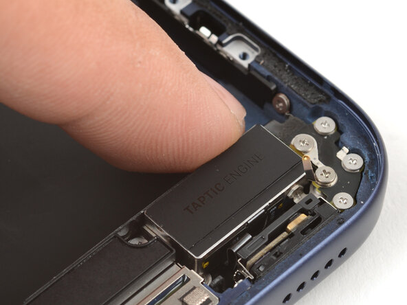

    7. iPhone 17 Pro Max Taptic Engine Replacement: step 35, image 1 of 2 iPhone 17 Pro Max Taptic Engine Replacement: step 35, image 2 of 2
      • Use the point of a spudger to pry up the Taptic Engine press connector and disconnect it.
      Ask FixBot
    8. iPhone 17 Pro Max Taptic Engine Replacement: step 36, image 1 of 1
      • Remove the Taptic Engine.

    1. iPhone 17 Pro Max Taptic Engine Replacement, Install the Taptic Engine: step 38, image 1 of 1
      • Place the Taptic Engine upside down on the edge of the iPhone frame.
      • While holding the Taptic Engine with one hand, use your finger to press and connect the Taptic Engine press connector.

    2. iPhone 17 Pro Max Taptic Engine Replacement: step 39, image 1 of 3 iPhone 17 Pro Max Taptic Engine Replacement: step 39, image 2 of 3 iPhone 17 Pro Max Taptic Engine Replacement: step 39, image 3 of 3
      • Flip the Taptic Engine over the frame and align it using its screw holes.
      • The Taptic Engine flex cable should fold neatly between the Taptic Engine and the frame.
