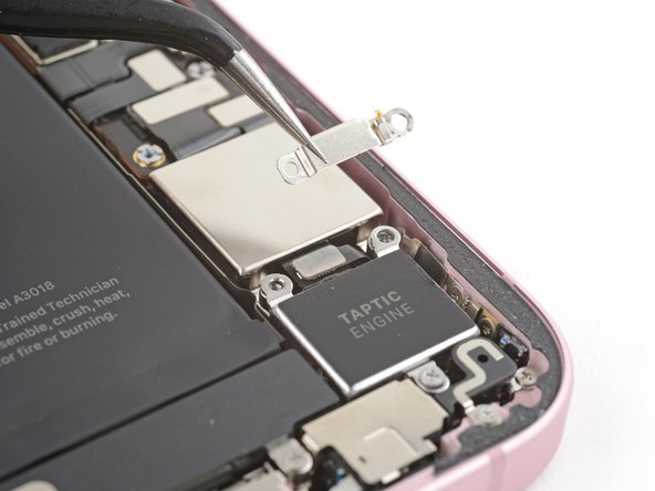

    1. iPhone 15 Taptic Engine Replacement, Remove the Taptic Engine connector cover: step 25, image 1 of 3 iPhone 15 Taptic Engine Replacement, Remove the Taptic Engine connector cover: step 25, image 2 of 3 iPhone 15 Taptic Engine Replacement, Remove the Taptic Engine connector cover: step 25, image 3 of 3
      • Use your Phillips #000 driver to remove the two 1.9 mm‑long screws securing the Taptic Engine press connector cover.
      • Remove the cover.
      Ask FixBot

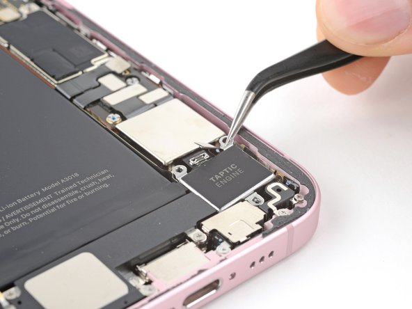

    2. iPhone 15 Taptic Engine Replacement, Disconnect the Taptic Engine: step 26, image 1 of 2 iPhone 15 Taptic Engine Replacement, Disconnect the Taptic Engine: step 26, image 2 of 2
      • Use the point of your spudger to pry up and disconnect the Taptic Engine press connector.
      Ask FixBot
    3. iPhone 15 Taptic Engine Replacement, Unfasten the Taptic Engine: step 27, image 1 of 1
      • Use your Phillips #000 driver to remove the 1.9 mm‑long screw securing the Taptic Engine.
      Ask FixBot
    4. iPhone 15 Taptic Engine Replacement, Remove the Taptic Engine: step 28, image 1 of 2 iPhone 15 Taptic Engine Replacement, Remove the Taptic Engine: step 28, image 2 of 2
      Tool used on this step:
      Buy
      • Use tweezers or your fingers to remove the Taptic Engine.

    4. iPhone 15 Taptic Engine Replacement, Apply the adhesive: step 38, image 1 of 3 iPhone 15 Taptic Engine Replacement, Apply the adhesive: step 38, image 2 of 3 iPhone 15 Taptic Engine Replacement, Apply the adhesive: step 38, image 3 of 3
      • Once the adhesive is pressed into place, you can't reposition it—you'll have to remove it and start over with new adhesive.
      • Use the pull tab to begin peeling the back liner off the adhesive starting from the bottom, but don't remove the liner all the way.
      • Hold the liner out of the way and align the adhesive with the bottom edge of the iPhone.
      • Lay the bottom edge of the adhesive into its recess in the frame, making sure the iPhone's spring contacts are aligned with their cutouts in the liner.
      Ask FixBot
    5. iPhone 15 Taptic Engine Replacement: step 39, image 1 of 3 iPhone 15 Taptic Engine Replacement: step 39, image 2 of 3 iPhone 15 Taptic Engine Replacement: step 39, image 3 of 3
      • When the adhesive is aligned, use the flat end of a spudger or your finger to press it down firmly along the bottom edge.
      Ask FixBot
    6. iPhone 15 Taptic Engine Replacement: step 40, image 1 of 3 iPhone 15 Taptic Engine Replacement: step 40, image 2 of 3 iPhone 15 Taptic Engine Replacement: step 40, image 3 of 3
      • Continue peeling the back liner off of the adhesive while pressing the adhesive into place along the edges of the iPhone's frame.
      • If you correctly aligned the lower edge of the adhesive, the side and top edges will fall perfectly into place. If the adhesive is misaligned, remove it and start over with new adhesive.
      • If your adhesive is misaligned and you don't have another set handy, it's okay to temporarily put your iPhone back together and use it normally without any adhesive, but keep in mind that your iPhone's water resistance will be compromised until you install new adhesive.
      Ask FixBot
    7. iPhone 15 Taptic Engine Replacement, Press the adhesive into place: step 41, image 1 of 3 iPhone 15 Taptic Engine Replacement, Press the adhesive into place: step 41, image 2 of 3 iPhone 15 Taptic Engine Replacement, Press the adhesive into place: step 41, image 3 of 3
      • Make sure the liner is aligned properly by checking that all spring contacts and the rear camera are in their cutouts. If they aren't, remove the adhesive and start over with a new sheet.
      • Use the flat end of a spudger to press the adhesive into place around the perimeter of the frame.
      • Be careful not to touch the spring contacts sticking through the pink liner.
      Ask FixBot
    8. iPhone 15 Taptic Engine Replacement, Remove the top liner: step 42, image 1 of 3 iPhone 15 Taptic Engine Replacement, Remove the top liner: step 42, image 2 of 3 iPhone 15 Taptic Engine Replacement, Remove the top liner: step 42, image 3 of 3
      • Remove the top adhesive liner.
      • Depending on your adhesive, your liner might be split into multiple parts or be a single piece.
      Ask FixBot
    9. iPhone 15 Taptic Engine Replacement, Prop up the back glass: step 43, image 1 of 3 iPhone 15 Taptic Engine Replacement, Prop up the back glass: step 43, image 2 of 3 iPhone 15 Taptic Engine Replacement, Prop up the back glass: step 43, image 3 of 3
      • Prop up the back glass along the right edge of the iPhone, using a box or similar sturdy object to support the screen.
      • Use the flat end of a spudger or your finger to connect the wireless charging coil press connector, then the battery press connector.
      Ask FixBot
    10. iPhone 15 Taptic Engine Replacement, Place the middle connector cover: step 44, image 1 of 2 iPhone 15 Taptic Engine Replacement, Place the middle connector cover: step 44, image 2 of 2
      • Place the middle connector cover over the wireless charging coil press connector so it slightly overhangs the slot on the logic board for the bottom clip.
      Ask FixBot
    11. iPhone 15 Taptic Engine Replacement: step 45, image 1 of 2 iPhone 15 Taptic Engine Replacement: step 45, image 2 of 2
      • Use your finger to press the cover down on the logic board.
      • While pressing it down, slide the cover upward so both metal clips slot into their spots in the logic board.
      Ask FixBot
    12. iPhone 15 Taptic Engine Replacement, Place the lower connector cover: step 46, image 1 of 3 iPhone 15 Taptic Engine Replacement, Place the lower connector cover: step 46, image 2 of 3 iPhone 15 Taptic Engine Replacement, Place the lower connector cover: step 46, image 3 of 3
      • Use tweezers to hook the top of the lower connector cover into its slot on the logic board.
      • Lay the lower connector cover over the press connectors.
      Ask FixBot
    13. iPhone 15 Taptic Engine Replacement, Install the cover screws: step 47, image 1 of 2 iPhone 15 Taptic Engine Replacement, Install the cover screws: step 47, image 2 of 2
      • Use a tri-point Y000 screwdriver to install the 0.9 mm‑long screw securing the middle connector cover.
      • Use a tri-point Y000 screwdriver to install the two 1.3 mm‑long screws securing the lower connector cover.
      Ask FixBot
    14. iPhone 15 Taptic Engine Replacement, Remove the final adhesive liners: step 48, image 1 of 2 iPhone 15 Taptic Engine Replacement, Remove the final adhesive liners: step 48, image 2 of 2
      • Use tweezers or your fingers to separate the pull tabs at the bottom of the frame, near the charging port.
      Ask FixBot
    15. iPhone 15 Taptic Engine Replacement: step 49, image 1 of 3 iPhone 15 Taptic Engine Replacement: step 49, image 2 of 3 iPhone 15 Taptic Engine Replacement: step 49, image 3 of 3
      • Remove the narrow liner covering the adhesive along the left and top edges of the frame.
      Ask FixBot
    16. iPhone 15 Taptic Engine Replacement: step 50, image 1 of 3 iPhone 15 Taptic Engine Replacement: step 50, image 2 of 3 iPhone 15 Taptic Engine Replacement: step 50, image 3 of 3
      • Hold the back glass over the phone without letting it touch the adhesive, so you can access the remaining liners along the right edge of the phone.
      • Use a pair of tweezers or your fingers to remove the remaing liners along the right edge of the phone.
      Ask FixBot
    17. iPhone 15 Taptic Engine Replacement, Install the back glass: step 51, image 1 of 3 iPhone 15 Taptic Engine Replacement, Install the back glass: step 51, image 2 of 3 iPhone 15 Taptic Engine Replacement, Install the back glass: step 51, image 3 of 3
      • Lay the back glass straight down onto the frame and press until the clips engage.
      • Press around the perimeter of the back glass to engage all the clips.
      Ask FixBot
    18. iPhone 15 Taptic Engine Replacement, Install the pentalobe screws: step 52, image 1 of 2 iPhone 15 Taptic Engine Replacement, Install the pentalobe screws: step 52, image 2 of 2
      • Use a P2 pentalobe driver to install the two 7.7 mm‑long screws on either side of the charging port.
      Ask FixBot
    19. iPhone 15 Taptic Engine Replacement, Heat the back glass: step 53, image 1 of 2 iPhone 15 Taptic Engine Replacement, Heat the back glass: step 53, image 2 of 2
      • To help the adhesive bond, apply heat to the edges of the back glass using an iOpener, hair dryer, or heat gun until it's hot to the touch.
      • Firmly press around the perimeter of the back glass. If you have screen vise clamps, use them to strengthen the bond of your new adhesive. If not, keep reading for more ways to secure the back glass.
      Ask FixBot
    20. iPhone 15 Taptic Engine Replacement, Press the back glass: step 54, image 1 of 3 iPhone 15 Taptic Engine Replacement, Press the back glass: step 54, image 2 of 3 iPhone 15 Taptic Engine Replacement, Press the back glass: step 54, image 3 of 3
      • To evenly compress your iPhone and strengthen the bond of the back glass to the frame, you need to account for the camera bump.
      • If you have the box your iPhone came in, take the lid and place it on a flat surface.
      • If you don't have your original box, skip this step for an alternate method.
      • Place your iPhone screen-side-up in the lid of your box with the camera bump in its recess.
      • Find something close to the size of your iPhone, but taller than the sides of the box. Stack it on top of the iPhone, followed by a few heavy objects.
      • Leave the objects in place for at least thirty minutes. The lighter the objects, the longer they should be left. Ideally, leave them stacked overnight.
      Ask FixBot
    21. iPhone 15 Taptic Engine Replacement: step 55, image 1 of 2 iPhone 15 Taptic Engine Replacement: step 55, image 2 of 2
      • If you don't have the original box for your iPhone, follow the next three steps for another method to evenly compress the back glass.
      • Place the iPhone screen-side-down on a soft, flat surface.
      • Apply tape to the back glass to protect its finish.
      Ask FixBot
    22. iPhone 15 Taptic Engine Replacement: step 56, image 1 of 3 iPhone 15 Taptic Engine Replacement: step 56, image 2 of 3 iPhone 15 Taptic Engine Replacement: step 56, image 3 of 3
      • Place evenly spaced layers of coins or similarly thick objects on the tape along the edges of the back glass.
      • Stack them to a consistent height taller than the camera bump.
      Ask FixBot
    23. iPhone 15 Taptic Engine Replacement: step 57, image 1 of 1
      • Stack multiple books or other heavy objects on your iPhone.
      • The coins may leave an impression on the bottom object, so don't use anything valuable.
      Ask FixBot
    1. iPhone 15 Taptic Engine Replacement, Install the pentalobe screws: step 58, image 1 of 2 iPhone 15 Taptic Engine Replacement, Install the pentalobe screws: step 58, image 2 of 2
