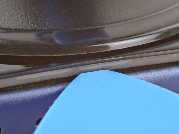

    1. iPhone 15 Pro Screen Replacement, Screen bezel information: step 5, image 1 of 3 iPhone 15 Pro Screen Replacement, Screen bezel information: step 5, image 2 of 3 iPhone 15 Pro Screen Replacement, Screen bezel information: step 5, image 3 of 3
      • During the next two steps, make sure you're inserting your pick in the correct location:
      • There's a plastic bezel on the underside of the screen that sits on the frame. Insert your pick here, making sure it's completely under the bezel.
      • There's a seam between the plastic bezel and the display panel. Don't insert your pick here or you'll separate the two, complicating the repair.

    2. iPhone 15 Pro Screen Replacement, Insert an opening pick: step 7, image 1 of 3 iPhone 15 Pro Screen Replacement, Insert an opening pick: step 7, image 2 of 3 iPhone 15 Pro Screen Replacement, Insert an opening pick: step 7, image 3 of 3
      • Apply a suction handle to the bottom edge of the screen.
      • Pull up on the handle with a strong, steady force to create a gap between the screen and the frame.
      • Insert the tip of an opening pick into the gap.
      Ask FixBot

    4. iPhone 15 Pro Screen Replacement, Separate the bottom edge adhesive: step 9, image 1 of 3 iPhone 15 Pro Screen Replacement, Separate the bottom edge adhesive: step 9, image 2 of 3 iPhone 15 Pro Screen Replacement, Separate the bottom edge adhesive: step 9, image 3 of 3
      • Don't insert your opening pick deeper than 3 mm along the bottom edge.
      • Slide your pick back and forth along the bottom edge to separate the adhesive.
      • Leave your pick inserted in the bottom right corner to prevent the adhesive from re-sealing.
      Ask FixBot
