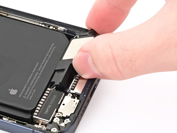

    2. iPhone 15 Pro Loudspeaker Replacement, Remove the loudspeaker: step 25, image 1 of 3 iPhone 15 Pro Loudspeaker Replacement, Remove the loudspeaker: step 25, image 2 of 3 iPhone 15 Pro Loudspeaker Replacement, Remove the loudspeaker: step 25, image 3 of 3
      • A plastic buffer is adhered to the top edges of the loudspeaker and Taptic Engine.
      • Lift the bottom edge of the loudspeaker until you can grab it with your fingers.
      • Peel the loudspeaker from the plastic buffer on its top edge and remove it.
