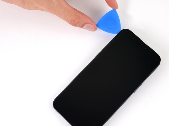

    4. iPhone 14 Screen Replacement, Insert an opening pick: step 6, image 1 of 3 iPhone 14 Screen Replacement, Insert an opening pick: step 6, image 2 of 3 iPhone 14 Screen Replacement, Insert an opening pick: step 6, image 3 of 3
      • Apply a suction handle near the bottom edge of the screen.
      • Pull up on the suction handle with firm, constant pressure to create a slight gap under the screen.
      • The adhesive holding the screen in place is very strong. If you're having a hard time, apply more heat, and gently rock the screen up and down to weaken the adhesive until you create enough of a gap to insert your tool.
      • Pull up on the suction cup with firm, constant pressure to create a slight gap between the screen and the frame.
      • Insert an opening pick beneath the screen and its plastic bezel.
      • Make sure to insert the opening pick under the thick plastic bezel to avoid damaging your screen. You should see a visual gap, and the pick shouldn't catch on anything. If you can't see the gap, you'll need to pull the screen up more.
      • If you can't create a gap, apply more heat to the edge and try again.

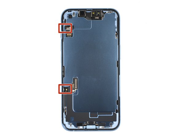

    15. iPhone 14 Screen Replacement, Disconnect the display connector: step 17, image 1 of 2 iPhone 14 Screen Replacement, Disconnect the display connector: step 17, image 2 of 2
      • Use the pointed end of a spudger to disconnect the display cable by prying the connector straight up from its socket.
      • To re-attach press connectors like this one, carefully align and press down on one side until it clicks into place, then repeat on the other side. Do not press down on the middle. If the connector is misaligned, the pins can bend, causing permanent damage.
      Ask FixBot
    16. iPhone 14 Screen Replacement, Unfasten the front sensor connector bracket: step 18, image 1 of 2 iPhone 14 Screen Replacement, Unfasten the front sensor connector bracket: step 18, image 2 of 2
      • Use a Y000 screwdriver to remove the 0.9 mm-long screw securing the front sensor connector bracket.
      Ask FixBot

    8. iPhone 14 Screen Replacement, Remove the front sensor assembly: step 30, image 1 of 3 iPhone 14 Screen Replacement, Remove the front sensor assembly: step 30, image 2 of 3 iPhone 14 Screen Replacement, Remove the front sensor assembly: step 30, image 3 of 3
      • At this point, the adhesive may have cooled down. If so, apply a heated iOpener to the assembly for one minute before continuing.
      • Insert an opening pick under the left side of the front sensor assembly.
      • Slide the pick under the assembly to separate it from the frame.

    9. iPhone 14 Screen Replacement: step 31, image 1 of 2 iPhone 14 Screen Replacement: step 31, image 2 of 2
      • Remove the front sensor assembly.
