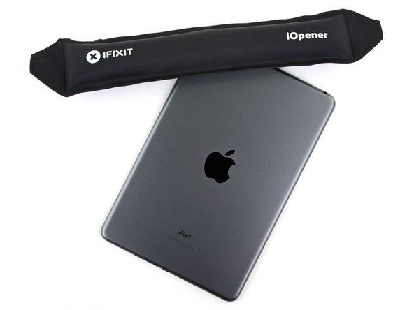

    4. iPad mini 5 Wi-Fi Power Button Cable Replacement: step 5, image 1 of 1
      • Reheat and reapply the iOpener to the left edge for a few minutes.
      • Be careful not to overheat the iOpener during the repair procedure. Always wait at least ten minutes before reheating the iOpener.

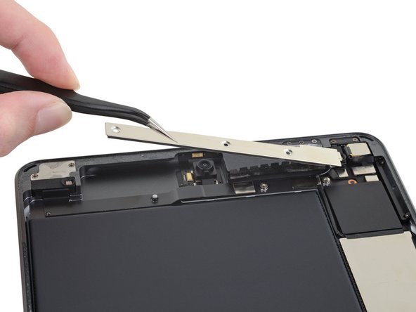

    1. iPad mini 5 Wi-Fi Power Button Cable Replacement, Disconnect the rear facing camera: step 36, image 1 of 2 iPad mini 5 Wi-Fi Power Button Cable Replacement, Disconnect the rear facing camera: step 36, image 2 of 2
      • Use the pointed end of a spudger to disconnect the rear facing camera press connector.
      Ask FixBot
    2. iPad mini 5 Wi-Fi Power Button Cable Replacement, Loosen the rear facing camera: step 37, image 1 of 2 iPad mini 5 Wi-Fi Power Button Cable Replacement, Loosen the rear facing camera: step 37, image 2 of 2
      • Apply one or two drops of high-concentration (90% or higher) isopropyl alcohol around the perimeter of the rear facing camera.
      • Wait two minutes for the isopropyl alcohol to weaken the adhesive underneath the rear facing camera.
      • Alternatively, you can heat an iOpener and apply it to the top left corner of the rear cover for two minutes to weaken the adhesive securing the rear facing camera.
      • A hair dryer, heat gun, or hot plate may also be used, but be careful not to overheat the iPad—the internal battery is susceptible to heat damage.
      Ask FixBot
    3. iPad mini 5 Wi-Fi Power Button Cable Replacement, Remove the rear facing camera: step 38, image 1 of 1
      Tool used on this step:
      Buy
      • Use a pair of tweezers to lift and remove the rear facing camera.

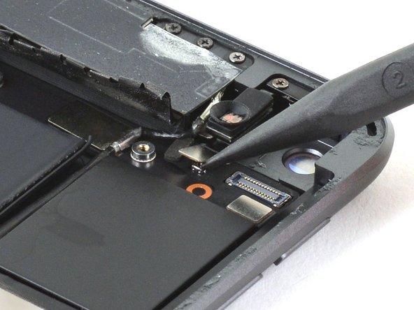

    1. iPad mini 5 Wi-Fi Power Button Cable Replacement, Disconnect the power button: step 39, image 1 of 2 iPad mini 5 Wi-Fi Power Button Cable Replacement, Disconnect the power button: step 39, image 2 of 2
      • Use the pointed end of a spudger to disconnect the power button press connector.

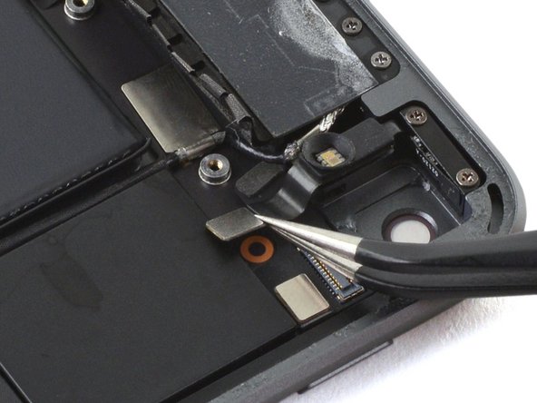

    2. iPad mini 5 Wi-Fi Power Button Cable Replacement, Pull the power button cable out: step 40, image 1 of 2 iPad mini 5 Wi-Fi Power Button Cable Replacement, Pull the power button cable out: step 40, image 2 of 2
      Buy
      • Use a pair of tweezers to pull the power button cable out from under the shelf.

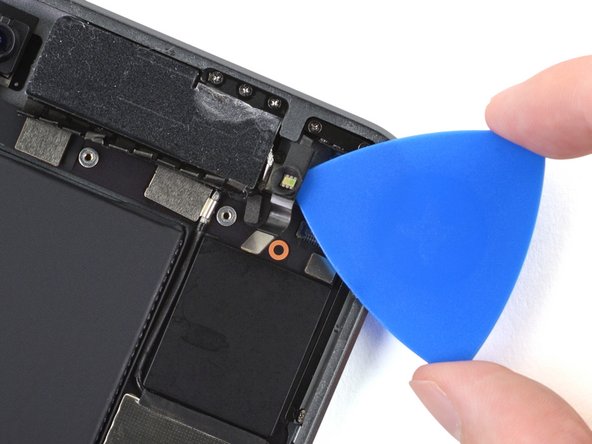

    4. iPad mini 5 Wi-Fi Power Button Cable Replacement, Detach the power button cable: step 42, image 1 of 2 iPad mini 5 Wi-Fi Power Button Cable Replacement, Detach the power button cable: step 42, image 2 of 2
      • Use an opening pick cut through the adhesive under the power button cable and detach it from the shelf.

    6. iPad mini 5 Wi-Fi Power Button Cable Replacement, Remove the power button bracket: step 44, image 1 of 2 iPad mini 5 Wi-Fi Power Button Cable Replacement, Remove the power button bracket: step 44, image 2 of 2
      • Use a pair of tweezers to remove the power button bracket.

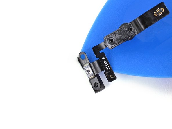

    7. iPad mini 5 Wi-Fi Power Button Cable Replacement, Remove the power button cable from the bracket: step 45, image 1 of 2 iPad mini 5 Wi-Fi Power Button Cable Replacement, Remove the power button cable from the bracket: step 45, image 2 of 2
      • Use an opening pick to cut through the adhesive securing the power button cable to the bracket.
      Ask FixBot
    8. iPad mini 5 Wi-Fi Power Button Cable Replacement: step 46, image 1 of 2 iPad mini 5 Wi-Fi Power Button Cable Replacement: step 46, image 2 of 2
      • Remove the power button cable from the bracket.
      • To install a new power button cable:
      • Remove any remaining adhesive and residue from the bracket.
      • If your part doesn't come with adhesive preinstalled:
      • Follow this guide if you are using a pre-cut adhesive card. Follow this guide if you are using custom-cut adhesives.
      • Place the power button cable onto the bracket and press firmly.
