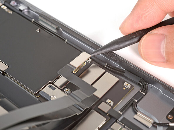

    3. iPad Air 6 13" Screen Replacement, Disconnect the screen: step 22, image 1 of 2 iPad Air 6 13" Screen Replacement, Disconnect the screen: step 22, image 2 of 2
      • Use the point of a spudger to pry up and disconnect one of the screen press connectors.
      Ask FixBot
    4. iPad Air 6 13" Screen Replacement: step 23, image 1 of 3 iPad Air 6 13" Screen Replacement: step 23, image 2 of 3 iPad Air 6 13" Screen Replacement: step 23, image 3 of 3
      • Use a spudger to pry and disconnect the remaining three screen press connectors.
