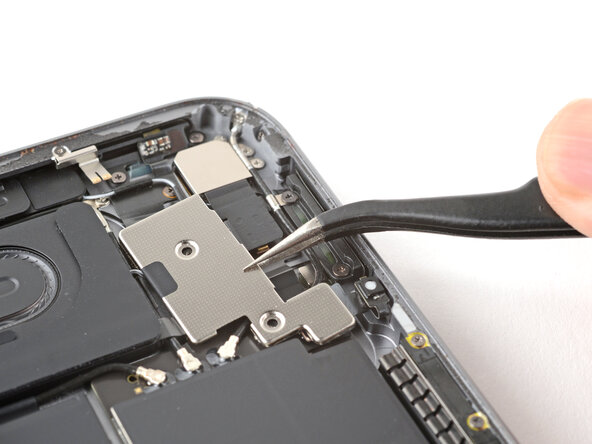

    1. iPad Air 6 13" Rear Camera Replacement, Remove the rear camera connector cover: step 20, image 1 of 1
      • Use a JIS 00 screwdriver to remove the two screws securing the rear camera connector cover:
      • One 2.0 mm‑long screw
      • One 1.2 mm‑long screw
      Ask FixBot
    2. iPad Air 6 13" Rear Camera Replacement: step 21, image 1 of 2 iPad Air 6 13" Rear Camera Replacement: step 21, image 2 of 2
      • Remove the rear camera connector cover.
      Ask FixBot
    3. iPad Air 6 13" Rear Camera Replacement, Remove the rear camera: step 22, image 1 of 2 iPad Air 6 13" Rear Camera Replacement, Remove the rear camera: step 22, image 2 of 2
      • Use the point of a spudger or a clean fingernail to pry up and disconnect the rear camera connector.
      • To reattach press connectors like this one, carefully align and press down on one side until it clicks into place, then repeat on the other side. Don't press down in the middle. If the connector is misaligned, the pins can bend, causing permanent damage.
      Ask FixBot
