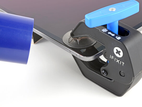

    1. iPad Air 6 13" Front Camera Replacement, Anti-Clamp instructions: step 3, image 1 of 3 iPad Air 6 13" Front Camera Replacement, Anti-Clamp instructions: step 3, image 2 of 3 iPad Air 6 13" Front Camera Replacement, Anti-Clamp instructions: step 3, image 3 of 3
      Tool used on this step:
      Clampy - Anti-Clamp
      $24.95
      Buy
      • The next three steps demonstrate the Anti-Clamp, a tool we designed to make the opening procedure easier. If you aren't using the Anti-Clamp, skip down three steps for an alternate method.
      • Pull the blue handle backwards to unlock the Anti-Clamp's arms.
      • Position the suction cups on the right edge near the volume buttons—one on the top and one on the bottom. Make sure the arms don't block the volume buttons.
      • Place an object under your iPad so it rests level between the suction cups.
      • Hold the bottom of the Anti-Clamp steady and firmly press down on the top cup to apply suction.

    2. iPad Air 6 13" Front Camera Replacement: step 4, image 1 of 3 iPad Air 6 13" Front Camera Replacement: step 4, image 2 of 3 iPad Air 6 13" Front Camera Replacement: step 4, image 3 of 3
      • Pull the blue handle forward to lock the arms.
      • Turn the handle clockwise 360 degrees or until the cups start to stretch.
      • Make sure the suction cups remain aligned with each other. If they begin to slip out of alignment, loosen the suction cups and realign the arms.

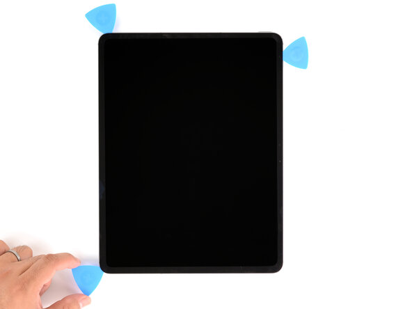

    9. iPad Air 6 13" Front Camera Replacement, Separate the left edge adhesive: step 11, image 1 of 3 iPad Air 6 13" Front Camera Replacement, Separate the left edge adhesive: step 11, image 2 of 3 iPad Air 6 13" Front Camera Replacement, Separate the left edge adhesive: step 11, image 3 of 3
      • Heat the left edge of the iPad until it's slightly too hot to touch.
      • Insert another opening pick under the top-left corner of the screen.
      • Slide the pick along the left edge to separate the adhesive.
      • Don't insert the pick deeper than 2 mm near the screen cables to avoid damaging the screen.
      • Leave the pick inserted in the corner to prevent the adhesive from resealing.

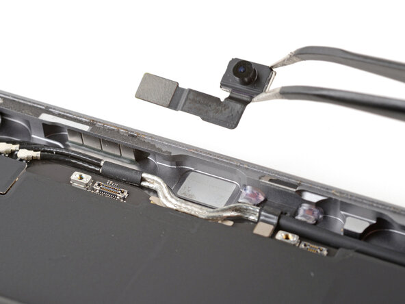

    3. iPad Air 6 13" Front Camera Replacement, Remove the front camera: step 22, image 1 of 2 iPad Air 6 13" Front Camera Replacement, Remove the front camera: step 22, image 2 of 2
      • Use the point of a spudger to pry up and disconnect the front camera connector.
      Ask FixBot
    4. iPad Air 6 13" Front Camera Replacement: step 23, image 1 of 2 iPad Air 6 13" Front Camera Replacement: step 23, image 2 of 2
      • Remove the front camera.
