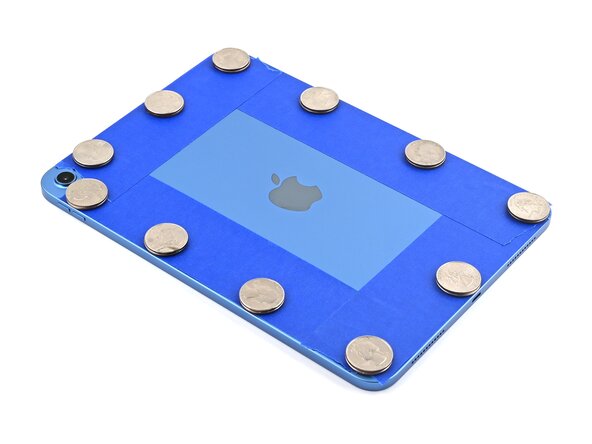

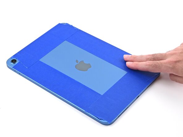

    1. iPad 10 Battery Replacement, Cracked glass preparation: step 2, image 1 of 1
      • If the iPad has a cracked digitizer, follow this step.
      • Wear safety glasses to protect your eyes from any glass shaken free during the repair.
      • Apply strips of packing tape to the cracked glass until the whole digitizer is covered—this will help keep the glass contained and allow the suction cup to stick to it.
      • Make sure there's a single strip (not overlapping) of tape across the bottom edge, big enough for a suction cup to fit on.
      • Only cover the glass itself—don't stick any tape to the frame.

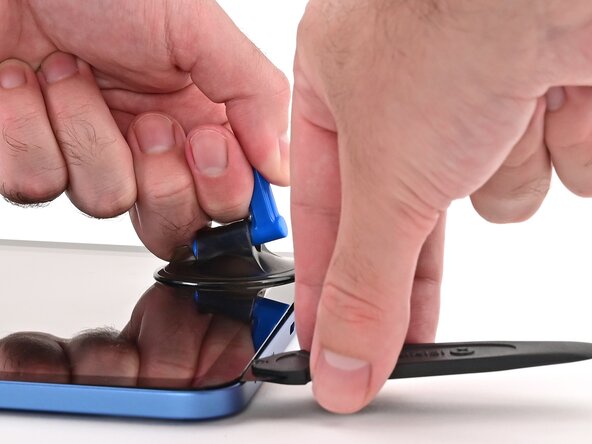

    3. iPad 10 Battery Replacement, Insert the opening wheel: step 4, image 1 of 3 iPad 10 Battery Replacement, Insert the opening wheel: step 4, image 2 of 3 iPad 10 Battery Replacement, Insert the opening wheel: step 4, image 3 of 3
      • Apply a suction handle above the USB‑C port with the open part of the handle facing away from the edge.
      • Pull up on the suction handle with firm, constant pressure to create a slight gap under the glass.
      • Insert an opening wheel into the gap.
      • The adhesive holding the glass in place is very strong. If you're having a hard time, be patient, apply more heat, and try again.

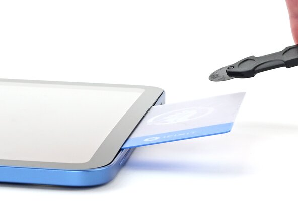

    9. iPad 10 Battery Replacement, Insert a plastic card: step 10, image 1 of 3 iPad 10 Battery Replacement, Insert a plastic card: step 10, image 2 of 3 iPad 10 Battery Replacement, Insert a plastic card: step 10, image 3 of 3
      • Insert a plastic card underneath the right edge of the glass to keep the adhesive separated.
      • Remove the opening wheel.

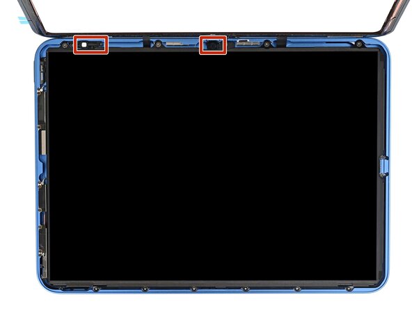

    12. iPad 10 Battery Replacement, Separate the top edge adhesive: step 13, image 1 of 3 iPad 10 Battery Replacement, Separate the top edge adhesive: step 13, image 2 of 3 iPad 10 Battery Replacement, Separate the top edge adhesive: step 13, image 3 of 3
      • Be very careful with this step. Don't insert the opening wheel deeper than 2 mm along the top edge to avoid damaging the digitizer cables, but don't use it at an angle.
      • Repeat the heating and adhesive separation process to separate the adhesive along the top edge.

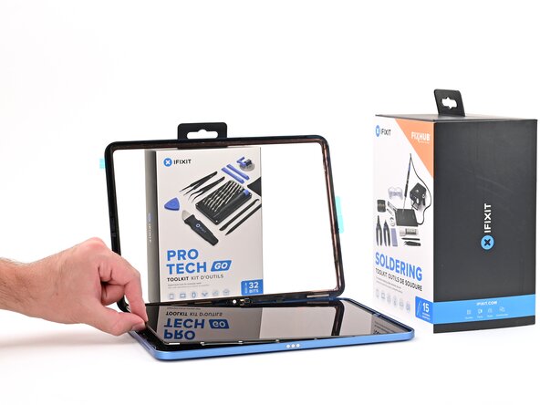

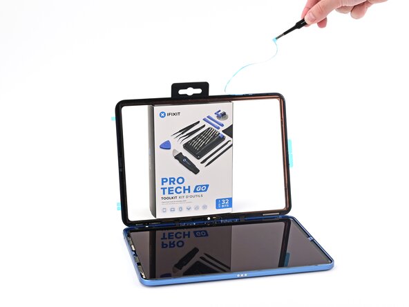

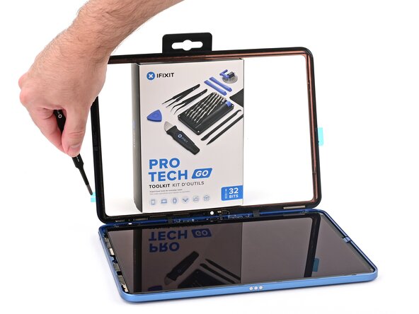

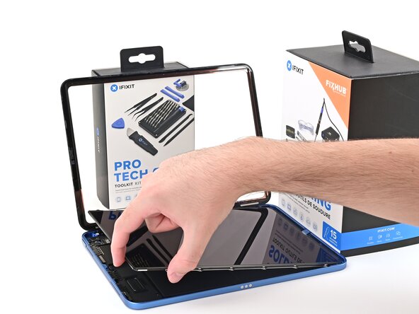

    13. iPad 10 Battery Replacement, Lift the digitizer: step 14, image 1 of 3 iPad 10 Battery Replacement, Lift the digitizer: step 14, image 2 of 3 iPad 10 Battery Replacement, Lift the digitizer: step 14, image 3 of 3
      • The digitizer is still connected to the iPad with three ribbon cables. Don't try to fully remove it yet.
      • Try not to touch the back side of the digitizer or the surface of the display with your fingers—any fingerprints can be tough to clean off.
      • Lift the digitizer by its bottom edge and swing it open until it's perpendicular to the iPad.
      • Rest the digitizer on a strong, sturdy object to keep it held up while you remove the display.

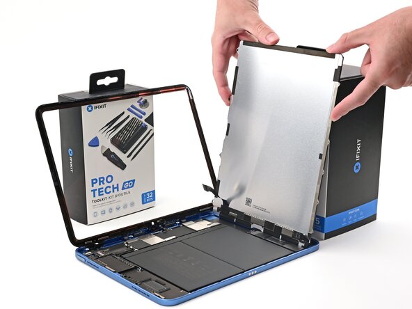

    15. iPad 10 Battery Replacement, Lift the display: step 16, image 1 of 2 iPad 10 Battery Replacement, Lift the display: step 16, image 2 of 2
      • Insert the flat end of a spudger beneath the display in the center of its left edge.
      • Pry up the display until you can get your fingers beneath it.
      Ask FixBot
    16. iPad 10 Battery Replacement: step 17, image 1 of 2 iPad 10 Battery Replacement: step 17, image 2 of 2
      • Lift the display by its screw posts until it's perpendicular to the iPad. Rest it on a sturdy object.
      Ask FixBot

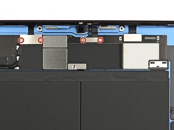

    1. iPad 10 Battery Replacement, Remove the digitizer connector covers: step 22, image 1 of 1
      • Use a JIS 00 screwdriver to remove the four 1.1 mm‑long screws securing the digitizer connector covers.
      Ask FixBot
    2. iPad 10 Battery Replacement: step 23, image 1 of 3 iPad 10 Battery Replacement: step 23, image 2 of 3 iPad 10 Battery Replacement: step 23, image 3 of 3
      • Use tweezers or your fingers to remove the two digitizer connector covers.

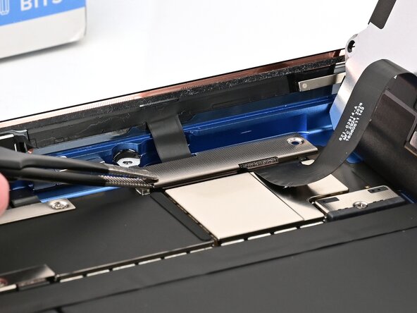

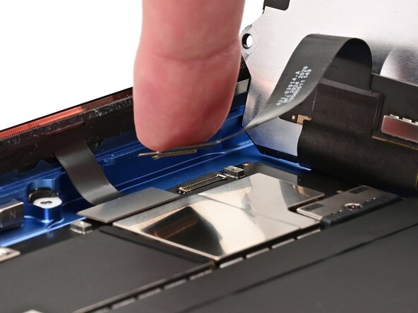

    3. iPad 10 Battery Replacement, Disconnect the digitizer: step 24, image 1 of 3 iPad 10 Battery Replacement, Disconnect the digitizer: step 24, image 2 of 3 iPad 10 Battery Replacement, Disconnect the digitizer: step 24, image 3 of 3
      • Use the flat end of a spudger to disconnect the three digitizer cable press connectors.

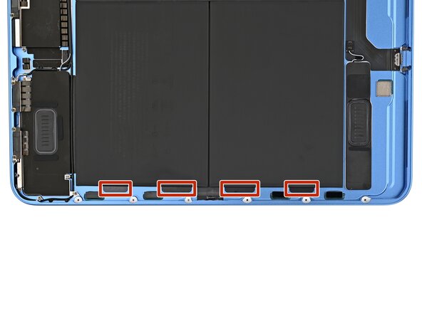

    2. iPad 10 Battery Replacement, Remove the battery adhesive: step 27, image 1 of 3 iPad 10 Battery Replacement, Remove the battery adhesive: step 27, image 2 of 3 iPad 10 Battery Replacement, Remove the battery adhesive: step 27, image 3 of 3
      • Use a pair of blunt tweezers to grab one of the four stretch-release adhesive strips under the battery.
      Ask FixBot
    3. iPad 10 Battery Replacement: step 28, image 1 of 2 iPad 10 Battery Replacement: step 28, image 2 of 2
      • Pull the adhesive pull tab away from the battery, and roll the tweezers to wrap the adhesive around them.
      Ask FixBot
    4. iPad 10 Battery Replacement: step 29, image 1 of 3 iPad 10 Battery Replacement: step 29, image 2 of 3 iPad 10 Battery Replacement: step 29, image 3 of 3
      • Slowly pull the adhesive out, keeping it as close to the iPad as possible without touching it.
      Ask FixBot
    5. iPad 10 Battery Replacement, Remove the remaining stretch‑release strips: step 30, image 1 of 3 iPad 10 Battery Replacement, Remove the remaining stretch‑release strips: step 30, image 2 of 3 iPad 10 Battery Replacement, Remove the remaining stretch‑release strips: step 30, image 3 of 3
      • Remove the remaining three stretch‑release adhesive strips securing the battery.

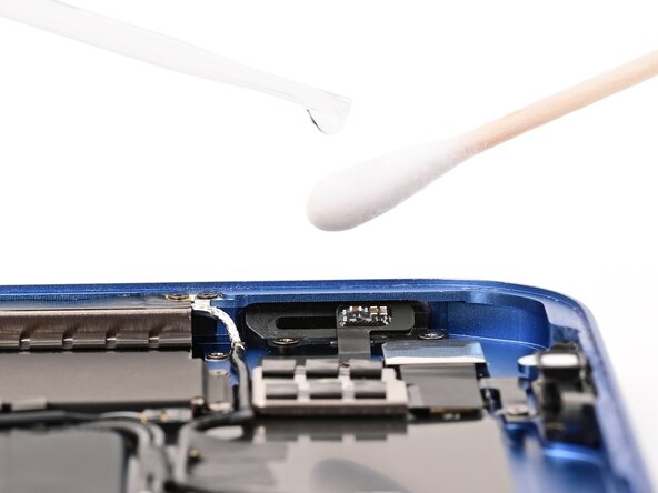

    6. iPad 10 Battery Replacement, Lift the battery cells: step 31, image 1 of 3 iPad 10 Battery Replacement, Lift the battery cells: step 31, image 2 of 3 iPad 10 Battery Replacement, Lift the battery cells: step 31, image 3 of 3
      • Insert a plastic card beneath each battery cell to separate any remaining adhesive securing it.
      • Don't bend or crease the battery. If the battery won't lift, apply a few drops of high-concentration (>90%) isopropyl alcohol or adhesive remover so it runs underneath the stuck section.

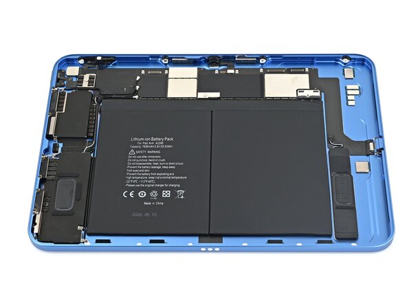

    7. iPad 10 Battery Replacement, Remove the battery: step 32, image 1 of 3 iPad 10 Battery Replacement, Remove the battery: step 32, image 2 of 3 iPad 10 Battery Replacement, Remove the battery: step 32, image 3 of 3
      • Slide the battery away from the logic board to disconnect its connector.
      • If it doesn't slide out easily, "walk" the battery out, first on the left side, then the right, to disconnect it.
      • Remove the battery.

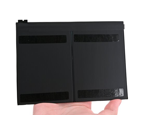

      • Remove any liners on the bottom of the battery to expose the battery adhesive.
      Ask FixBot
    3. iPad 10 Battery Replacement, Install the battery: step 35, image 1 of 3 iPad 10 Battery Replacement, Install the battery: step 35, image 2 of 3 iPad 10 Battery Replacement, Install the battery: step 35, image 3 of 3
      • Slide the battery connector fully into its socket on the board and set the battery in place.
      Ask FixBot
    4. iPad 10 Battery Replacement: step 36, image 1 of 3 iPad 10 Battery Replacement: step 36, image 2 of 3 iPad 10 Battery Replacement: step 36, image 3 of 3
      • Press along the battery to help the battery adhesive bond to the frame of the iPad.

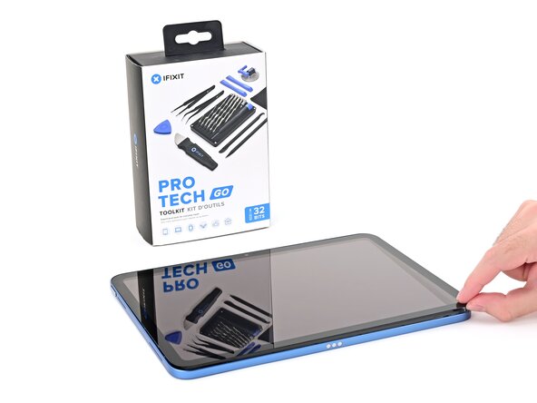

    1. iPad 10 Battery Replacement, Clean the frame adhesive: step 39, image 1 of 2 iPad 10 Battery Replacement, Clean the frame adhesive: step 39, image 2 of 2
      • Don't touch the ambient light sensor or selfie camera along the top edge of the iPad while cleaning the frame.
      • Use a hair dryer or heat gun to heat a roughly 3 inch (~8 cm) section of the frame edge.

      • Apply a bit of isopropyl alcohol to a cotton swab or lint-free cloth and clean the frame until it's free of adhesive residue.
      • Alternatively, use our adhesive cleanup kit.

    9. iPad 10 Battery Replacement, Prop up the digitizer: step 47, image 1 of 1
      • Set the digitizer on the frame of the iPad, so the cables can reach their connectors on the board.
      • Lean the digitizer against a large, sturdy object to keep it upright.

    10. iPad 10 Battery Replacement, Connect the digitizer: step 48, image 1 of 3 iPad 10 Battery Replacement, Connect the digitizer: step 48, image 2 of 3 iPad 10 Battery Replacement, Connect the digitizer: step 48, image 3 of 3
      • Use your finger or the flat end of a spudger to connect the three digitizer press connectors to their respective sockets on the board.

    11. iPad 10 Battery Replacement, Install the digitizer connector covers: step 49, image 1 of 3 iPad 10 Battery Replacement, Install the digitizer connector covers: step 49, image 2 of 3 iPad 10 Battery Replacement, Install the digitizer connector covers: step 49, image 3 of 3
      • Set the two digitizer connector covers over their respective connectors on the board.
      Ask FixBot
    12. iPad 10 Battery Replacement: step 50, image 1 of 1
      • Use a JIS 00 screwdriver to install the four 1.1 mm‑long screws securing the digitizer connector covers.
      Ask FixBot
    13. iPad 10 Battery Replacement, Set the screen into place: step 51, image 1 of 1
      • Don't touch the front of the screen with your fingers. Any oils will be difficult to remove.
      • Set the screen on the iPad, so the screen cable connector can reach its socket on the board.
      Ask FixBot
    14. iPad 10 Battery Replacement, Connect the screen: step 52, image 1 of 3 iPad 10 Battery Replacement, Connect the screen: step 52, image 2 of 3 iPad 10 Battery Replacement, Connect the screen: step 52, image 3 of 3
      • Use your finger to connect the screen connector to its socket on the board.
      • Press the screen cable down so it sits flat onto the board.
      Ask FixBot

    22. iPad 10 Battery Replacement, Install the digitizer: step 60, image 1 of 3 iPad 10 Battery Replacement, Install the digitizer: step 60, image 2 of 3 iPad 10 Battery Replacement, Install the digitizer: step 60, image 3 of 3
      • Lower the digitizer into place.
      • Press along the edges of the digitizer so it sits flush into the iPad frame.

    23. iPad 10 Battery Replacement, Press the screen adhesive: step 61, image 1 of 2 iPad 10 Battery Replacement, Press the screen adhesive: step 61, image 2 of 2
      • In order for the adhesive to bond correctly, you'll need to apply even pressure around the perimeter of the iPad. You can compensate for the camera bump by laying the iPad face-down and placing coins around its perimeter.
      • Alternatively, you can use screen vise clamps around the perimeter of your device to set the new adhesive.
      • Place the iPad screen-side-down on a soft, flat surface.
      • Apply painter's tape to the back to protect its finish.
      Ask FixBot
    24. iPad 10 Battery Replacement: step 62, image 1 of 2 iPad 10 Battery Replacement: step 62, image 2 of 2
      • Place evenly spaced layers of coins or similarly thick objects on the tape along the edges of the back glass.
      • Stack them to a consistent height taller than the camera bump.
      Ask FixBot
    25. iPad 10 Battery Replacement: step 63, image 1 of 1
      • Stack multiple books or other heavy objects on the iPad.
      • The coins may leave an impression on the bottom object, so don't use anything valuable.
      • Leave the objects in place for at least thirty minutes. The lighter the objects, the longer they should be left. Ideally, leave them stacked overnight.
