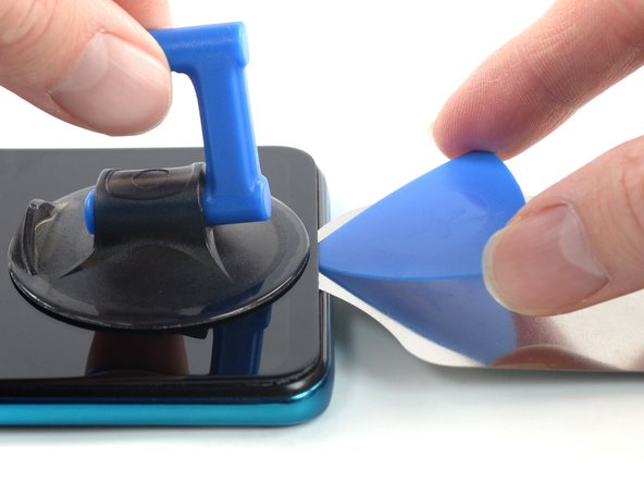

    2. Xiaomi Redmi Note 9S Screen Replacement, Insert an opening pick: step 2, image 1 of 3 Xiaomi Redmi Note 9S Screen Replacement, Insert an opening pick: step 2, image 2 of 3 Xiaomi Redmi Note 9S Screen Replacement, Insert an opening pick: step 2, image 3 of 3
      • Secure a suction handle to the bottom edge of the rear glass, as close to the edge as possible.
      • If the rear glass is cracked, the suction handle may not stick. Try lifting it with strong tape, or superglue the suction handle in place and allow it to cure so you can proceed.
      • Lift the rear glass with the suction handle to create a small gap between the back cover and the frame.
      • In case you have trouble creating a gap, apply more heat to further soften the adhesive. Follow the iOpener instructions to avoid overheating.
      • Insert an opening pick into the gap you created.

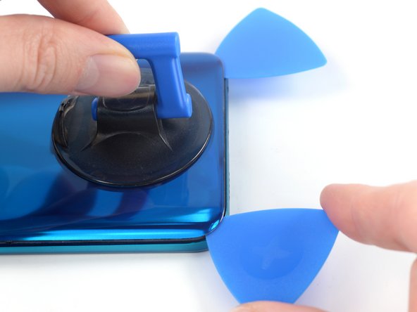

    3. Xiaomi Redmi Note 9S Screen Replacement, Slice the adhesive: step 3, image 1 of 2 Xiaomi Redmi Note 9S Screen Replacement, Slice the adhesive: step 3, image 2 of 2
      • Slide the opening pick to the bottom right corner to slice the adhesive.
      • Leave the opening pick in place to prevent the adhesive from resealing.
      Ask FixBot

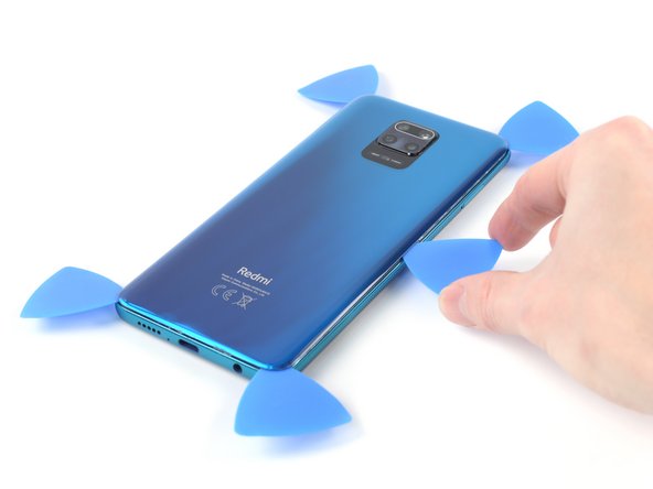

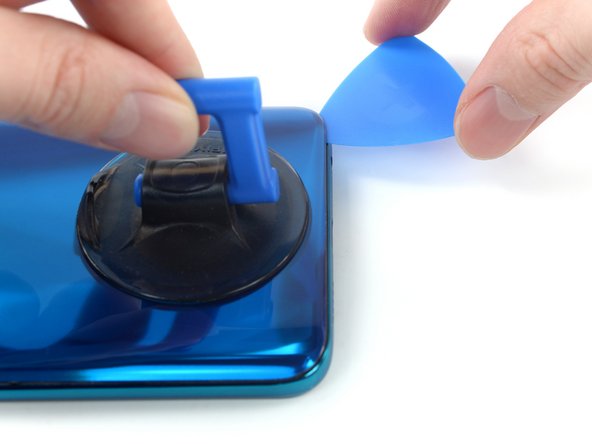

    4. Xiaomi Redmi Note 9S Screen Replacement, Slice the adhesive: step 4, image 1 of 3 Xiaomi Redmi Note 9S Screen Replacement, Slice the adhesive: step 4, image 2 of 3 Xiaomi Redmi Note 9S Screen Replacement, Slice the adhesive: step 4, image 3 of 3
      • Insert a second opening pick at the bottom edge of your phone.
      • Slide the opening pick to the bottom left corner to slice the adhesive.
      • Leave the opening picks in place to prevent the adhesive from resealing.
      Ask FixBot

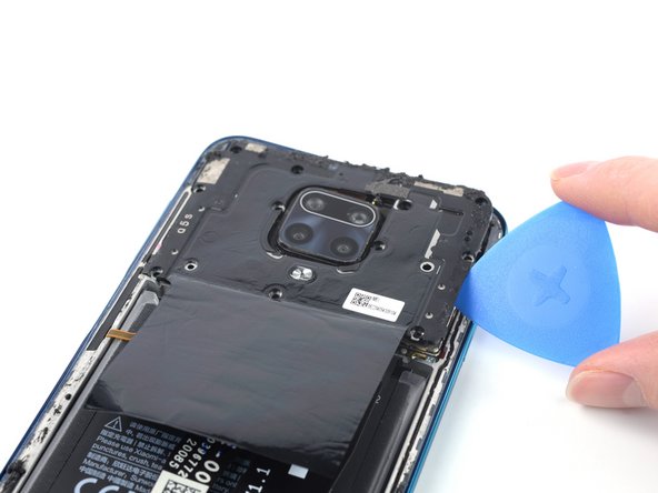

    2. Xiaomi Redmi Note 9S Screen Replacement, Pry up the motherboard cover: step 10, image 1 of 2 Xiaomi Redmi Note 9S Screen Replacement, Pry up the motherboard cover: step 10, image 2 of 2
      • Insert the tip of an opening pick underneath the right edge of the motherboard cover.
      • Twist the opening pick sideways to pry up the motherboard cover.
      Ask FixBot

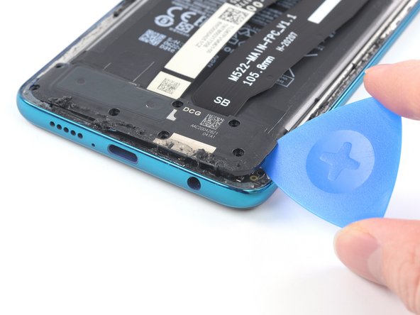

    2. Xiaomi Redmi Note 9S Screen Replacement, Pry up the loudspeaker assembly: step 14, image 1 of 2 Xiaomi Redmi Note 9S Screen Replacement, Pry up the loudspeaker assembly: step 14, image 2 of 2
      • Insert an opening pick into the gap between the right edge of the loudspeaker assembly and the frame.
      • Twist the opening pick sideways to pry up the loudspeaker assembly.
      Ask FixBot

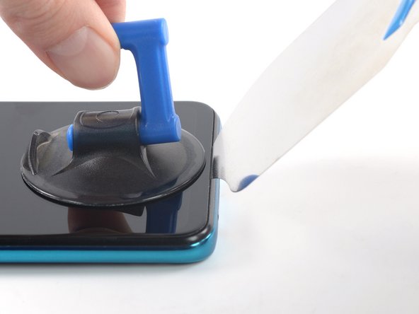

    3. Xiaomi Redmi Note 9S Screen Replacement, Insert an iFlex: step 18, image 1 of 3 Xiaomi Redmi Note 9S Screen Replacement, Insert an iFlex: step 18, image 2 of 3 Xiaomi Redmi Note 9S Screen Replacement, Insert an iFlex: step 18, image 3 of 3
      • Apply a suction handle to the bottom edge of the screen.
      • If your screen is badly cracked, covering it with a layer of clear packing tape may allow the suction cup to adhere. Alternatively, very strong tape may be used instead of the suction handle. If all else fails, you can superglue the suction cup to the screen.
      • Lift the screen with the suction handle to create a small gap between the screen and the frame.
      • Insert an iFlex into the gap between the midframe and the screen.
      • Make sure to insert the iFlex between the frame and the display.
      Ask FixBot

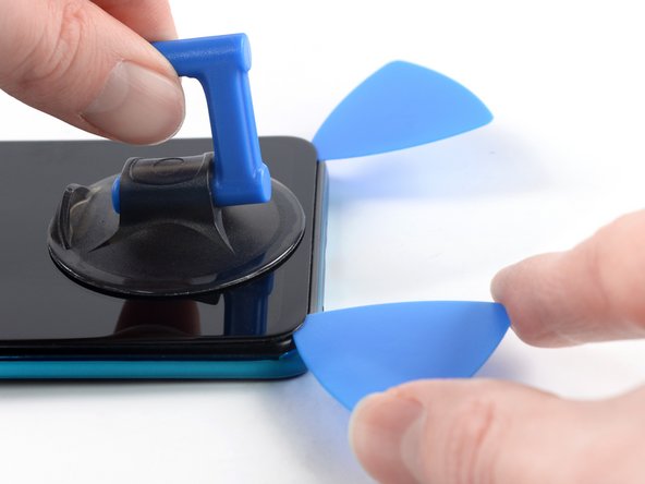

    4. Xiaomi Redmi Note 9S Screen Replacement, Insert an opening pick: step 19, image 1 of 3 Xiaomi Redmi Note 9S Screen Replacement, Insert an opening pick: step 19, image 2 of 3 Xiaomi Redmi Note 9S Screen Replacement, Insert an opening pick: step 19, image 3 of 3
      • Insert an opening pick above the iFlex.
      • Slide the opening pick to the bottom right corner of the screen to slice its adhesive.
      • Remove the iFlex.

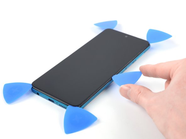

    5. Xiaomi Redmi Note 9S Screen Replacement, Slice the adhesive: step 20, image 1 of 2 Xiaomi Redmi Note 9S Screen Replacement, Slice the adhesive: step 20, image 2 of 2
      • Insert a second opening pick at the bottom edge and slide it to the bottom left corner of the screen to slice the adhesive.
      Ask FixBot

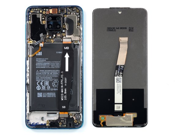

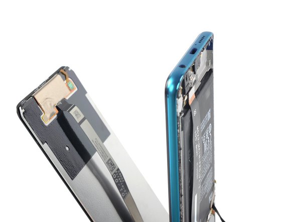

    9. Xiaomi Redmi Note 9S Screen Replacement, Remove the screen: step 24, image 1 of 3 Xiaomi Redmi Note 9S Screen Replacement, Remove the screen: step 24, image 2 of 3 Xiaomi Redmi Note 9S Screen Replacement, Remove the screen: step 24, image 3 of 3
      • Thread the display flex cable through the gap in the midframe and remove the screen.
      • Compare your new replacement part to the original part—you may need to transfer remaining components from your old screen to your replacement part.
      • Apply new adhesive where it's necessary after cleaning the relevant areas with isopropyl alcohol (>90%).
      • During reassembly, follow this guide in case you're using a pre-cut adhesive card.
      Ask FixBot
