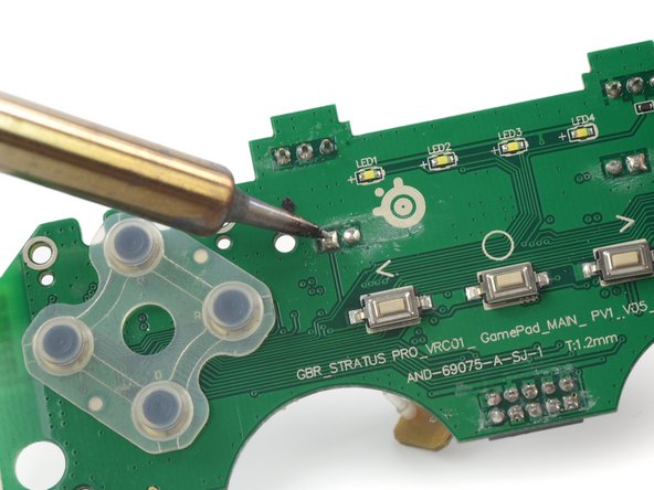

  14. SteelSeries Stratus Duo Mainboard Replacement, Remove the mainboard: step 14, image 1 of 3 SteelSeries Stratus Duo Mainboard Replacement, Remove the mainboard: step 14, image 2 of 3 SteelSeries Stratus Duo Mainboard Replacement, Remove the mainboard: step 14, image 3 of 3
    • You are left with the mainboard.
    • If you replace the mainboard, compare it to the new one. You may need to transfer over some components, e.g., the rubber pads for the D-pad and the action buttons, or even desolder the shoulder button breakout boards.
