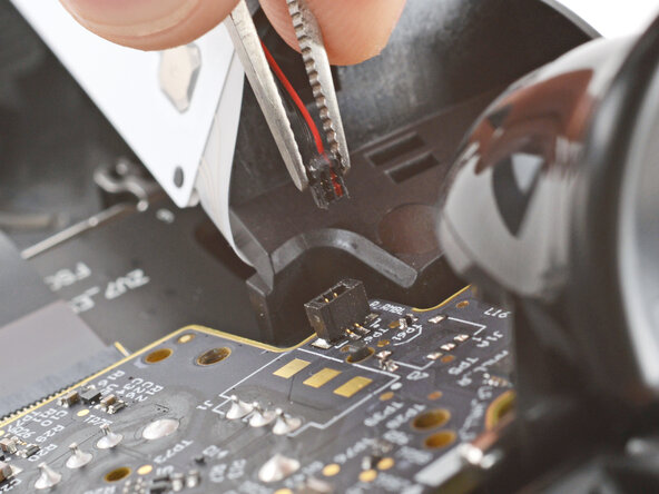

    1. Steam Controller (2nd Gen, 2026) FSC Board Replacement, Disconnect the rumble motors: step 7, image 1 of 3 Steam Controller (2nd Gen, 2026) FSC Board Replacement, Disconnect the rumble motors: step 7, image 2 of 3 Steam Controller (2nd Gen, 2026) FSC Board Replacement, Disconnect the rumble motors: step 7, image 3 of 3
      • Don't pull on the rumble motor's delicate wires—they're easily damaged. Be careful not to pinch the wires with your tweezers, and only pull on the connector itself.
      • Firmly grip the short edges of one rumble motor connector with a pair of tweezers and pull straight up to disconnect it
      • Grip the tweezers as close to the tip as possible to get a better hold on the connector.
      Ask FixBot
    2. Steam Controller (2nd Gen, 2026) FSC Board Replacement: step 8, image 1 of 3 Steam Controller (2nd Gen, 2026) FSC Board Replacement: step 8, image 2 of 3 Steam Controller (2nd Gen, 2026) FSC Board Replacement: step 8, image 3 of 3
      • Repeat to disconnect the other rumble motor.
      Ask FixBot

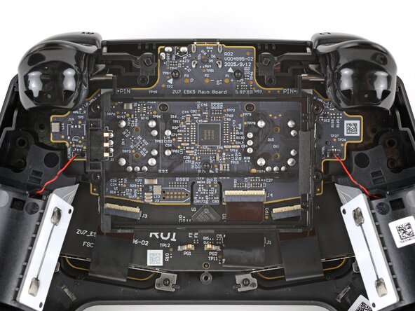

    6. Steam Controller (2nd Gen, 2026) FSC Board Replacement, Remove the main board: step 12, image 1 of 3 Steam Controller (2nd Gen, 2026) FSC Board Replacement, Remove the main board: step 12, image 2 of 3 Steam Controller (2nd Gen, 2026) FSC Board Replacement, Remove the main board: step 12, image 3 of 3
      • Pull the main board down so the top corners clear the triggers.
      • You should be able to remove the board without removing the triggers. If you're having trouble, check out this guide to remove them.
      • Remove the main board, guiding the thumbsticks through their cutouts.
      • During reassembly, make sure the two rumble motor wires don't get trapped underneath the board. Use the four alignment posts to ensure the board is properly positioned.

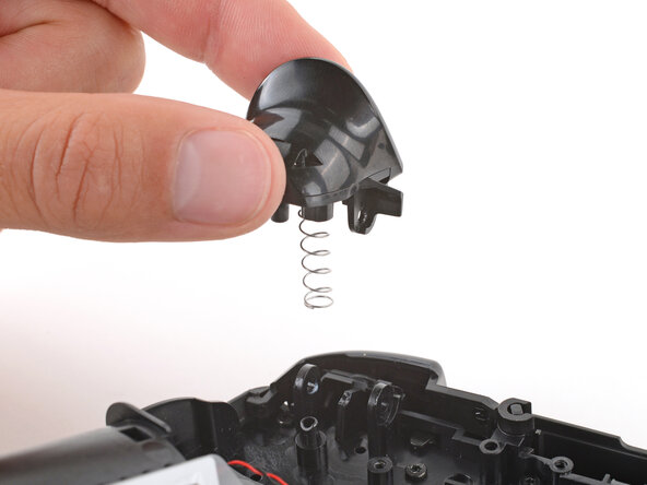

    1. Steam Controller (2nd Gen, 2026) FSC Board Replacement, Remove the hinge pin: step 14, image 1 of 3 Steam Controller (2nd Gen, 2026) FSC Board Replacement, Remove the hinge pin: step 14, image 2 of 3 Steam Controller (2nd Gen, 2026) FSC Board Replacement, Remove the hinge pin: step 14, image 3 of 3
      • With one hand, fully depress one trigger.
      • Don't let go of the trigger, or it will eject and you may lose its spring.
      • With your free hand, use tweezers to pull the hinge pin straight out and remove it.
      • During reassembly, hold the trigger down and slide the pin through both hinge holes—the pin will stop sliding once it's fully inserted. Test the trigger to ensure the pin was properly installed.
      • When correctly inserted, the pin's end will be alinged with the white rectangle on the board (labeled PIN)—there should be no wobble.
      Ask FixBot
    2. Steam Controller (2nd Gen, 2026) FSC Board Replacement, Remove the trigger: step 15, image 1 of 3 Steam Controller (2nd Gen, 2026) FSC Board Replacement, Remove the trigger: step 15, image 2 of 3 Steam Controller (2nd Gen, 2026) FSC Board Replacement, Remove the trigger: step 15, image 3 of 3
      • Lift the trigger straight up and remove it.
      • Remove the spring and store it in a safe place for reassembly.
      • The spring will either stick to the trigger's magnet or stay on its post.

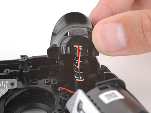

    4. Steam Controller (2nd Gen, 2026) FSC Board Replacement, Reassembly information: step 17, image 1 of 3 Steam Controller (2nd Gen, 2026) FSC Board Replacement, Reassembly information: step 17, image 2 of 3 Steam Controller (2nd Gen, 2026) FSC Board Replacement, Reassembly information: step 17, image 3 of 3
      • During reassembly, follow this step to install the triggers.
      • Place one of the trigger springs over its post on the controller.
      • Put the trigger in place, making sure the spring goes over both of its posts (one on the controller and one on the trigger) and that the hinge holes are all aligned.
      • Hold the trigger down and slide the pin through both hinge holes—the pin will stop sliding once it's fully inserted.
      • If you're having trouble, make sure you're installing the trigger on the correct side.
      • Test the trigger to ensure the pin was properly installed.
      • Repeat to install the other trigger.

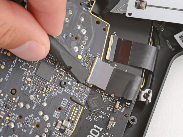

    1. Steam Controller (2nd Gen, 2026) FSC Board Replacement, Disconnect the trackpad cables: step 21, image 1 of 2 Steam Controller (2nd Gen, 2026) FSC Board Replacement, Disconnect the trackpad cables: step 21, image 2 of 2
      • Use the flat end of a spudger to lift the hinged, locking flap on one of the trackpad ZIF connectors.
      Ask FixBot
    2. Steam Controller (2nd Gen, 2026) FSC Board Replacement: step 22, image 1 of 2 Steam Controller (2nd Gen, 2026) FSC Board Replacement: step 22, image 2 of 2
      • Use tweezers to grip the cable by its plastic pull tab and slide it out of the socket.
      Ask FixBot
    3. Steam Controller (2nd Gen, 2026) FSC Board Replacement: step 23, image 1 of 3 Steam Controller (2nd Gen, 2026) FSC Board Replacement: step 23, image 2 of 3 Steam Controller (2nd Gen, 2026) FSC Board Replacement: step 23, image 3 of 3
      • Repeat to disconnect the other trackpad cable.

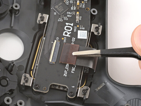

    1. Steam Controller (2nd Gen, 2026) FSC Board Replacement, Transfer the FSC board cable: step 26, image 1 of 3 Steam Controller (2nd Gen, 2026) FSC Board Replacement, Transfer the FSC board cable: step 26, image 2 of 3 Steam Controller (2nd Gen, 2026) FSC Board Replacement, Transfer the FSC board cable: step 26, image 3 of 3
      • If your replacement FSC board doesn't come with a cable, follow this step to transfer it.
      • Use a spudger to lift the hinged locking flap on the center ZIF connector.
      • Be very careful not to damage any of the small, surface-mounted components around the connector.
      • Slide the cable out of the socket and remove it.
