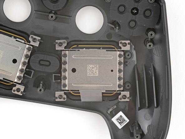

  26. Steam Controller (2nd Gen, 2026) Left Touchpad Replacement, Remove the touchpad screws: step 26, image 1 of 3 Steam Controller (2nd Gen, 2026) Left Touchpad Replacement, Remove the touchpad screws: step 26, image 2 of 3 Steam Controller (2nd Gen, 2026) Left Touchpad Replacement, Remove the touchpad screws: step 26, image 3 of 3
    • The left touchpad will be on your right-hand side, as the shell is upside down.
    • Use a T4 Torx screwdriver to remove the four 6.0 mm‑long screws securing the left touchpad.
    • When reinstalling the screws, raise the controller so the touchpad isn't pressed against your work surface. Don't lift too high, or the buttons may fall out.
  27. Steam Controller (2nd Gen, 2026) Left Touchpad Replacement, Remove the touchpad: step 27, image 1 of 2 Steam Controller (2nd Gen, 2026) Left Touchpad Replacement, Remove the touchpad: step 27, image 2 of 2
    • Remove the touchpad.
    • During reassembly, set the touchpad into its cutout so the cable is on the bottom edge. Make sure all the alignment tabs and posts go through their cutouts by the screw holes.
