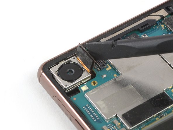

    7. Sony Xperia Z3 Screen Assembly Replacement: step 20, image 1 of 2 Sony Xperia Z3 Screen Assembly Replacement: step 20, image 2 of 2
      • Use a spudger to pry up and disconnect the rear camera flex cable.
      Ask FixBot
    8. Sony Xperia Z3 Screen Assembly Replacement: step 21, image 1 of 2 Sony Xperia Z3 Screen Assembly Replacement: step 21, image 2 of 2
      • Use a pair of tweezers to lift the rear camera out of its recess and remove it.
