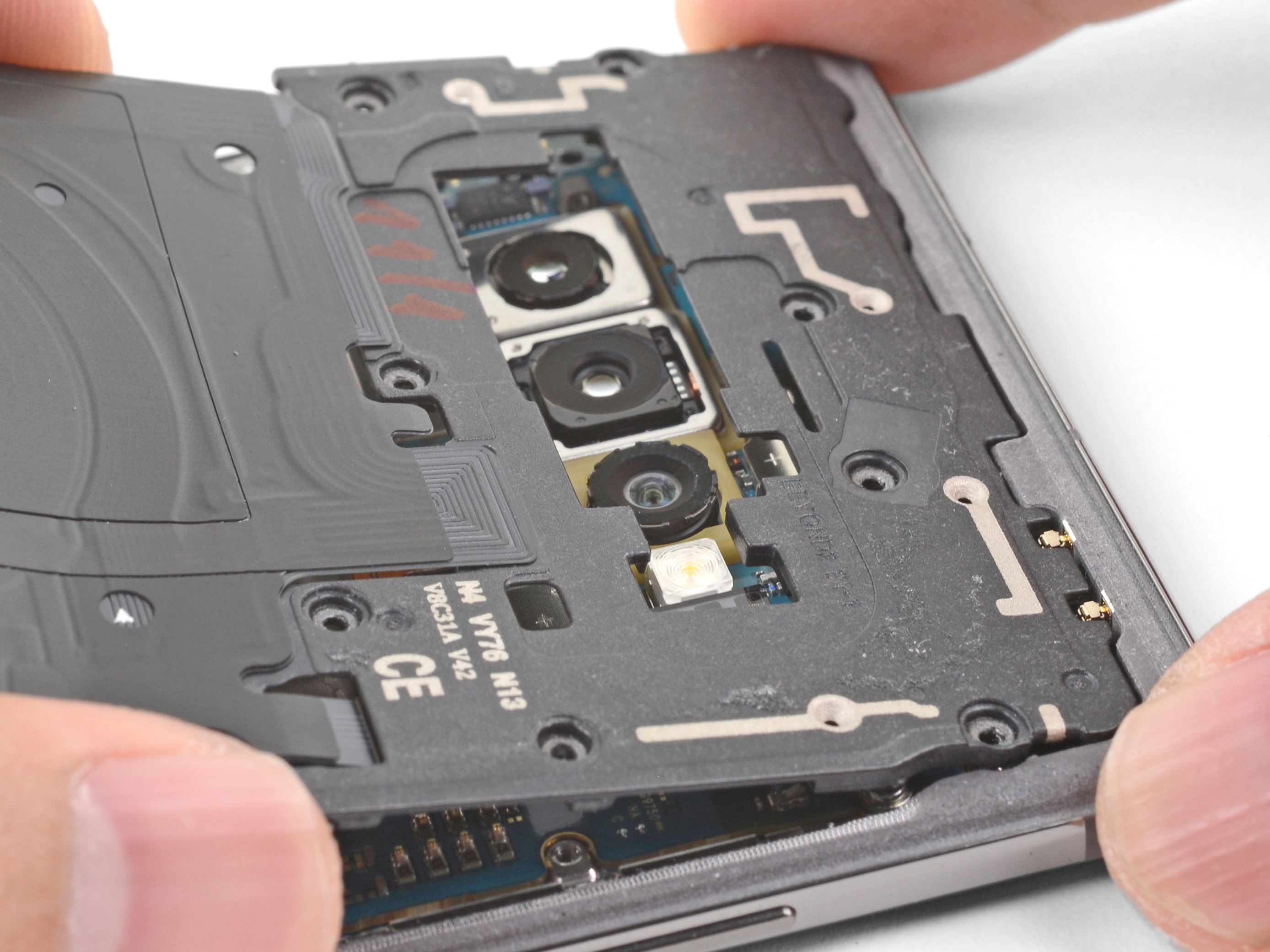

    1. Samsung Galaxy S10+ Front-Facing Camera Module Replacement, Remove the midframe: step 9, image 1 of 1
      • Remove the nine 4 mm Phillips screws securing the top midframe to the phone.
      Ask FixBot
    2. Samsung Galaxy S10+ Front-Facing Camera Module Replacement: step 10, image 1 of 2 Samsung Galaxy S10+ Front-Facing Camera Module Replacement: step 10, image 2 of 2
      • The midframe is still held in place by a few plastic clips around the edge.
      • Insert the point of a spudger into the notch on the right edge of the midframe, near the Bixby button.
      • Pry up to loosen the midframe from the phone.
      Ask FixBot
    3. Samsung Galaxy S10+ Front-Facing Camera Module Replacement: step 11, image 1 of 2 Samsung Galaxy S10+ Front-Facing Camera Module Replacement: step 11, image 2 of 2
      • Insert the point of a spudger into the notch on the left edge of the phone, located near the power button.
      Ask FixBot
