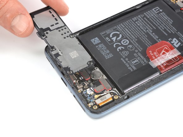

    1. OnePlus Nord Screen Replacement, Remove the motherboard cover: step 9, image 1 of 1
      • Use a Phillips #00 screwdriver to remove the ten 3.6 mm-long screws from the motherboard cover.
      Ask FixBot
    2. OnePlus Nord Screen Replacement: step 10, image 1 of 3 OnePlus Nord Screen Replacement: step 10, image 2 of 3 OnePlus Nord Screen Replacement: step 10, image 3 of 3
      • Insert the tip of an opening pick under the motherboard cover.
      • Use the opening pick to lift the motherboard cover up and release the plastic clips that holds the cover in its place.
      • Remove the motherboard cover.

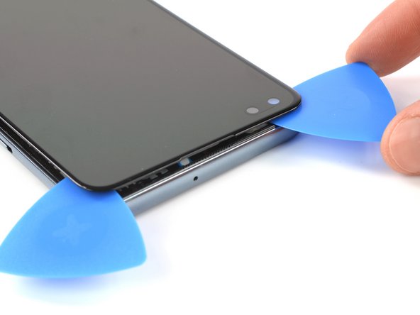

    6. OnePlus Nord Screen Replacement, Slice the adhesive: step 17, image 1 of 3 OnePlus Nord Screen Replacement, Slice the adhesive: step 17, image 2 of 3 OnePlus Nord Screen Replacement, Slice the adhesive: step 17, image 3 of 3
      • Insert a second opening pick at the bottom right corner.
      • Slide the opening pick along the edge to the top right corner of your phone.
      • Leave both opening picks in their place to prevent the adhesive from resealing.

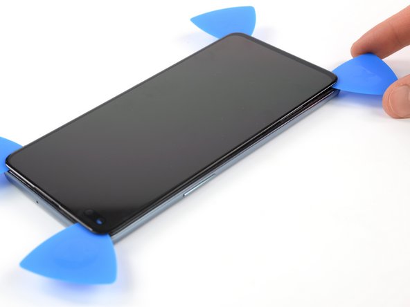

    8. OnePlus Nord Screen Replacement: step 19, image 1 of 3 OnePlus Nord Screen Replacement: step 19, image 2 of 3 OnePlus Nord Screen Replacement: step 19, image 3 of 3
      • Insert a fourth opening pick under the top left corner.
      • Slide the opening pick along the edge to cut the adhesive.
      • Leave the opening pick in the bottom left corner so prevent the adhesive from resealing.
