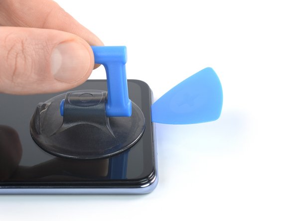

    3. OnePlus Nord 2 5G Screen Replacement, Insert an iFlex: step 31, image 1 of 3 OnePlus Nord 2 5G Screen Replacement, Insert an iFlex: step 31, image 2 of 3 OnePlus Nord 2 5G Screen Replacement, Insert an iFlex: step 31, image 3 of 3
      • Apply a suction handle to the bottom edge of the screen.
      • If your display is badly cracked, covering it with a layer of clear packing tape may allow the suction cup to adhere. Alternatively, very strong tape may be used instead of the suction cup. If all else fails, you can superglue the suction cup to the broken screen.
      • Lift the screen with the suction handle and insert an iFlex to create a small gap between the screen and the phone assembly.
      • Depending on the age of your phone, this may be difficult. If you're having trouble, apply more heat to the bottom edge and try again.
      Ask FixBot
    4. OnePlus Nord 2 5G Screen Replacement, Insert an opening pick: step 32, image 1 of 2 OnePlus Nord 2 5G Screen Replacement, Insert an opening pick: step 32, image 2 of 2
      • Insert an opening pick into the gap you created with your iFlex.
      • Remove the iFlex.
      Ask FixBot
