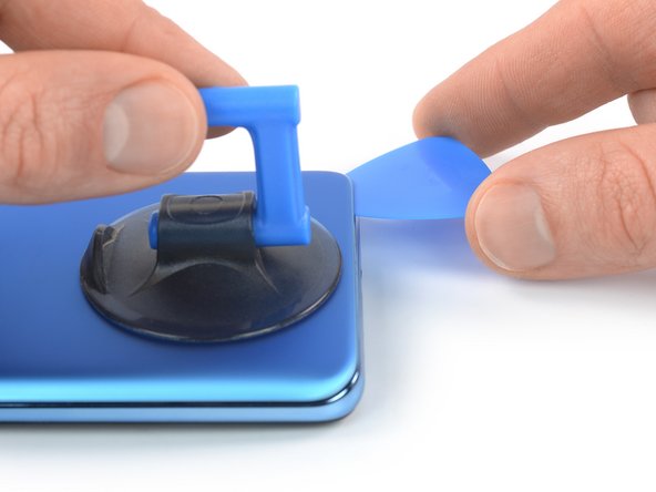

    2. OnePlus 9 5G Screen Replacement, Insert an opening pick: step 4, image 1 of 3 OnePlus 9 5G Screen Replacement, Insert an opening pick: step 4, image 2 of 3 OnePlus 9 5G Screen Replacement, Insert an opening pick: step 4, image 3 of 3
      • Apply a suction handle to the rear glass, as close to the bottom edge as possible.
      • If your rear glass is badly cracked, covering it with a layer of clear packing tape may allow the suction handle to adhere. Alternatively, very strong tape may be used instead of the suction handle. If all else fails, you can superglue the suction handle to the broken rear glass.
      • Pull up on the suction handle with strong, steady force to create a gap between the glass and the frame.
      • If you have trouble creating a gap, apply more heat to further soften the adhesive.
      • Insert an opening pick into the gap.

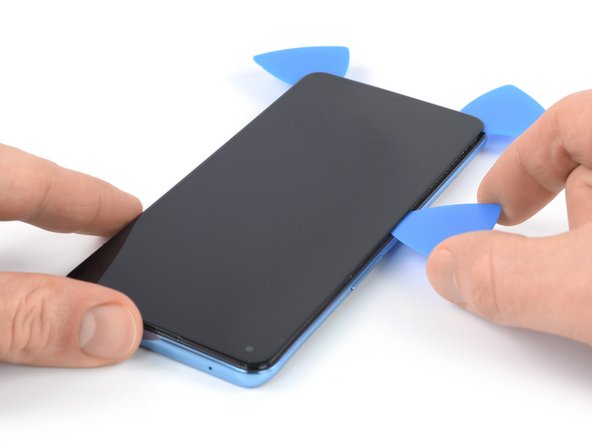

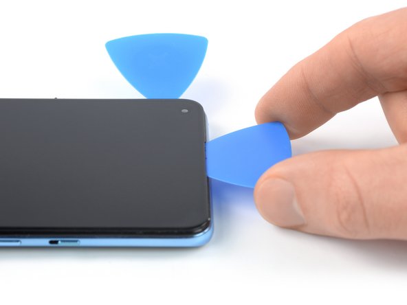

    4. OnePlus 9 5G Screen Replacement, Insert a second opening pick: step 6, image 1 of 2 OnePlus 9 5G Screen Replacement, Insert a second opening pick: step 6, image 2 of 2
      • Insert a second opening pick underneath the bottom edge of the rear glass.
      • Slide the opening pick to the bottom left corner to slice the adhesive.
      • Leave the opening picks in place to prevent the adhesive from resealing.
      Ask FixBot

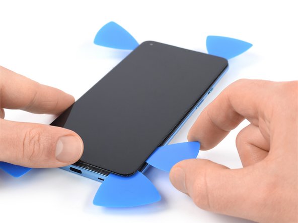

    6. OnePlus 9 5G Screen Replacement, Slice the top edge adhesive: step 8, image 1 of 2 OnePlus 9 5G Screen Replacement, Slice the top edge adhesive: step 8, image 2 of 2
      • Insert a fourth opening pick underneath the top left corner of the rear glass.
      • Slide the opening pick along the top edge to slice the adhesive.
      • Leave the opening pick in the top right corner to prevent the adhesive from resealing.

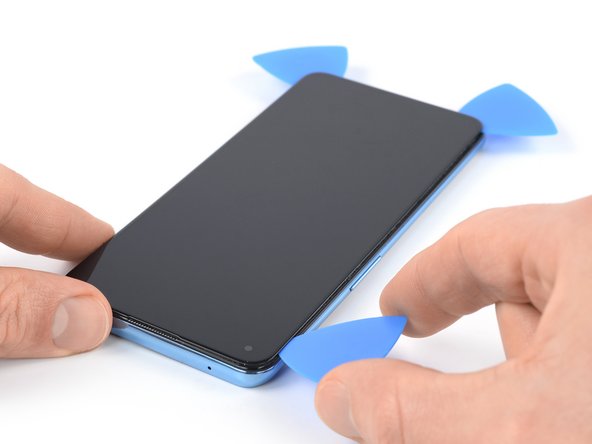

    7. OnePlus 9 5G Screen Replacement, Slice the right edge adhesive: step 9, image 1 of 2 OnePlus 9 5G Screen Replacement, Slice the right edge adhesive: step 9, image 2 of 2
      • Insert a fifth and final opening pick underneath the top right corner of the rear glass.
      • Slide the opening pick along the right edge of the back cover to slice the remaining adhesive.

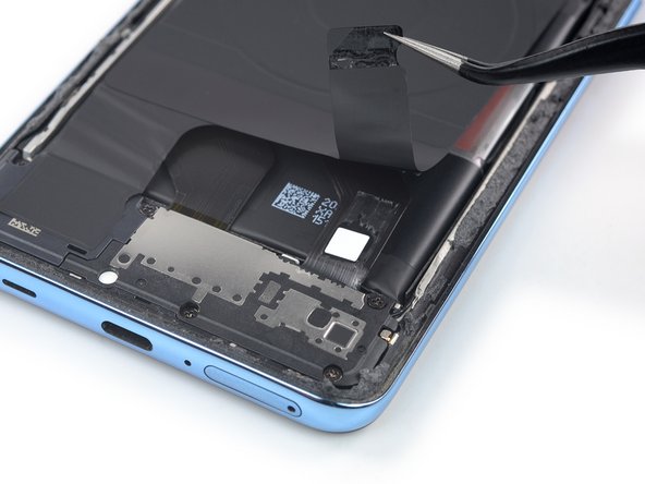

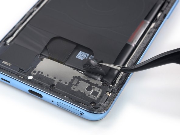

    1. OnePlus 9 5G Screen Replacement, Peel off the tape: step 11, image 1 of 3 OnePlus 9 5G Screen Replacement, Peel off the tape: step 11, image 2 of 3 OnePlus 9 5G Screen Replacement, Peel off the tape: step 11, image 3 of 3
      Tool used on this step:
      Buy

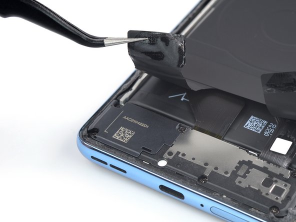

      • Use a pair of tweezers to carefully peel the bottom right corner of the charging coil tape off of the daughterboard cover.
      Ask FixBot
    2. OnePlus 9 5G Screen Replacement: step 12, image 1 of 2 OnePlus 9 5G Screen Replacement: step 12, image 2 of 2
      • Use a pair of tweezers to carefully peel the bottom left corner of the charging coil tape off of the loudspeaker.
      Ask FixBot

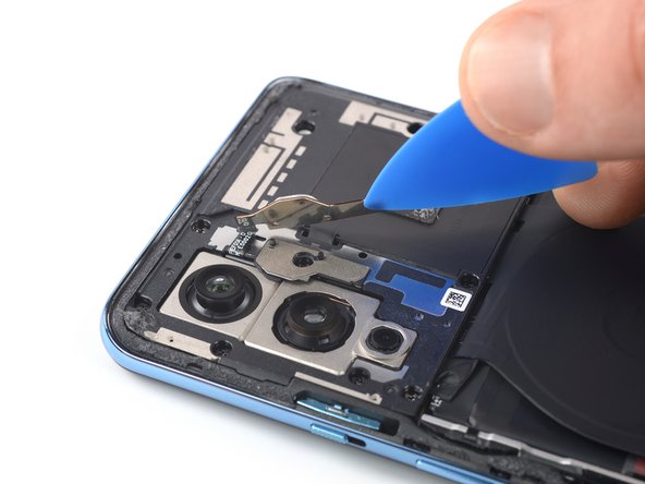

    3. OnePlus 9 5G Screen Replacement, Pry up the flash assembly: step 13, image 1 of 2 OnePlus 9 5G Screen Replacement, Pry up the flash assembly: step 13, image 2 of 2
      • The flash assembly is held in place by mild adhesive and covers a motherboard cover screw.
      • Carefully slide an opening pick underneath the bottom edge of the flash assembly.
      • Use your opening pick to pry up the flash assembly.
      • Don't try to remove the flash assembly all the way during this procedure. Its cable is adhered to the backside of the motherboard cover.

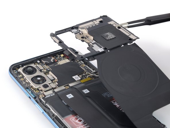

    7. OnePlus 9 5G Screen Replacement, Remove the motherboard cover: step 17, image 1 of 2 OnePlus 9 5G Screen Replacement, Remove the motherboard cover: step 17, image 2 of 2
      • Use a pair of tweezers or your fingers to remove the motherboard cover.
      • The charging coil is attached to the motherboard cover and will lift up at the same time.

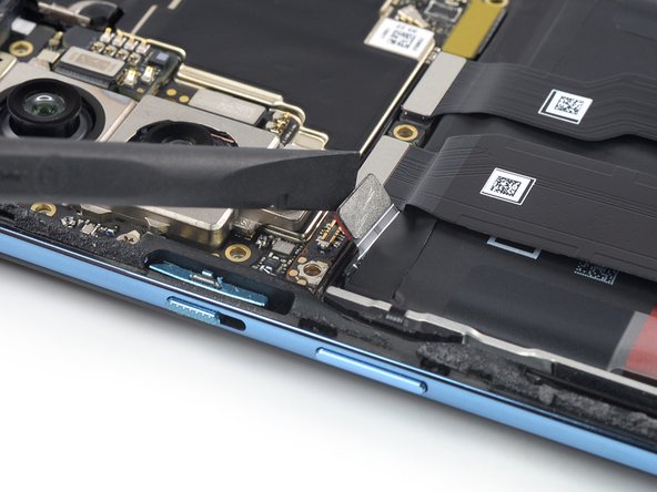

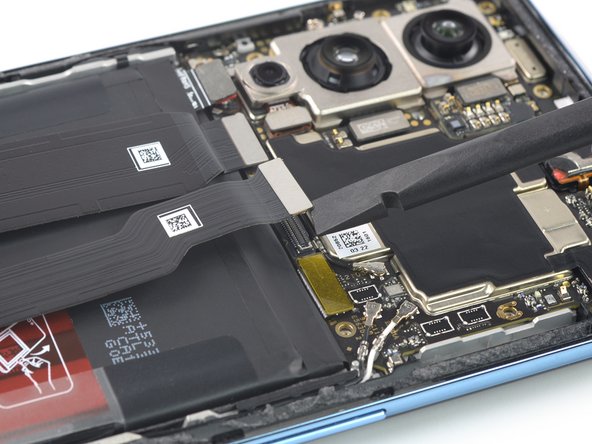

    8. OnePlus 9 5G Screen Replacement, Disconnect the battery cable: step 18, image 1 of 2 OnePlus 9 5G Screen Replacement, Disconnect the battery cable: step 18, image 2 of 2
      • Use a spudger to disconnect the battery cable by prying the connector straight up from its socket on the bottom left corner of the motherboard.
      • To re-attach press connectors like this one, carefully align and press down on one side until it clicks into place, then repeat on the other side. Do not press down on the middle. If the connector is misaligned, the pins can bend and cause permanent damage.

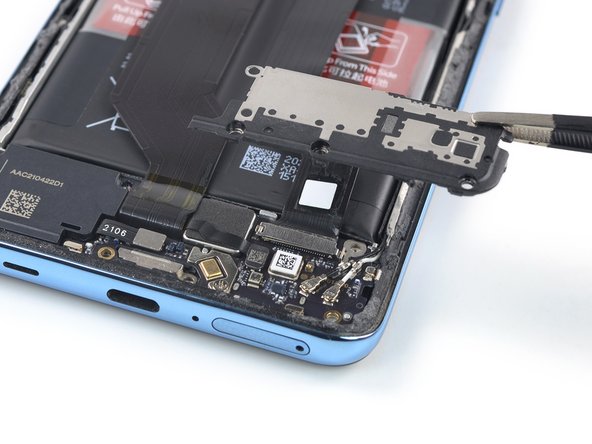

    5. OnePlus 9 5G Screen Replacement, Remove the metal bracket: step 23, image 1 of 3 OnePlus 9 5G Screen Replacement, Remove the metal bracket: step 23, image 2 of 3 OnePlus 9 5G Screen Replacement, Remove the metal bracket: step 23, image 3 of 3
      • Slide one arm of a pair of tweezers underneath the metal bracket covering the interconnect cable.
      • Use your tweezers to lift and unhinge the metal bracket.
      • Remove the metal bracket.

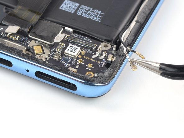

    2. OnePlus 9 5G Screen Replacement, Disconnect the black coaxial cable: step 27, image 1 of 3 OnePlus 9 5G Screen Replacement, Disconnect the black coaxial cable: step 27, image 2 of 3 OnePlus 9 5G Screen Replacement, Disconnect the black coaxial cable: step 27, image 3 of 3
      Buy
      • Slide one arm of a pair of tweezers under the black antenna cable until it‘s snug against the metal connector.
      • Disconnect the antenna cable by prying the connector straight up from the daughterboard.

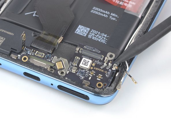

    5. OnePlus 9 5G Screen Replacement, Pry up the daughterboard: step 30, image 1 of 2 OnePlus 9 5G Screen Replacement, Pry up the daughterboard: step 30, image 2 of 2
      • Insert the point of a spudger underneath the top right corner of the daughterboard.
      • Pry upwards to loosen the daughterboard.
      Ask FixBot

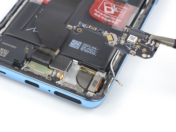

    6. OnePlus 9 5G Screen Replacement, Remove the daughterboard: step 31, image 1 of 2 OnePlus 9 5G Screen Replacement, Remove the daughterboard: step 31, image 2 of 2
      • Use a pair of blunt nose tweezers or your fingers to remove the daughterboard.
      • Before reinserting the daughterboard, make sure all cables that connect to it are out of the way.

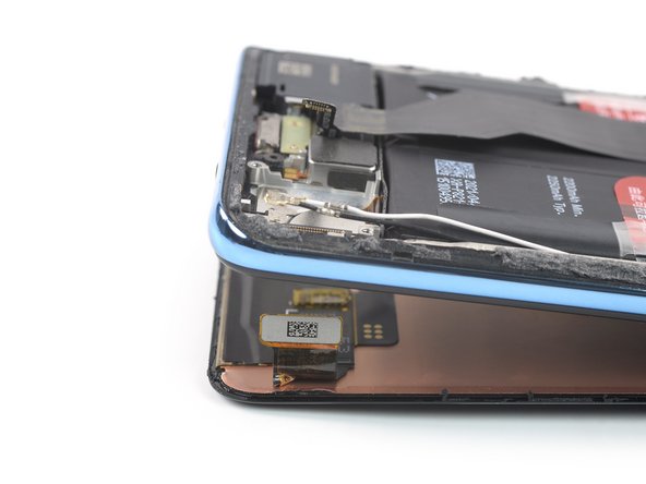

    1. OnePlus 9 5G Screen Replacement, Disconnect the display: step 32, image 1 of 2 OnePlus 9 5G Screen Replacement, Disconnect the display: step 32, image 2 of 2
      • Use a spudger to disconnect the display cable by prying the connector straight up from its socket on the bottom right corner.

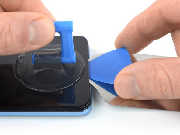

    2. OnePlus 9 5G Screen Replacement, Loosen the display adhesive: step 33, image 1 of 1
      • Apply a heated iOpener to the screen for 3 minutes to loosen the adhesive underneath.
      • A hair dryer, heat gun, or hot plate may also be used, but be careful not to overheat the device. The edge should feel slightly too hot to touch.
      Ask FixBot

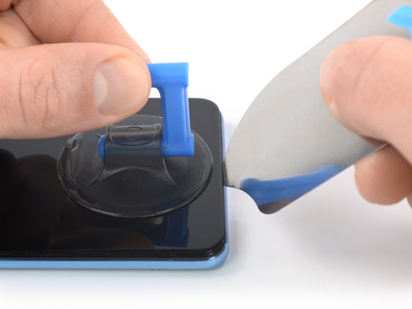

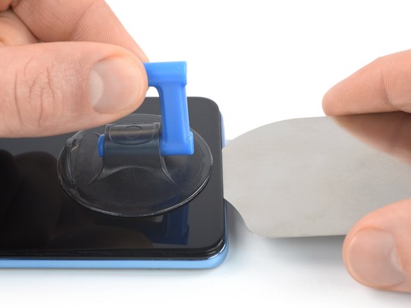

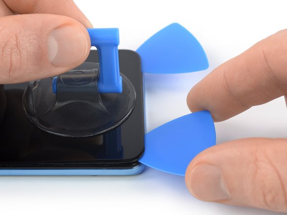

    3. OnePlus 9 5G Screen Replacement, Insert an iFlex: step 34, image 1 of 3 OnePlus 9 5G Screen Replacement, Insert an iFlex: step 34, image 2 of 3 OnePlus 9 5G Screen Replacement, Insert an iFlex: step 34, image 3 of 3
      • Apply a suction handle to the bottom edge of the screen.
      • If your display is badly cracked, covering it with a layer of clear packing tape may allow the suction cup to adhere. Alternatively, very strong tape may be used instead of the suction cup. If all else fails, you can superglue the suction cup to the broken screen.
      • Pull up on the suction handle with strong, steady force and insert an iFlex between the screen and frame.
      • Make sure to insert the iFlex underneath the screen and not the plastic frame.
      • Depending on the age of your phone, this may be difficult. If you're having trouble, apply more heat to the bottom edge and try again.

    4. OnePlus 9 5G Screen Replacement, Insert an opening pick: step 35, image 1 of 2 OnePlus 9 5G Screen Replacement, Insert an opening pick: step 35, image 2 of 2
      • Insert an opening pick between the iFlex and the screen.
      • Remove the iFlex.
      Ask FixBot
    5. OnePlus 9 5G Screen Replacement, Slice the bottom edge adhesive: step 36, image 1 of 2 OnePlus 9 5G Screen Replacement, Slice the bottom edge adhesive: step 36, image 2 of 2
      • Slide the opening pick to the bottom right corner of the screen to slice its adhesive.
      • Leave the opening pick in place to prevent the adhesive from resealing.
      Ask FixBot
    6. OnePlus 9 5G Screen Replacement: step 37, image 1 of 2 OnePlus 9 5G Screen Replacement: step 37, image 2 of 2
      • Insert a second opening pick at the bottom right corner and slide it to the bottom left corner of the screen to slice the adhesive.
      Ask FixBot
    7. OnePlus 9 5G Screen Replacement, Slice the left edge adhesive: step 38, image 1 of 3 OnePlus 9 5G Screen Replacement, Slice the left edge adhesive: step 38, image 2 of 3 OnePlus 9 5G Screen Replacement, Slice the left edge adhesive: step 38, image 3 of 3
      • Insert a third opening pick underneath the bottom left corner of the screen.
      • Slide the opening pick along the left edge of the screen to slice the adhesive.
      • When slicing near the front facing camera, only insert the opening pick 2.5 mm to avoid damaging it.
      • Leave the opening pick in the top left corner to prevent the adhesive from resealing.
      Ask FixBot
    8. OnePlus 9 5G Screen Replacement, Slice the top edge adhesive: step 39, image 1 of 3 OnePlus 9 5G Screen Replacement, Slice the top edge adhesive: step 39, image 2 of 3 OnePlus 9 5G Screen Replacement, Slice the top edge adhesive: step 39, image 3 of 3
      • If the adhesive becomes hard to cut, it has most likely cooled down. Use your iOpener or heat gun for 1–2 minutes to reheat it.
      • Insert a fourth opening pick at the top left corner of the screen.
      • Slide the opening pick along the top edge of the phone to slice the adhesive.
      Ask FixBot
    9. OnePlus 9 5G Screen Replacement, Slice the right edge adhesive: step 40, image 1 of 2 OnePlus 9 5G Screen Replacement, Slice the right edge adhesive: step 40, image 2 of 2
      • Insert a fifth opening pick underneath the top right corner of the screen and slide it along the right edge of the phone to slice the remaining adhesive.
      • Don't try to remove the display all the way yet, the display cable is still threaded through the midframe.
      Ask FixBot
    10. OnePlus 9 5G Screen Replacement, Free the display cable: step 41, image 1 of 2 OnePlus 9 5G Screen Replacement, Free the display cable: step 41, image 2 of 2
      • Flip the phone over.
      • Lift the bottom edge of the phone and carefully thread the display cable through its gap in the frame.
      Ask FixBot
    11. OnePlus 9 5G Screen Replacement, Remove the screen: step 42, image 1 of 1
      • Remove the screen.
