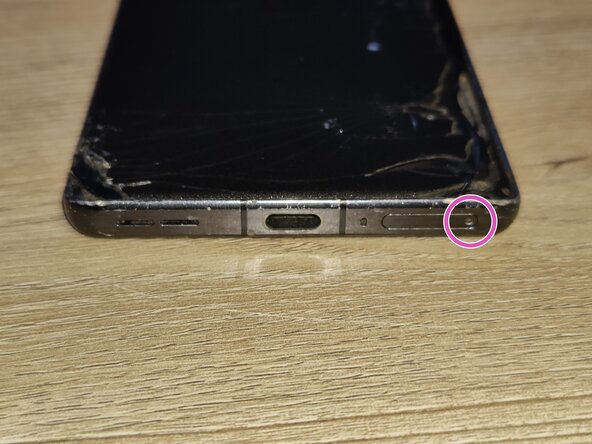

      • Pop open the SIM card tray by inserting a SIM card removal tool into the SIM card tray on the bottom of the phone.
      • Remove the SIM card tray from the phone and set it aside for when we are done.

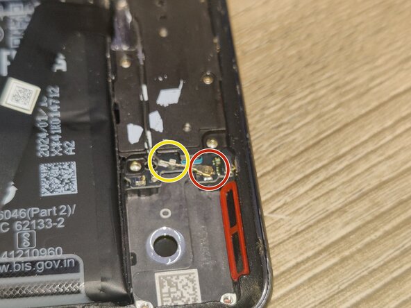

      • Disconnect the coaxial connector carefully.
      • Gently release the wire from the cable guide by pulling it up and out. It has some retaining force but there is no clip or latch.
      • Insert your Jimmy on the other side of the bottom plastic between the frame and the plastic, then gently pry up to pop out the plastic just like the speaker.
      • This bottom plastic is tethered to the rest of the phone via a thin cable, avoid excessive force while prying to prevent damage to the cable.
      • Undo the press connector for the communication flex cable.

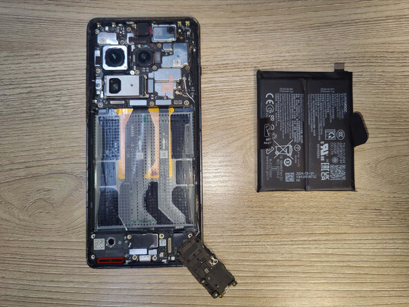

      • Use your fingernail to get the battery pull tabs unstuck
      • Grab ahold of one battery pull tab with one hand and stabilize the phone with the other. I like to hold the phone by the frame with the other hand. You can then start pulling the pull tab directly away from the phone - don't pull it to the side.
      • Each pull tab will unstick one side of the battery. Because of the battery's dual cell design, you cannot wrench away at just one side to get the whole thing out. Alternate pull tabs to unstick both sides of the battery.
      • The pull tabs are attached to the battery and the adhesive should stay behind in the phone's frame. It will be sticky enough to safely hold the new battery in place.
      • Do not re-use the battery you just removed. It has probably gotten slightly bent during the removal process and should be disposed of safely.
